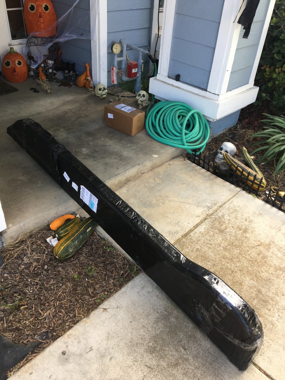

    Thanks @traxman25 for the fast service, now it’s my turn to get to work.

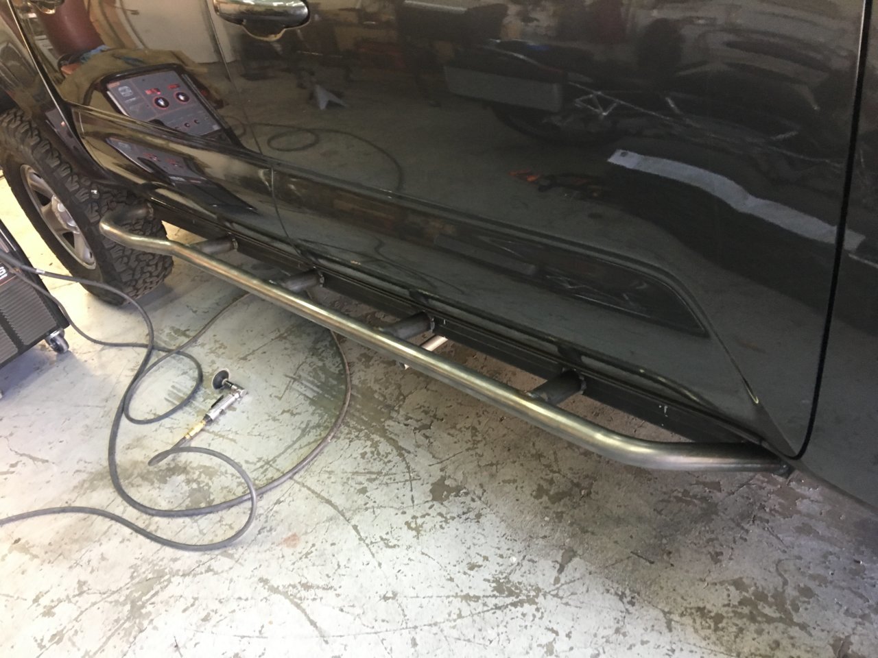

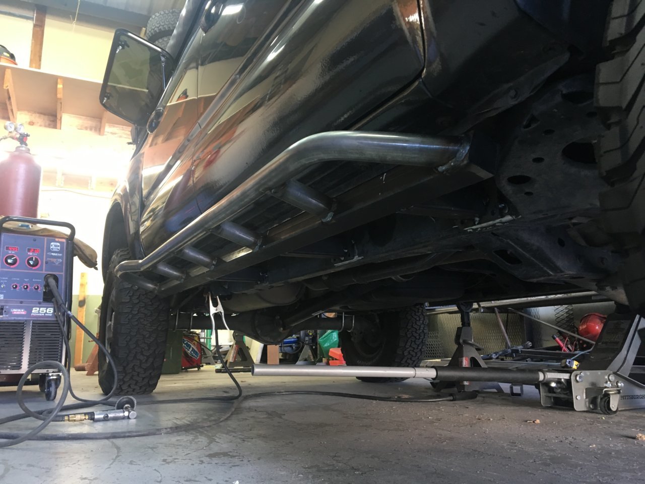

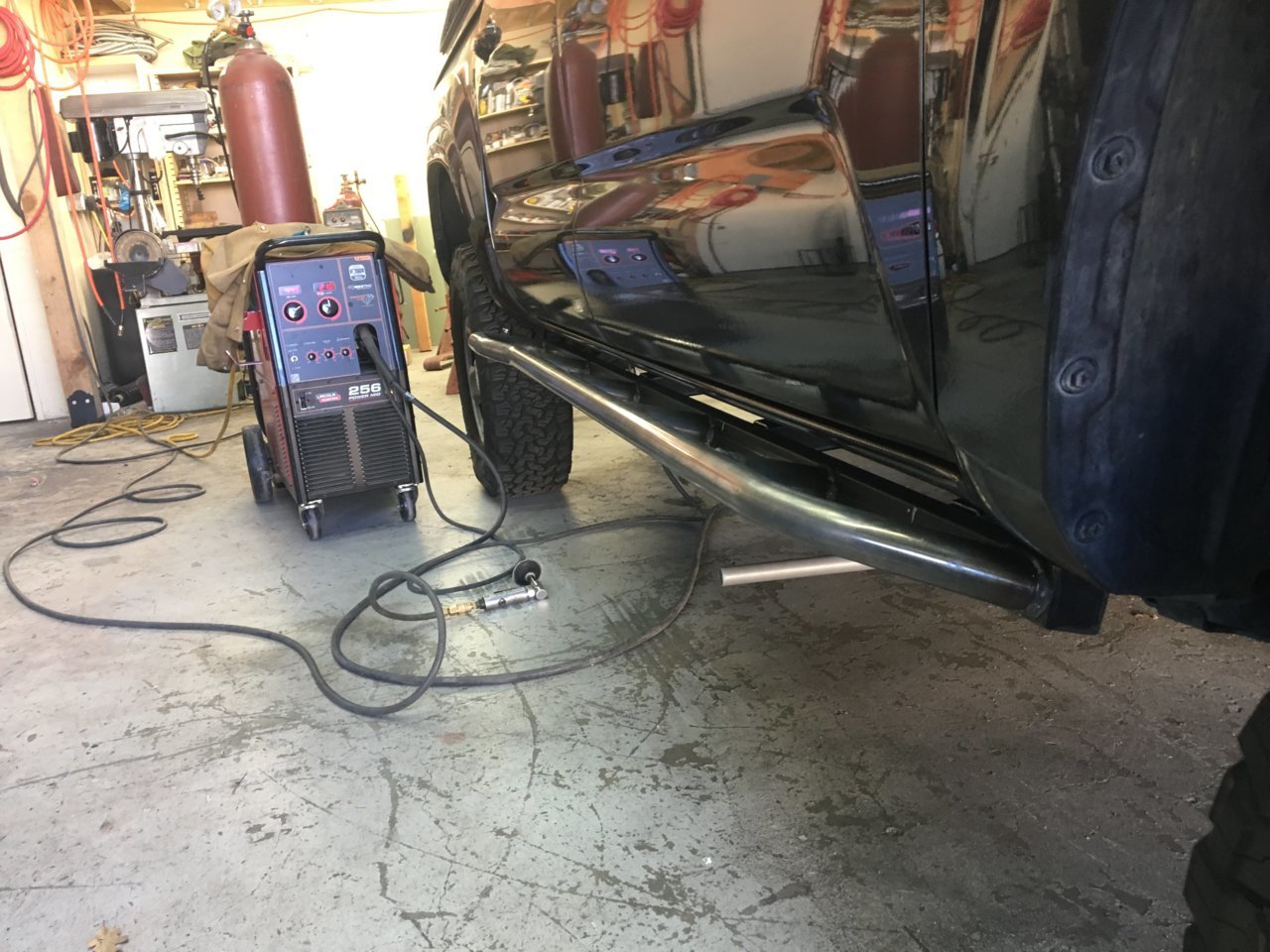

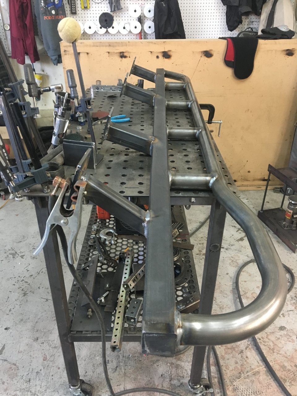

    I finally got the time to weld up rock sliders. The family and I have been sick for a week!
    I tack welded base plates to the frame. I tried 4 different kinds of clamps and none would work.
    On each side I trimmed one leg and extended one. They look good. Time for paint and then weld them to the frame.
    Thanks 4xInovation.

    Why did you have to change the leg lengths? Just curious because we ship ours with the mounts already welded to the legs. I wouldn’t expect the leg lengths to need to be changed unless a customer asked for something custom.
  18. Oct 21, 2018 at 9:24 AM
    #98
    PB FAB
    PB FAB Well-Known Member
    Apr 11, 2017
    #215942
    805
    2017 SR DCSB 4x4 v6
    Most likely it’s due to the location I placed the mounts at and the position I located the slider.

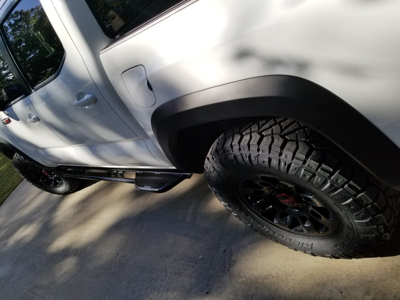

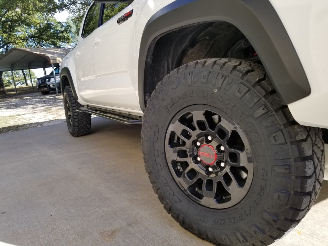

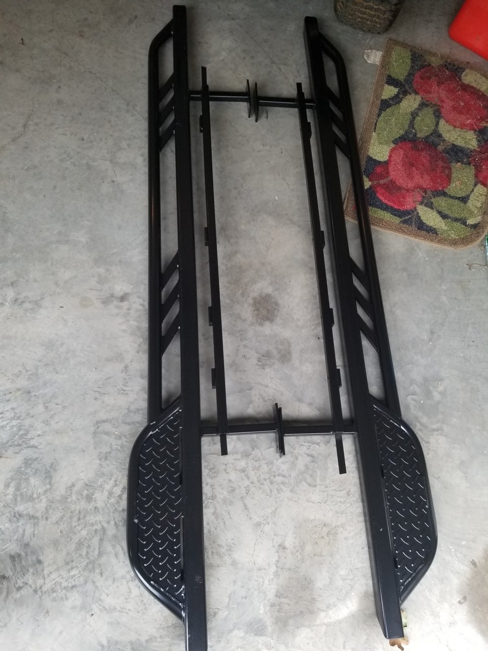

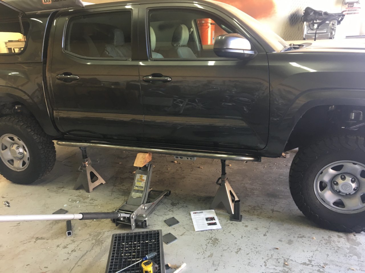

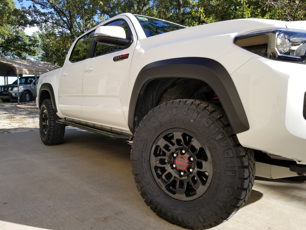

    If anyone is interested here are the Rocky Road Outfitters Super Sliders. They bolt to the frame in two places and a pinch weld seam in four places. Was kind of a hassle to drill the frame because of how high they sit. They were a little over $700 shipped. I won't do a lot of offloading so I am happy with the looks and price.20181016_121732.jpg 20181021_161301.jpg 20181021_161111.jpg 20181021_161132.jpg
