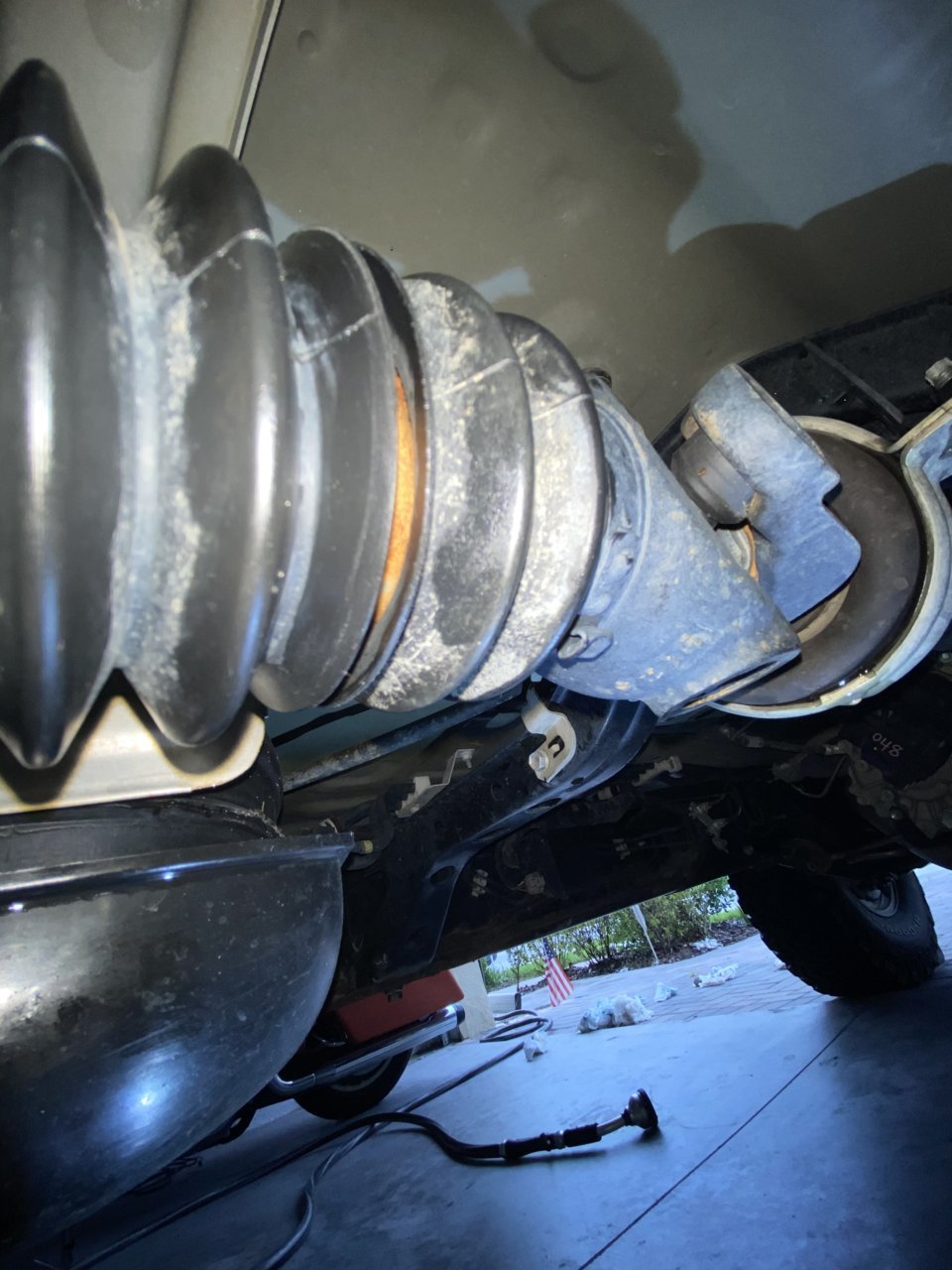

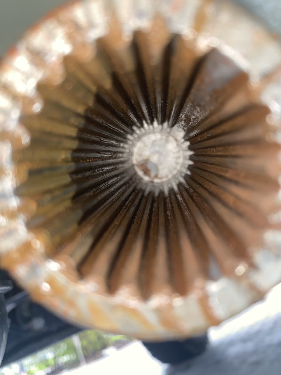

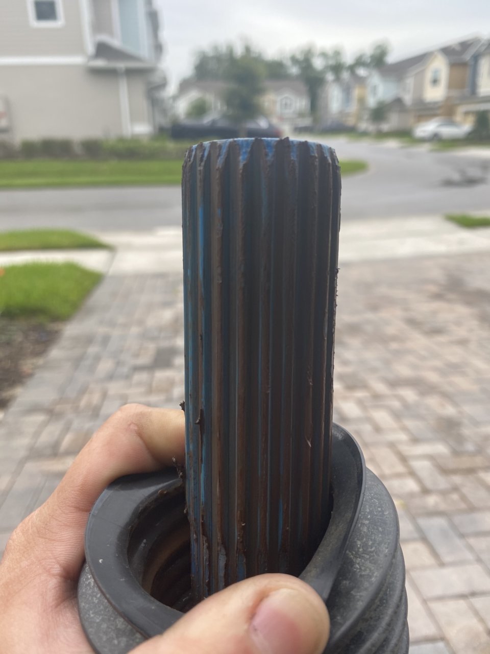

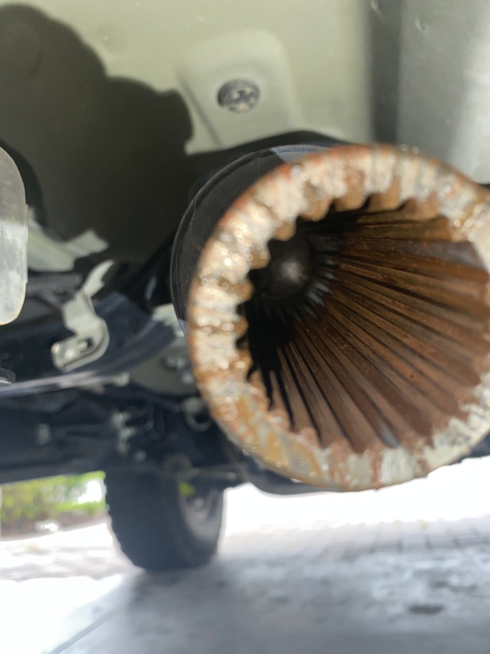

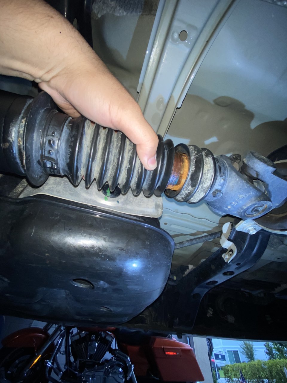

    2019 tacoma trd offroad
    So I did some research and took a look at the driveline today. I do not have any zirk fittings on my u joints towards the back, I have a 2019 trd off-road. On one of the videos I watched the guy did say some models don’t have zirk fittings and that he wasn’t sure, turns out he may be right. So then I went onto removing the driveshaft and come to find most of my grease was gone and brown from water at the slip yoke. I did notice that my boot was in two pieces and at first thought it was normal cause it’s looked factory but then realized that it’s a boot and should be sealed. Any how I cleaned and re-greased the slip yoke and put everything back together and went for a test drive, and that seems to have fixed my issue. I’ll just drive it till it start doing it again and buy a replacement boot when I have to re-grease it again later down the road. Thanks to all that commented and lead me down the right path!
