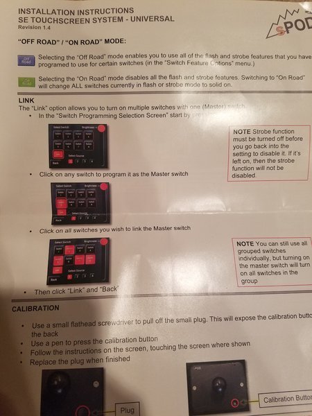

    1482191741226-11789298.jpg yea you do what your talking about with the link option. I haven't linked any lights yet.

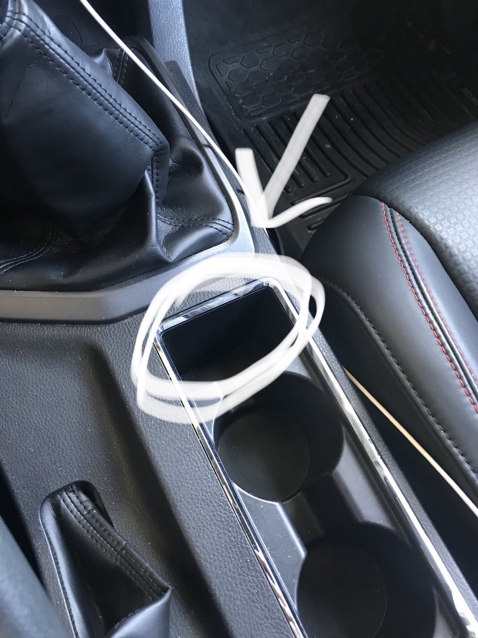

    Had anybody thought about mounting the screen here?

    I’ve thought about putting the spod HD unit in that spot and the q charging station area but those honestly are the most usable areas to put coins glasses ext. the most obvious place to put a switch panel is the basically unusable cubby where the other switches are left of the steering wheel

    I hear ya. I just use the cubby. It would be super sweet if you could just hardwire it into the qi cubby.

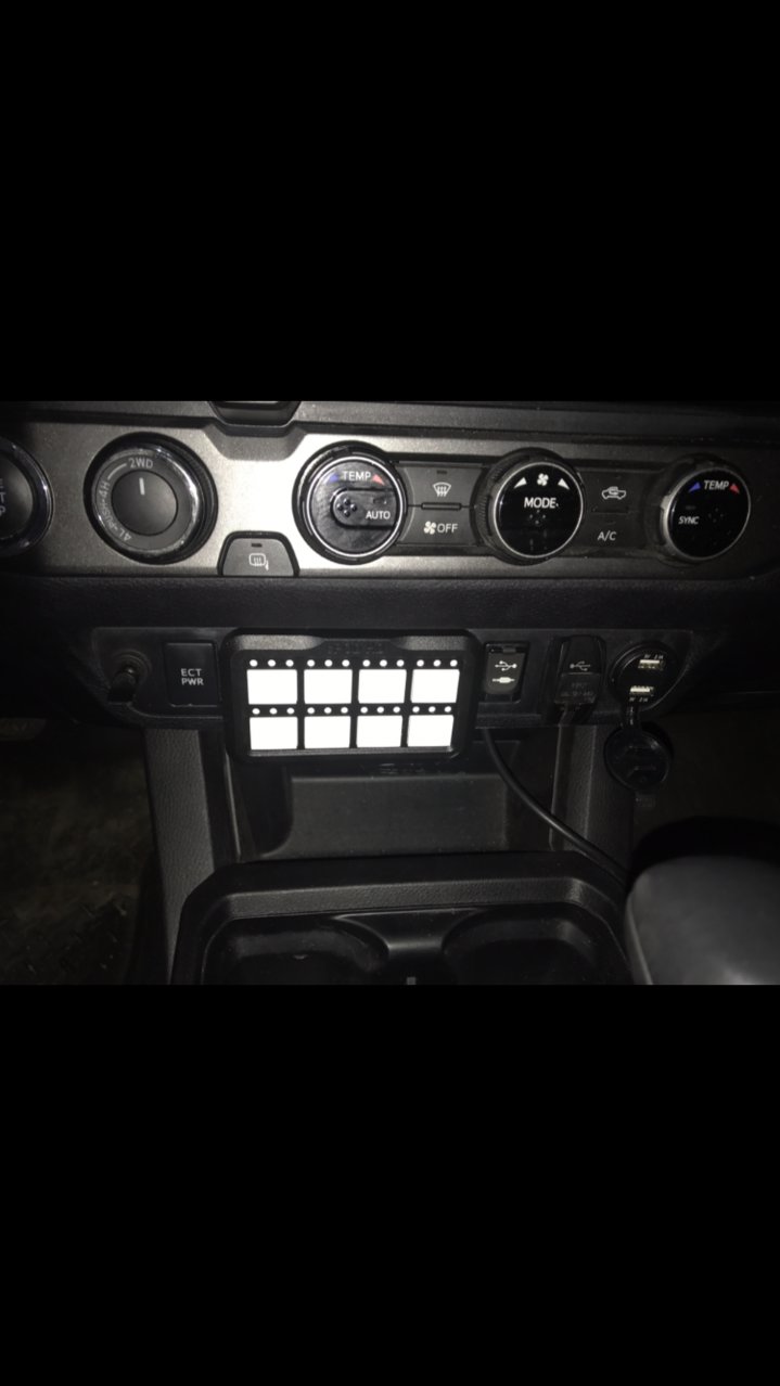

    Here is where i installed mine.
