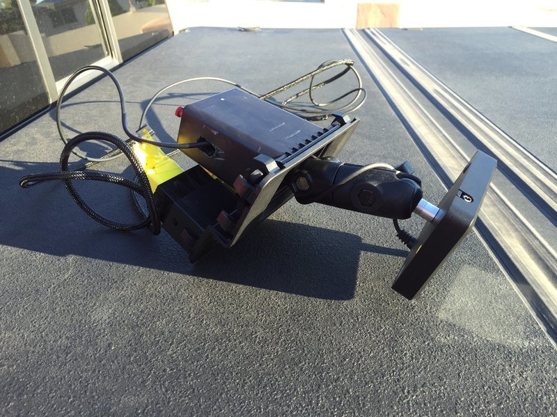

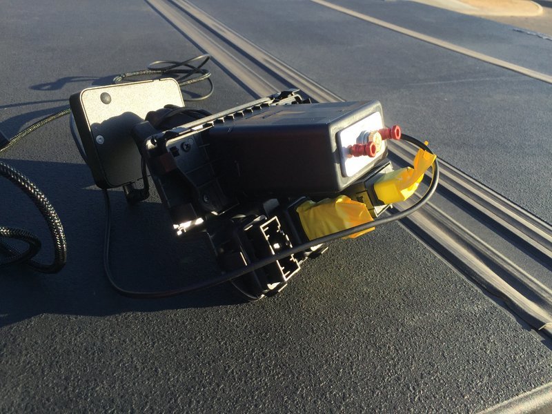

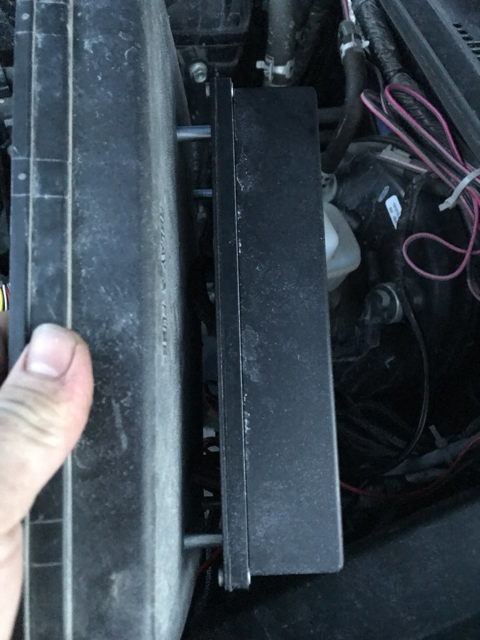

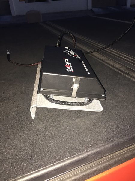

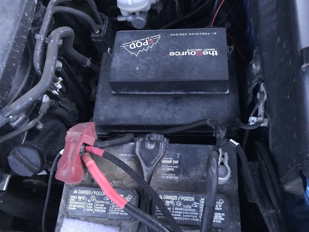

    Hey y'all! Just bought the spod se with the he panel. I thought the switch mounting would be tough but good good for the life of me I can't figure out how the bracket for the source is supposed to mount to the fuse box. It is missing instructions and the ones online don't really match the way mine looks. Is this the bracket?
    Am I supposed to disconnect the cables to get it off? What the heck!! Help!

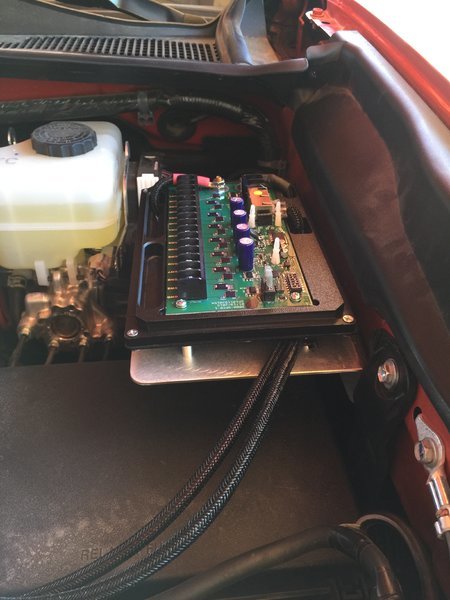

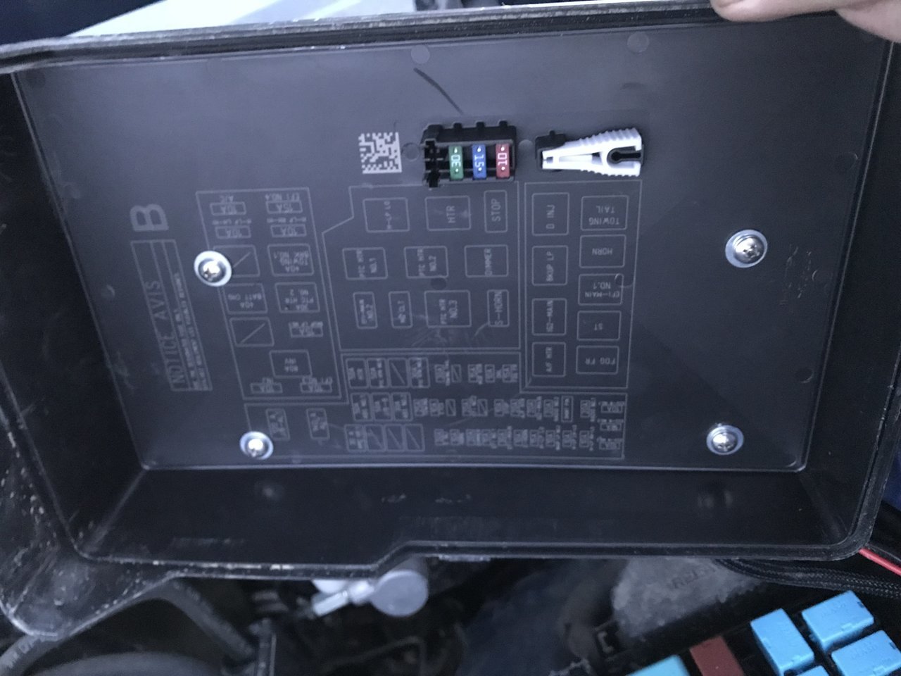

    Drill 4 small holes on lid of plastic fuse box for the 4 philips screws to go thru from inside the lid to the spod bracket/legs.

    Is it sturdy? I kind of want to get bigger washers.
    For the ground wire did you just bolt it to the frame bolt?

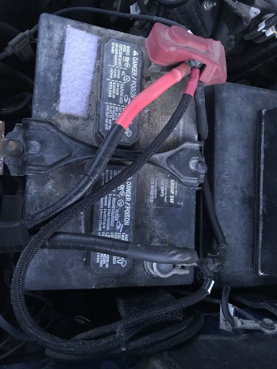

    I will be home shortly. I will take pictures for you. it is very sturdy with the hardware that’s included, adn my ground I believe is straight to the battery

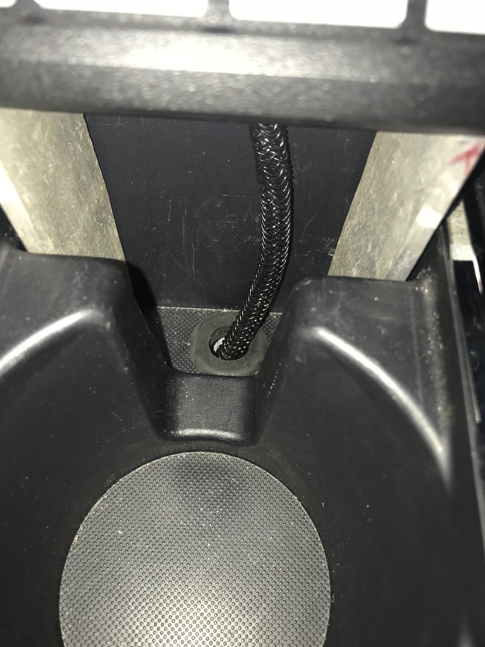

    New problem. Can't get through the effing fire wall. I having a hanger and am trying to pull the cable through.

    I used a chopstick to get thru the firewall. It should be pretty easy thru the rubber grommet.

    So I ended up going through the little one above the main one. Just couldn't get it man.

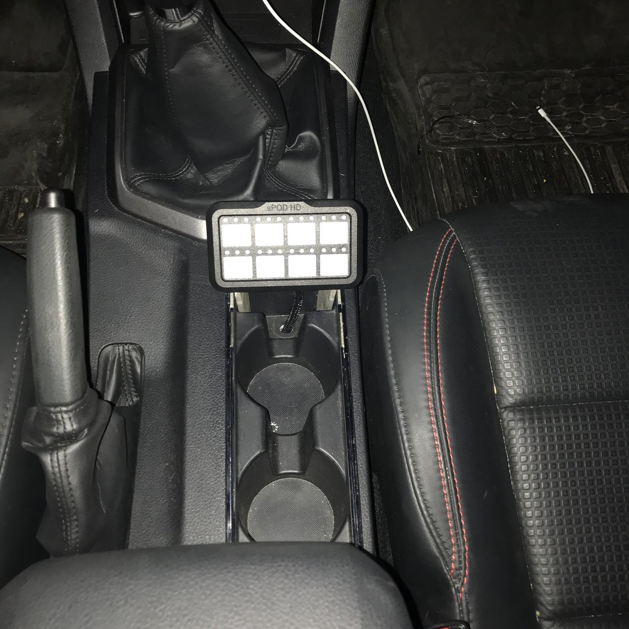

    Your power cable set up is so clean!

    Thats the whole point, everything should be ran off the spod. Except my winch which is the 0gauge with long red heattape.

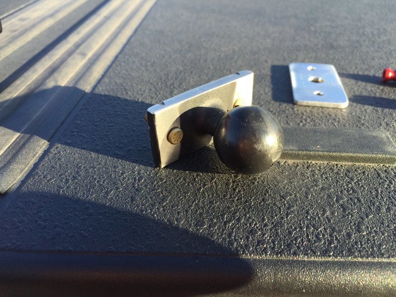

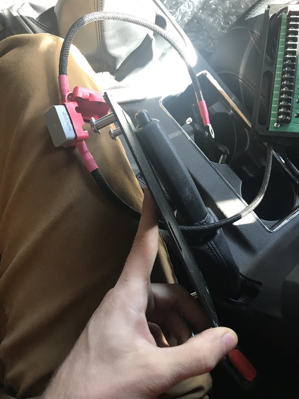

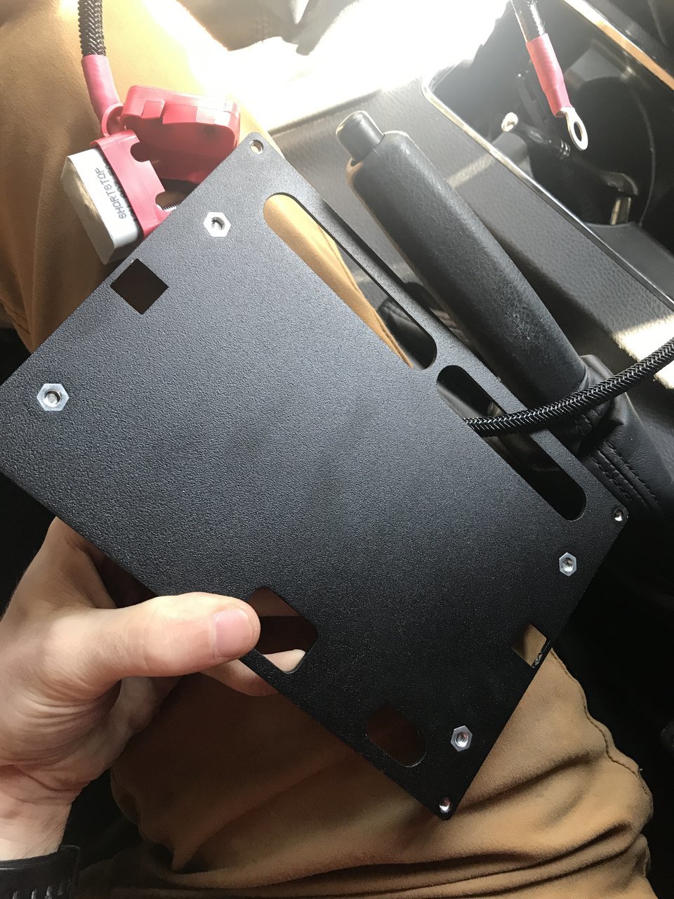

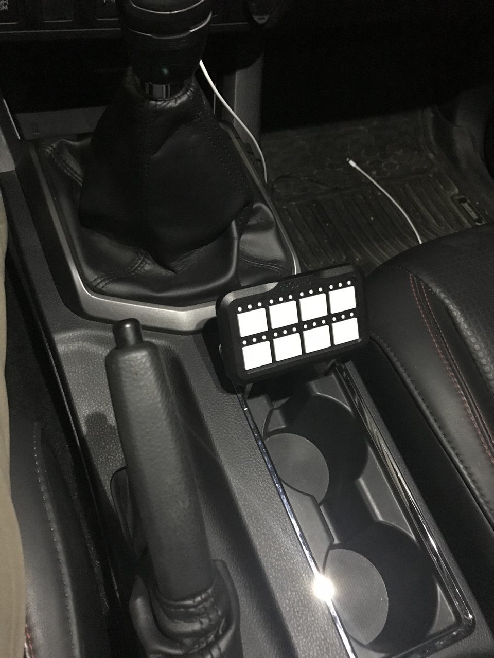

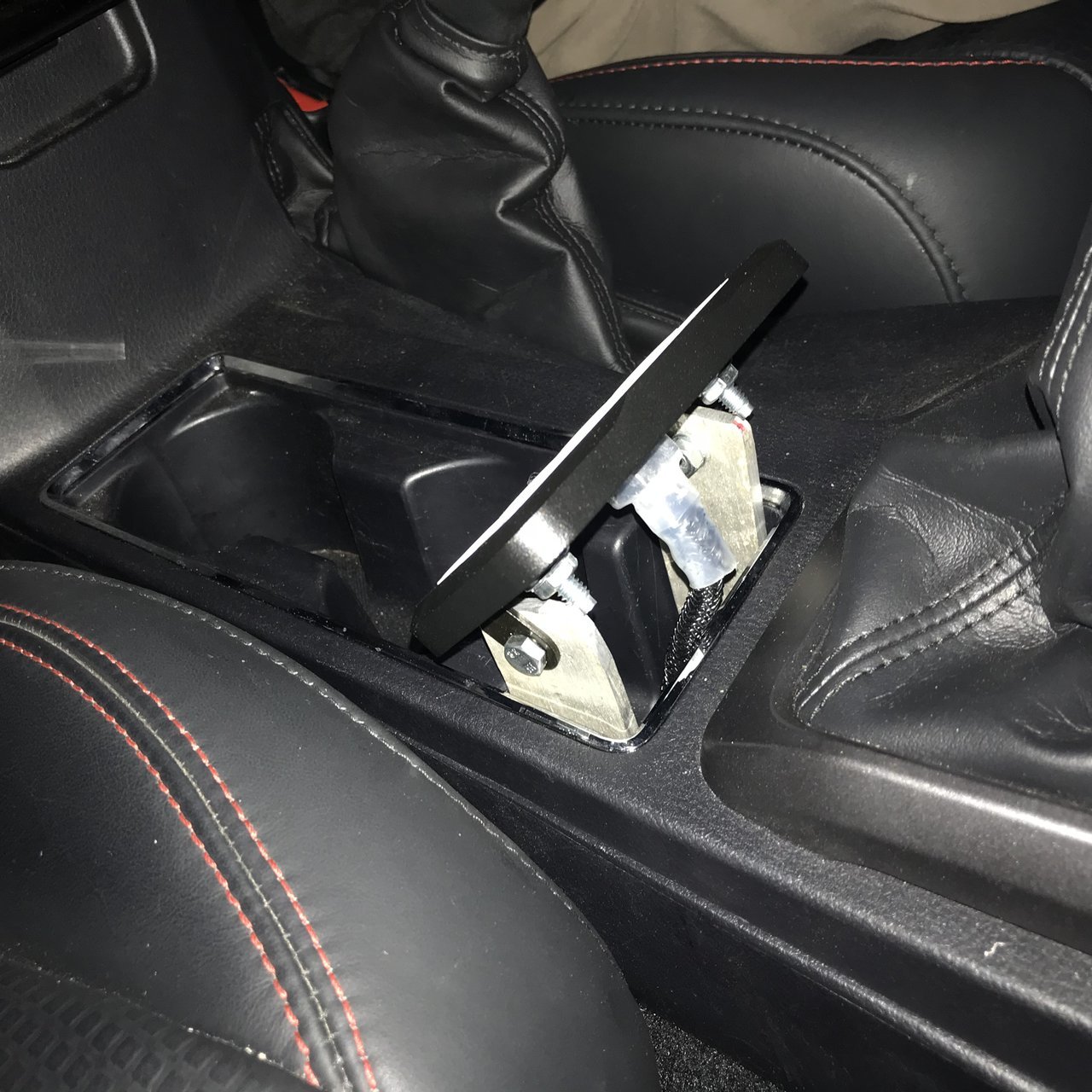

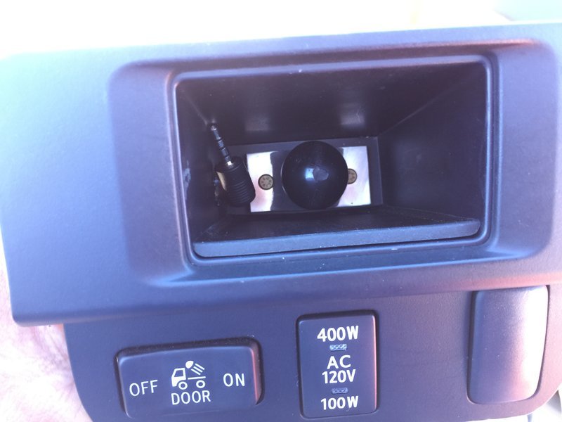

    Finally finished this mug.
    The bracket with the switch, for the moment, is in that cubby under it's own pressure and can come out. I plan to paint it Black and perfect the hinge set up. I really like that I can move it if I want. I still have a couple ideas floating around for other mounting spots!

    Looks good, how did mounting the box go.

    Oh fine man. Definitely was over thinking it. Love the way it turned out. Can't wait to add some lights!

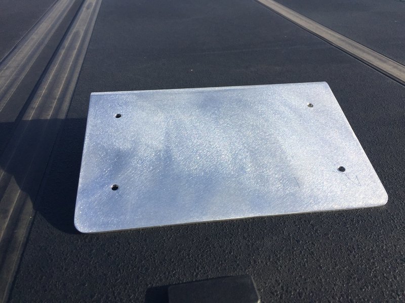

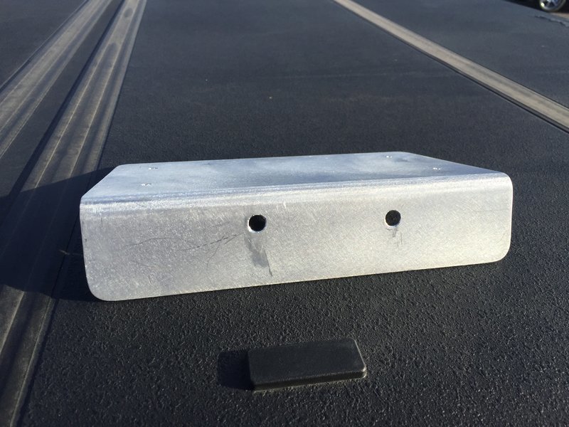

    Where did u get the metal plate that holds the spod box from?
