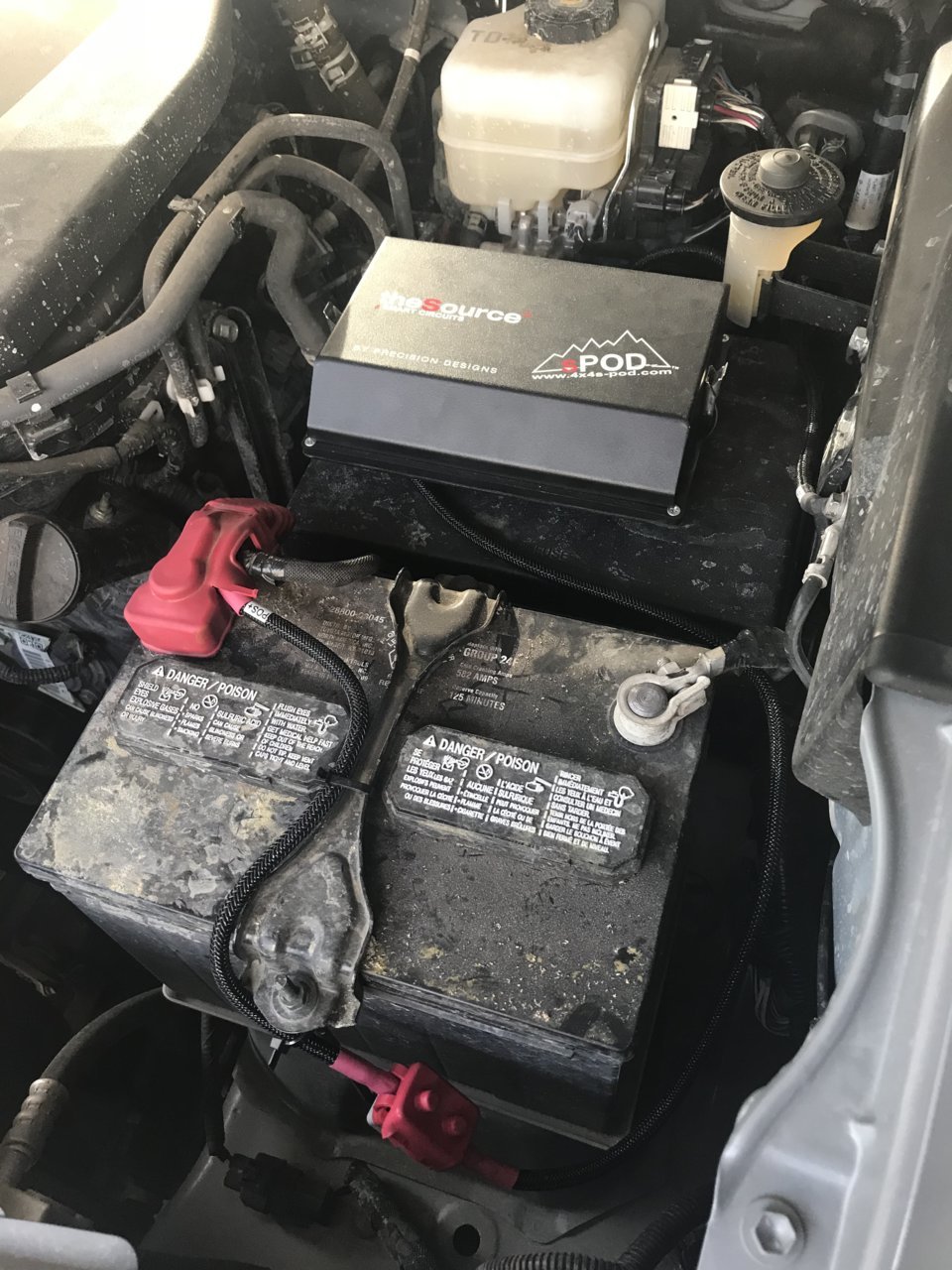

    Finally got my new sPOD Bantam and a ARB OBA Compressor (CKMA12) installed. Mounted both to a PowerTrays panel.
    Used a blank PowerTray because I wasn’t sure about exact placement of the new Bantam model sPOD and compressor. Tooled around for a while placing the compressor to check for hood clearance but I really like where everything ended up.

    Just barely fits with the quick disconnect pointed directly up. It sits perfectly in one of the tallest spots under the hood. Solid connections all sealed up in heat shrink. I’m personally really happy with the placement of everything and thought it was a clean install but let me know what you think.

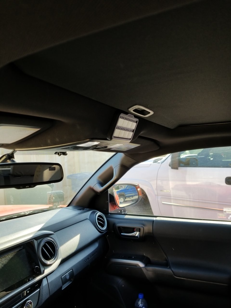

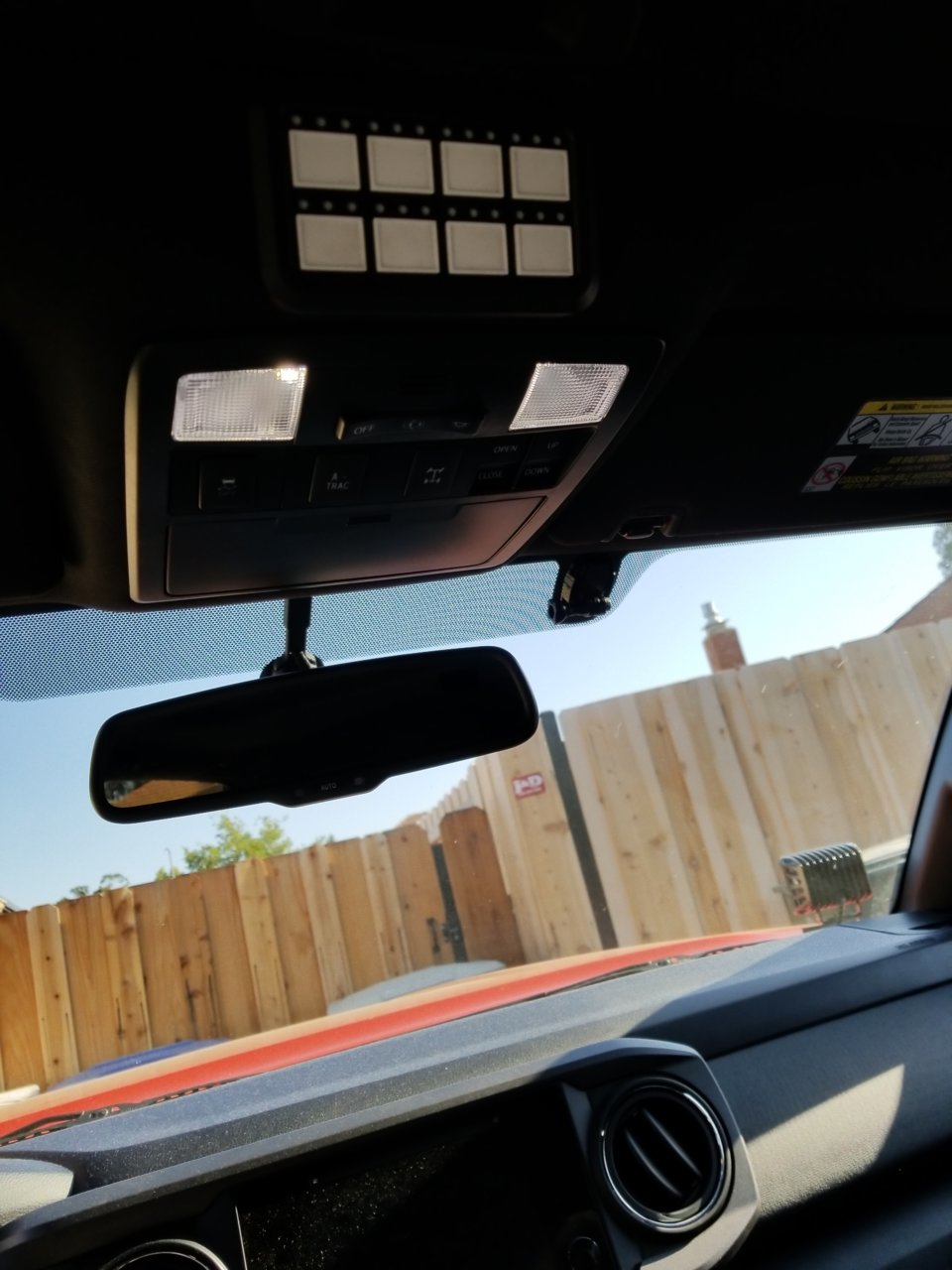

    I added mine a few weeks ago and love it. The phone app works ok. Its nice to be able to turn on my arb twin thats in the bed from my phone. It adds a few fun features as well you can make your lights strobe or just blink link switches together. I have my ditch lights wired so I can turn on left or right and the switches linked. So they will come on together or I can turn them on one at a time.

    Hey that's a clean mount! How'd you do that?

    Just dropped the overhead panel out. Placed the template in the area i wanted the panel to go. I then used an exacto knife to cut a + in the head liner. I didn't want the drill to twist around the fabric so i made small slices first. Then small pilot hole then stepped it up a little bigger then did the final hole. The middle hole for the RJ'45 connector is a 3/4. So we drilled a pilot and stepped up the bit sizes until it fit. I used the supplied mounting bracket that came with the sPOD to sandwich it on the back side after cutting it down to fit. I think it came out pretty good.

    Looks great man. I like it a lot.
