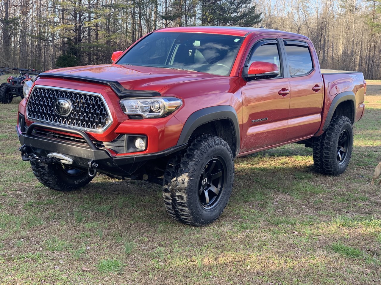

    Great looking truck! What suspension setup are you running in the third picture?

    Yeah that’s a nice stance you ended up with. I have a pro comp 3/1 spacer lift that came with my truck, but I’m looking to upgrade. What spring rate did you end up going with for the coils?

    My exact suspension -

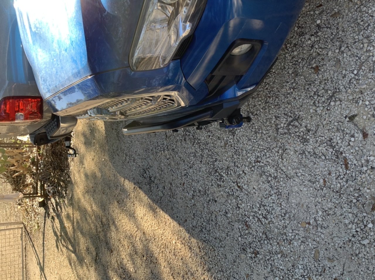

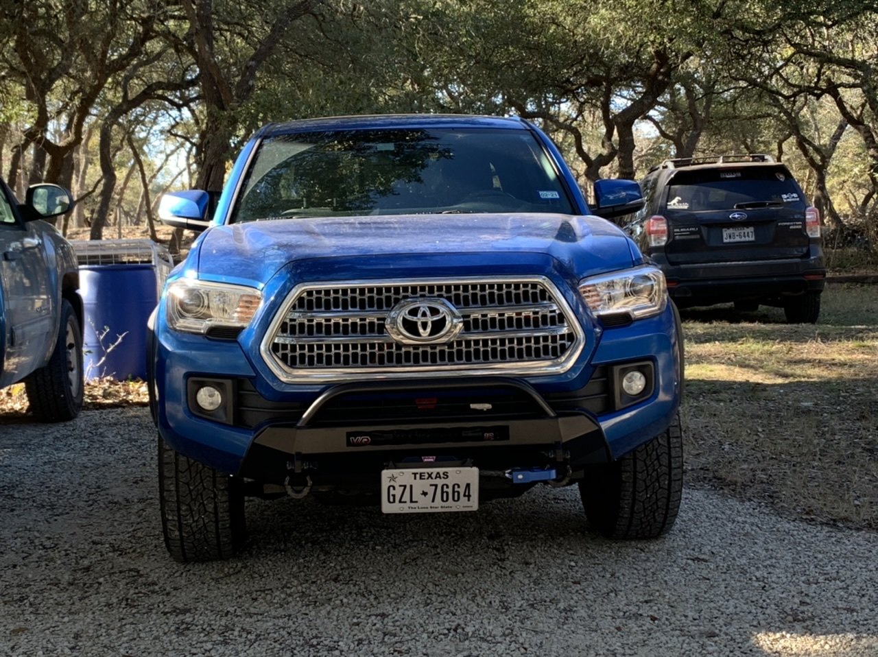

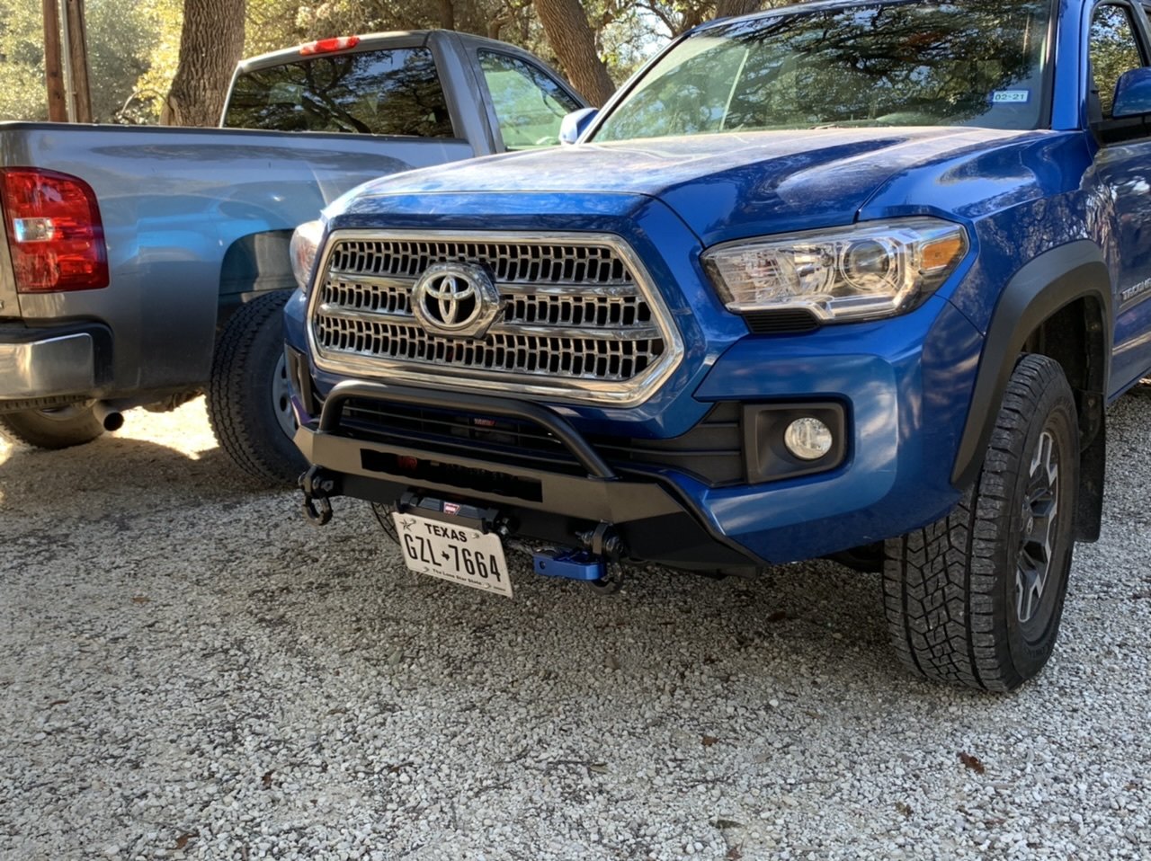

    6377D38D-45A7-418D-B46A-C5AC957A16CF.jpg FB62EA1E-3015-4FFA-BD40-F360EDC7C93B.jpg 9AE12BE3-79EF-415D-A30F-04697568BF5E.jpg Did my install yesterday and this morning. Light bar that SSO ordered from Baja Designs still hasn’t arrived, but I wanted to get all the chopping and cussing done while I was off work for a few days and had help available from my brother in law. Installed it with a Warn VR 10-s EVO, and had to cut the lower edge of the center support and fold it up to fit it. Will take more pics once I get the light bar installed. Love the low profile and already got compliment from the telecom guy who came out to upgrade my FIL’s internet service.

    Turned out great. Which cut line did you use and how wide of tape? I've read different ways to do this. :annoyed:
