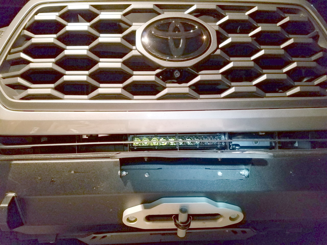

    I was able to install a 10" Rigid light bar in there. It's possible the clutch handle housing can be "clocked", but I didn't try it as it looked questionable.

    RyanDCLB
    RyanDCLB Well-Known Member
    Jun 13, 2019
    #296235
    3,546
    4/19 DCLBOR
    Here's a picture. you can see the clutch handle on the Right.

    RyanDCLB
    Jun 13, 2019
    #296235
    3,546
    4/19 DCLBOR
    The Smittybilt winch has relocation brackets to the left, so I didn't need to cut the bar. I opted for the midnight light bar, and prefer it to be behind the lower grille, compared to cutting the grill as mentioned, because I'm going for a low profile stock look. :thumbsup: Good pont about cutting out the lower grill though!
    For example, you can barely see the light bar behind the lower grille in the picture here:
