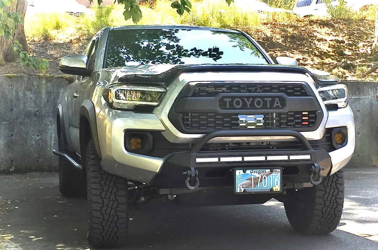

    Thank you for the write up! I used your instructions and it went in perfectly!
    Big thumbs up!!

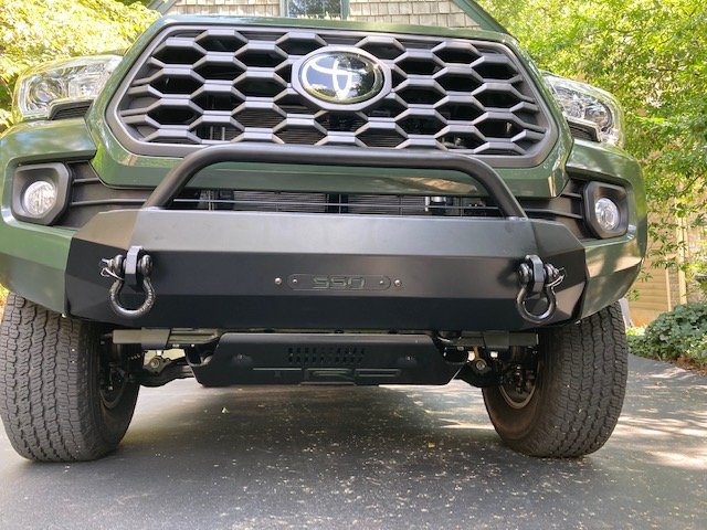

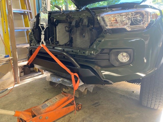

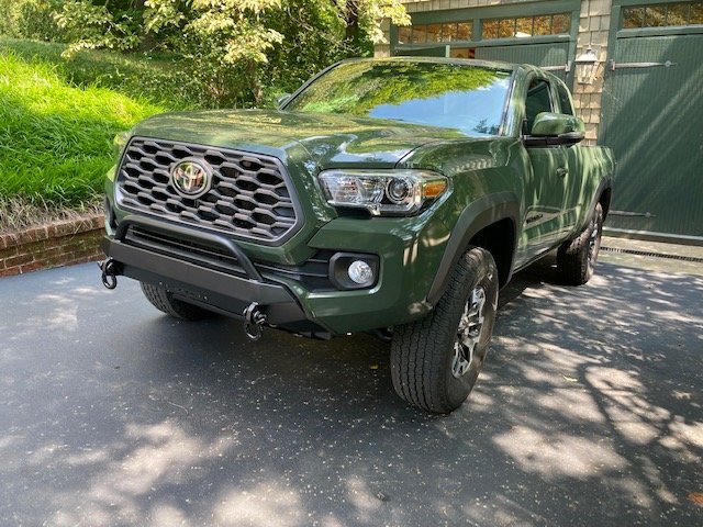

    Bumping this tread to say thanks to Hodakaguy for a great How To. Installed my bumper by myself one evening last week in just over three hours (no winch to install for me, though).

    Ditto. The OP shows the left side tape line pretty well. His cut looks just a little curved though. I think you want straight cuts. For the right side you have to do sort of a mirror image calculation. I took my laptop to the shop for frequent checks of his photos. You absolutely want to use his spacing for the top section cut line for no gaps.
    I didn't have the torque figures and was too lazy to look them up, so I just cranked her down hard as I could with a good 1/2" drive ratchet.
