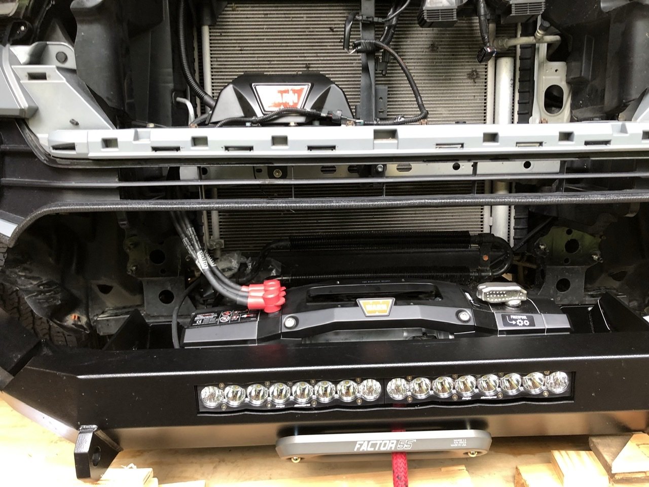

    WARN ZEON 10-S with the SDHQ Relocation Kit fits.

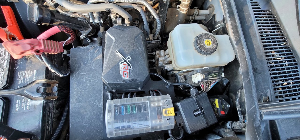

    Do you have to relocate the control pack for the Warn VR EVO 10-S winch?
  11. Dec 30, 2021 at 11:27 PM
    #371
    The Pirate
    The Pirate Takoyaki Takoma
    Feb 15, 2019
    #283117
    358
    Yes, you need to either relocate it or cut the brace.

    Anybody recommend a relocation kit with bracket?
    Or anything specific I should be looking for?

    I put my relocation together on my own. But it really depends how handy or how much interest you have in making one. My real goal was to minimize blocking airflow to my radiator. However, I like messing around with stuff.
    But the kit mentioned above seems to have minimum impact to the radiator but would case me to ditch my bumper light.

    Nice to see the someone save their grille light with the SSO winch hybrid bumper
