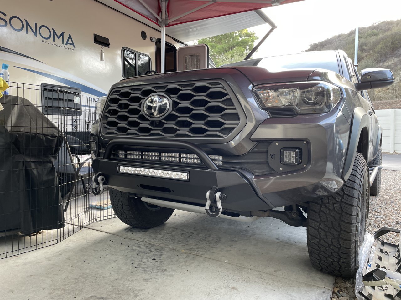

    Ok one more question regarding the light.
    Who went with the Heise light from SSO and how do you like it?
    Anyone find another light that would fit in the Heise location in case a change is needed?
  13. Jan 17, 2022 at 4:45 PM
    #393
    Nomad26
    Nomad26 Well-Known Member
    Sep 3, 2019
    #304117
    834
    Escondido, CA
    '16 MGM OR Access Cab, ‘16 MGM RAV4 Hybrid
    I bought the Heise light and it's just okay. I think I need to aim it up a little higher though. Also, I have the Cali raised hidden bumper light and that thing is so bright there's no comparison. So when I turn on the Heise light it just doesn't seem like much. Kinda wish I went Rigid, but then I see how expensive they are and think I made the right decision, lol. I am not sure if anything else would fit in there since its made specifically for that light bar, the mounts inside the bumper fit this light perfectly. But I have not looked into putting another light in there.

    Well decided to go with the Rigid cutout and the Rigid Midnight series.
    You have any pics on what it looks like with the midnight on the truck during the day. Also any pics of the light output.....
    Thanks in advance
