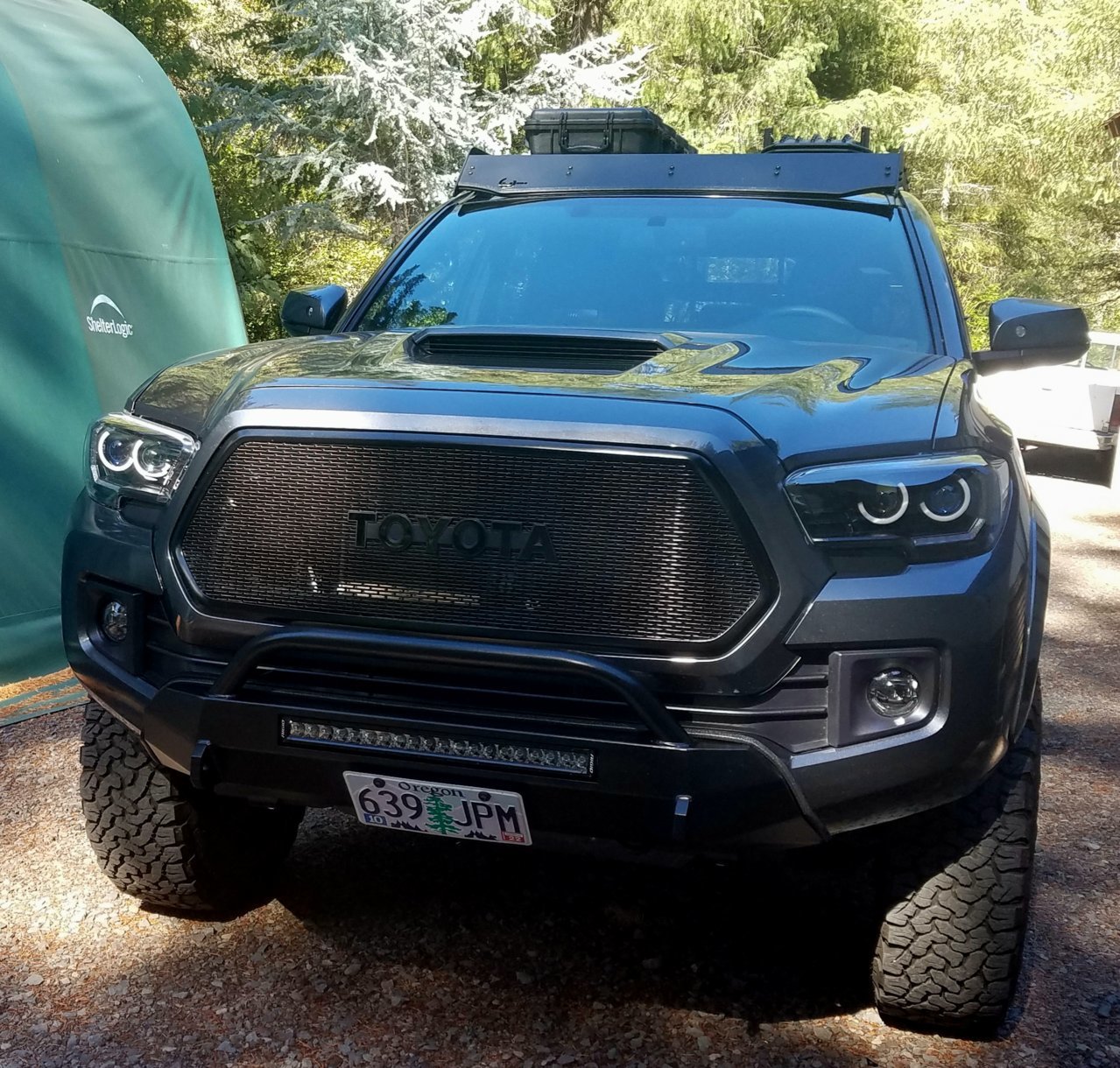

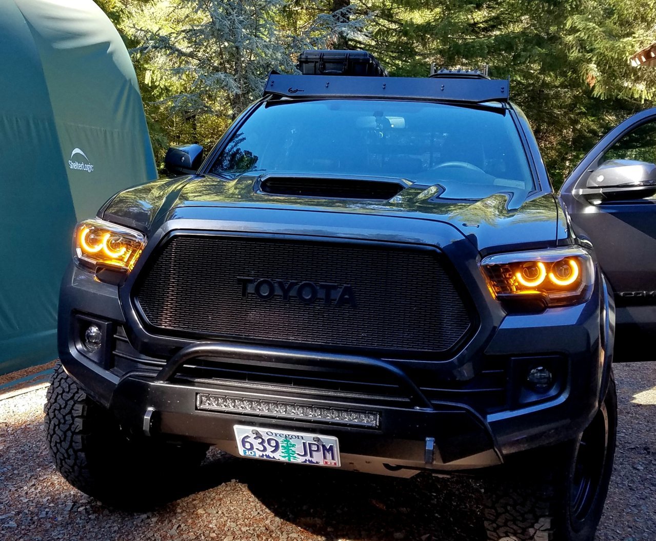

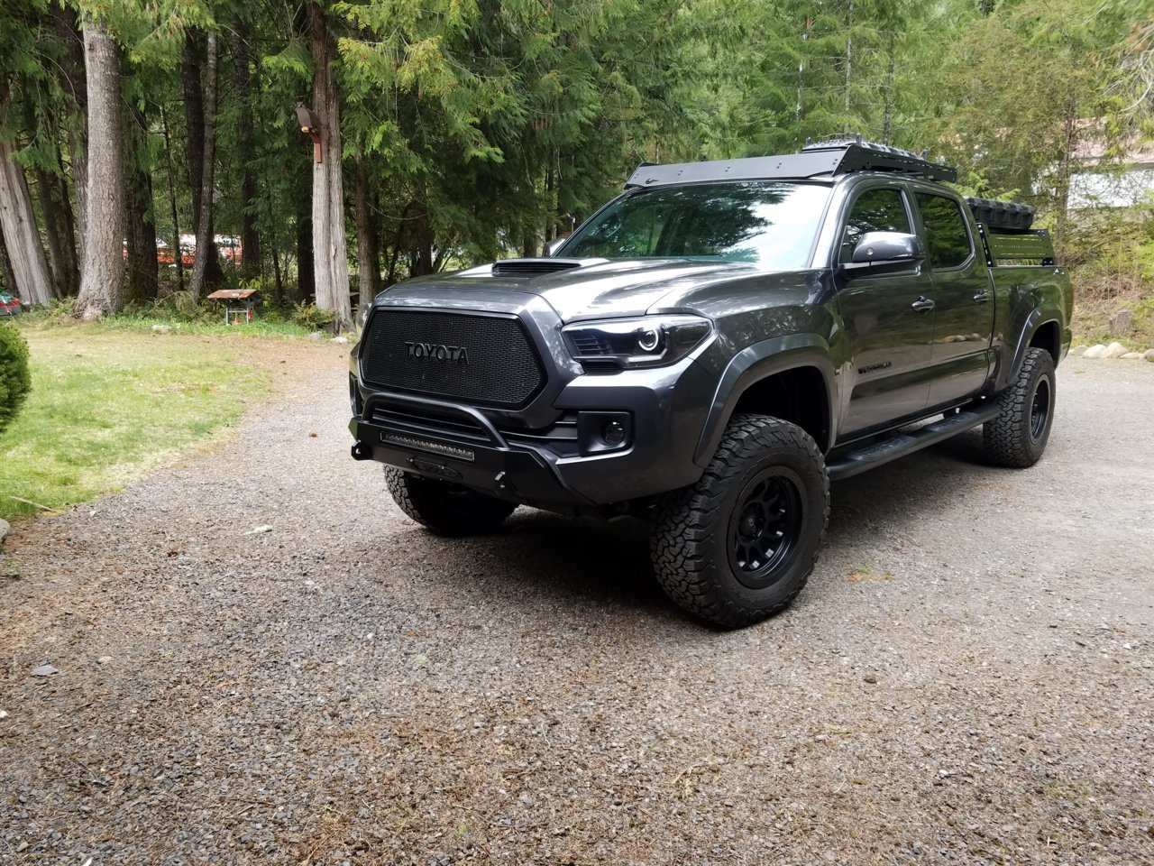

    Found a couple on the truck during the day. I don't have any with output at night but it's very good IMO. 20220120_060314.jpg 20220120_055934.jpg

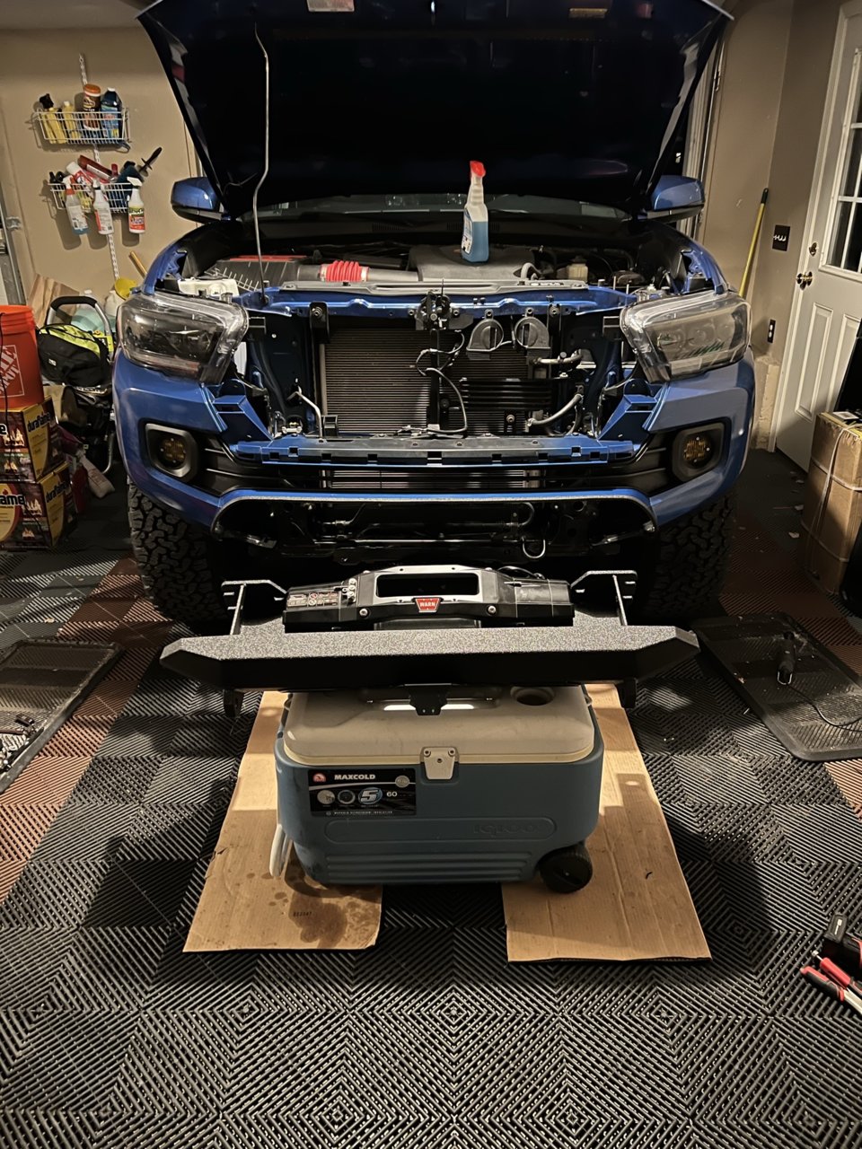

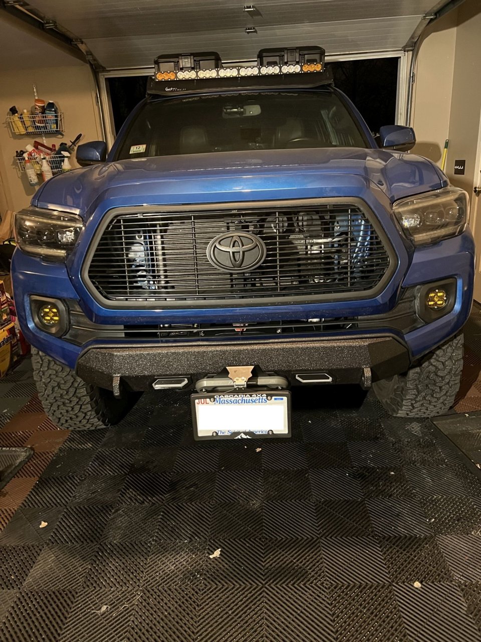

    Just finished installing mine. I left as much plastic on as I could since I didn't go with the bar. I think it came out good - I may not have 2 friends around for the install, but I have one damn good cooler! :proposetoast:.

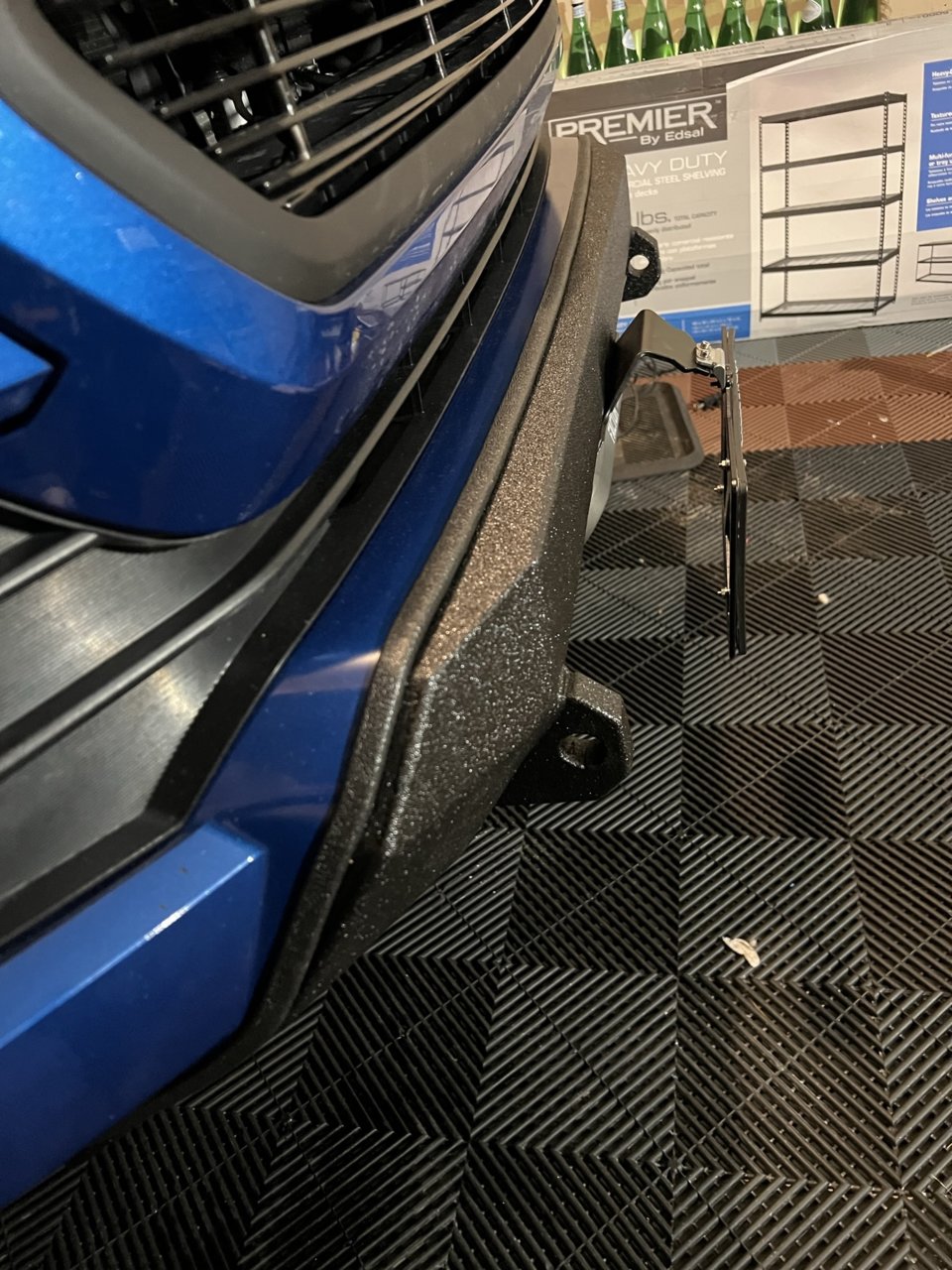

    How far back did you cut. I think normal is 1”
    looks great!

    For the middle I cut along the bend just before the clips for the bumper cap. Then tapered in to 1/2 inch before the bend line that runs under the truck. (like the SSO Instructions say to do - with a little extra left on). I am thinking I really want to add on the Stage II wings. I'm rubbing in reverse on the fender liner very slightly. I could heat gun it, but I love how the Stage II looks anyway.

    Was yours coated by what looks like bed liner? Did SSO coat it?
    So you cut right on the edge not 1 inch back from the edge after bumper cap off?

    It's Line-X Bedliner, No I had a local Line-X shop do the coating. I ordered the bumper in the white from SSO.
    Correct Right on the edge.

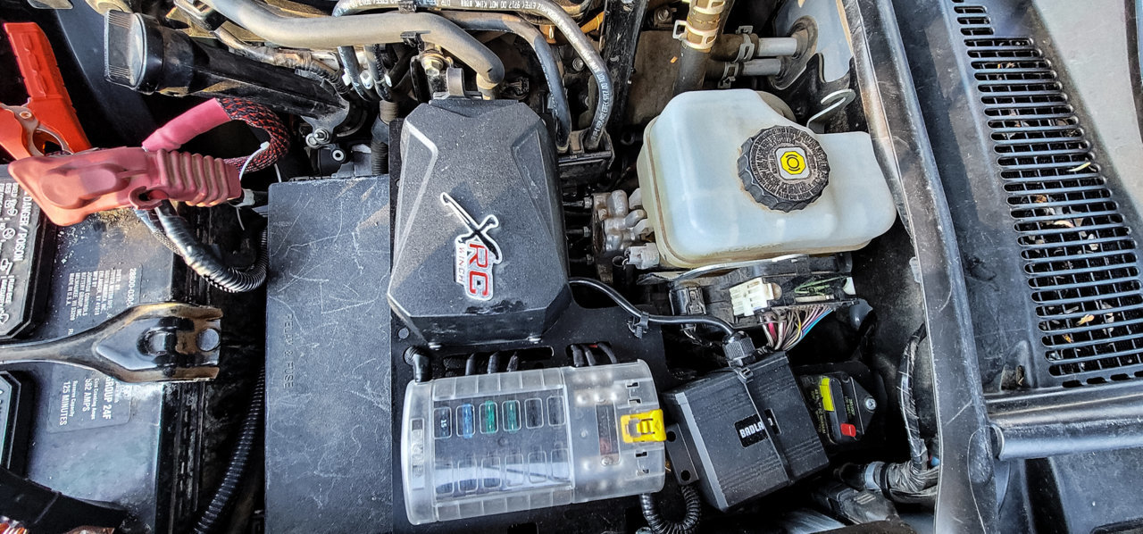

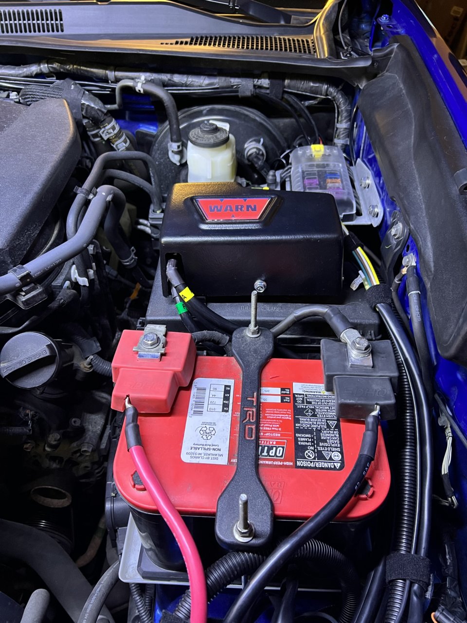

    I used the Warn long relocation pack so I can move the control box someplace up under the hood. Someplace near the battery seems like a good spot. I want to put a lightbar behind the grille, so the SDHQ mount not is going to work. I don't know of any other commercial control box mount products. Are there any others? I'd like to check them out.

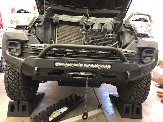

    Here is the long kit installed...

    So you mounted it to the fuse box lid. Looks pretty good

    I did the same thing
