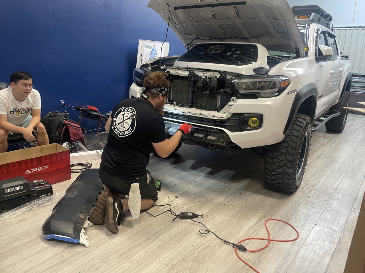

    you probably did your install already but I can answer your questions for future installers wondering the same thing.
    I kept my skid plate on during install. And those side radiator panels are still on my taco. I cut a large hole on one of them to allow the winch wires into my engine bay.

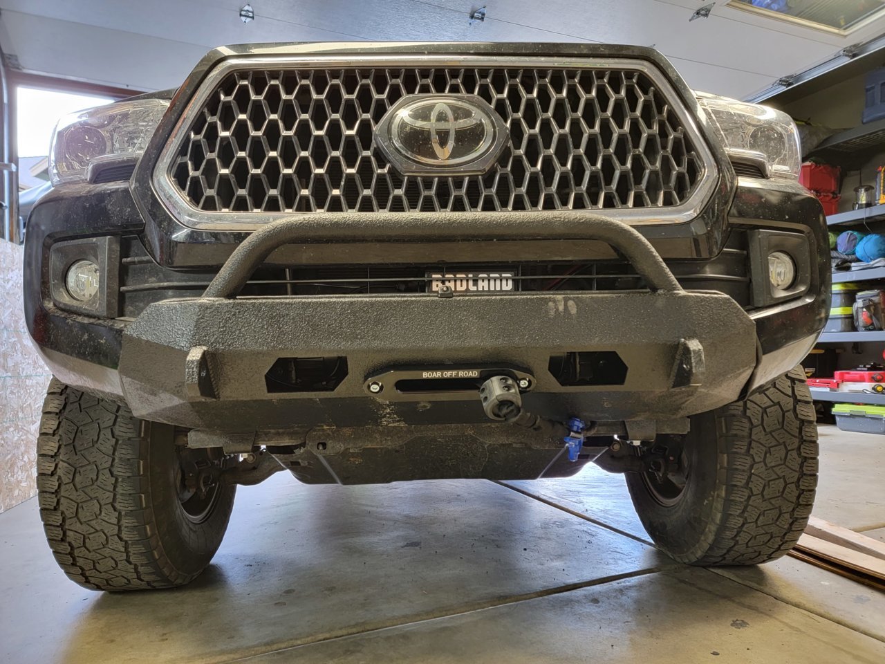

    Hey Hodaguy, first thank you for this awesome, easy to follow install thread for this bumper. Between your instructions and the video SSO provides, I was able to get this awesome bumper installed on my 2018 Tacoma. I have one question though...how do you get those little brackets on after the bumper is in place??? I had one on the bumper as we put it on the truck but even that one I haven't been able to get attached to the actual truck. And I can't get my hands into the area where the bracket goes to try to get the other one installed. Any suggestions would be awesome and greatly appreciated!!!

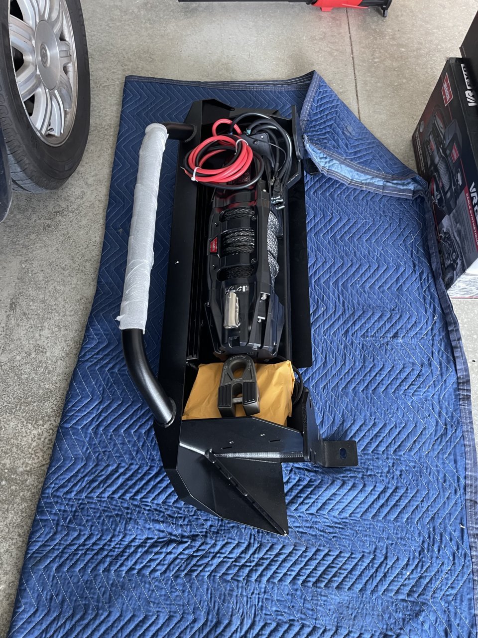

    Prepped and ready to go, in a few days

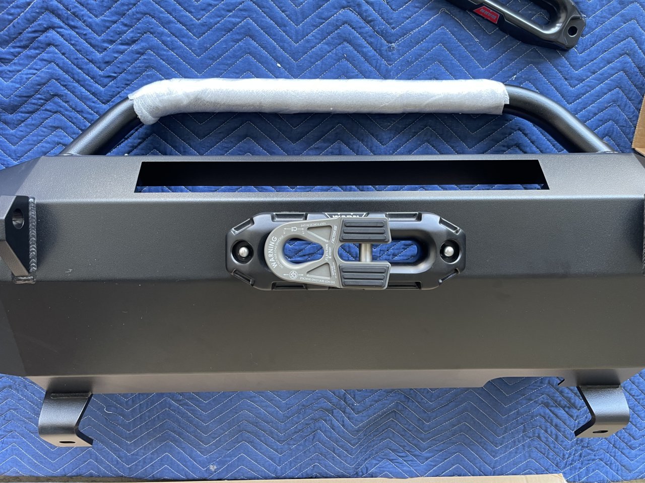

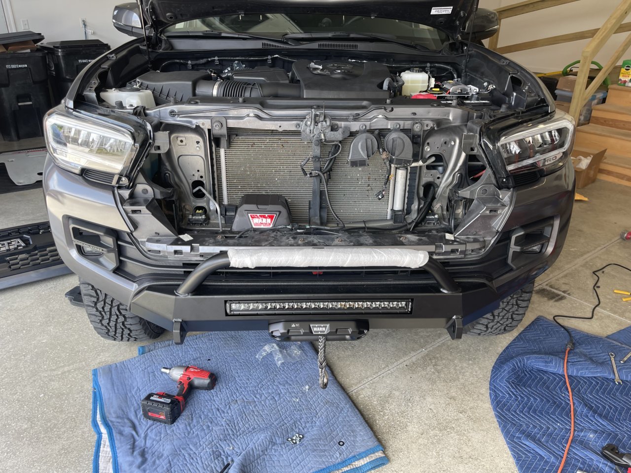

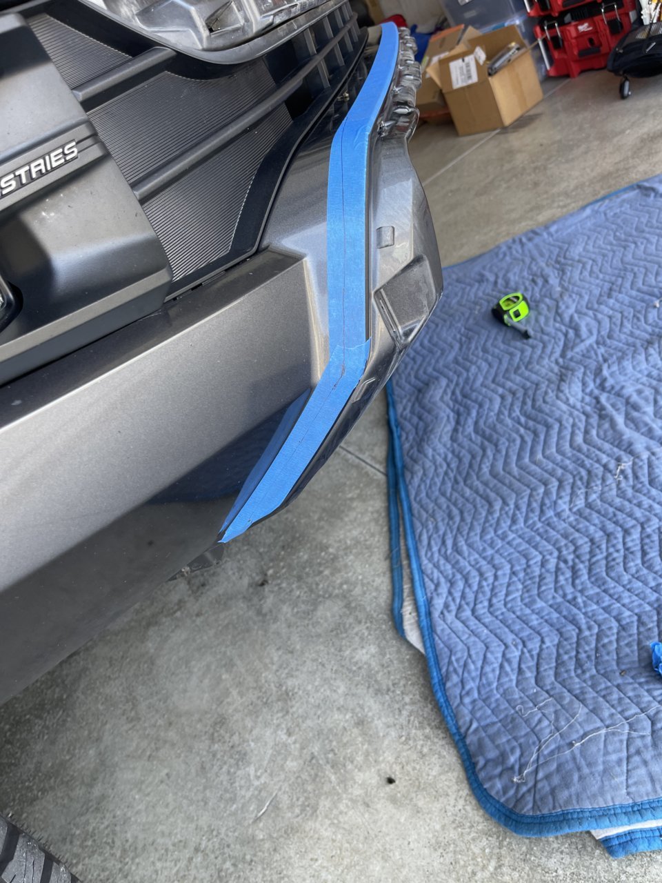

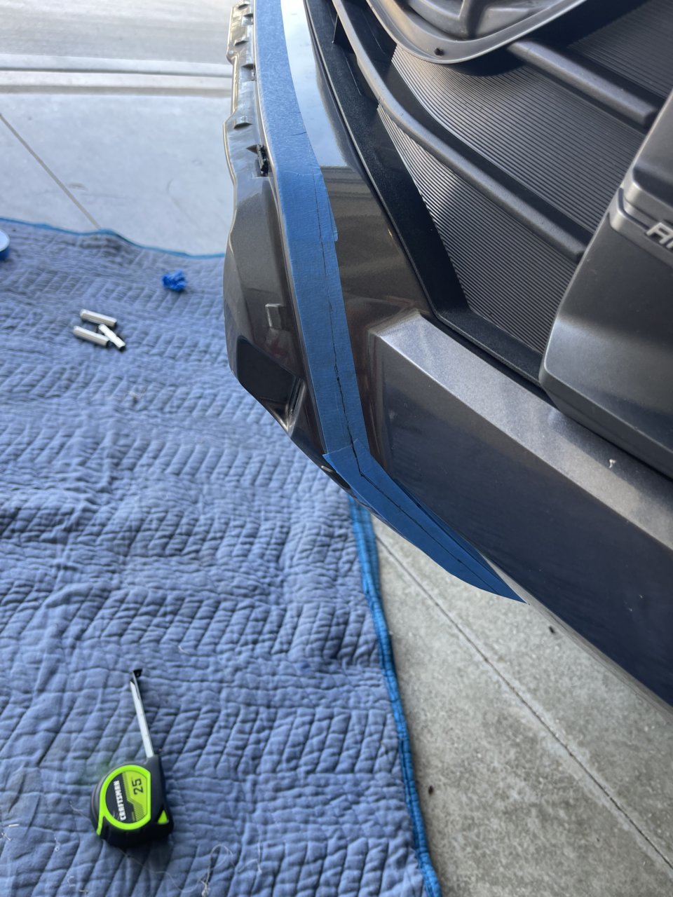

    Some progress today.
    20tacoma17 likes this.

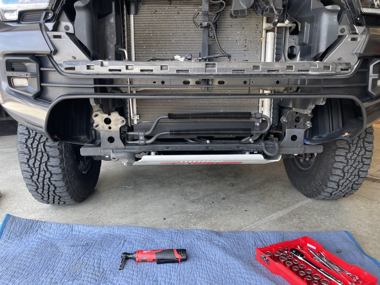

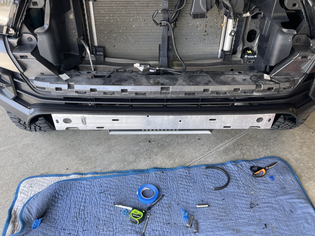

  18. Aug 15, 2022 at 11:15 AM
    #438
    gregnauman
    gregnauman Well-Known Member
    Jul 2, 2020
    #333209
    472
    Greg
    2020 Tacoma TRD Pro
    None

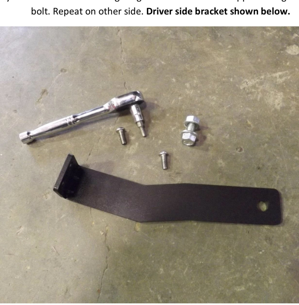

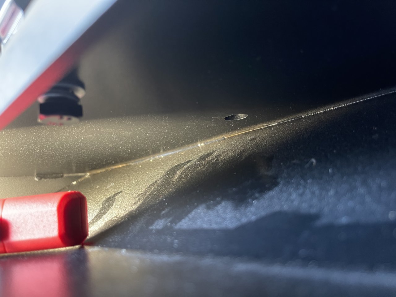

    I was able to get the brackets in.
    took the brackets through the bumper skin shield area below fog light.
    There are two threaded holes at the base of the bumper.
    Mine had a large hole and a small hole for some reason. OP picture shows 2 small holes with 2 black bolts.
    So I used 1 black bolt and 1 silver bolt from the package.
    you have to make sure you get the right and left side brackets correct. The L faces up toward the engine compartment. loosely thread the bolts in and then fit the opposite end to the bumper skin hole. You take the orange clips out of the hole.
    The skin bolt did not come with a nut shown in pic below but the bracket was threaded
    This is the drivers side bracket from the instructions.

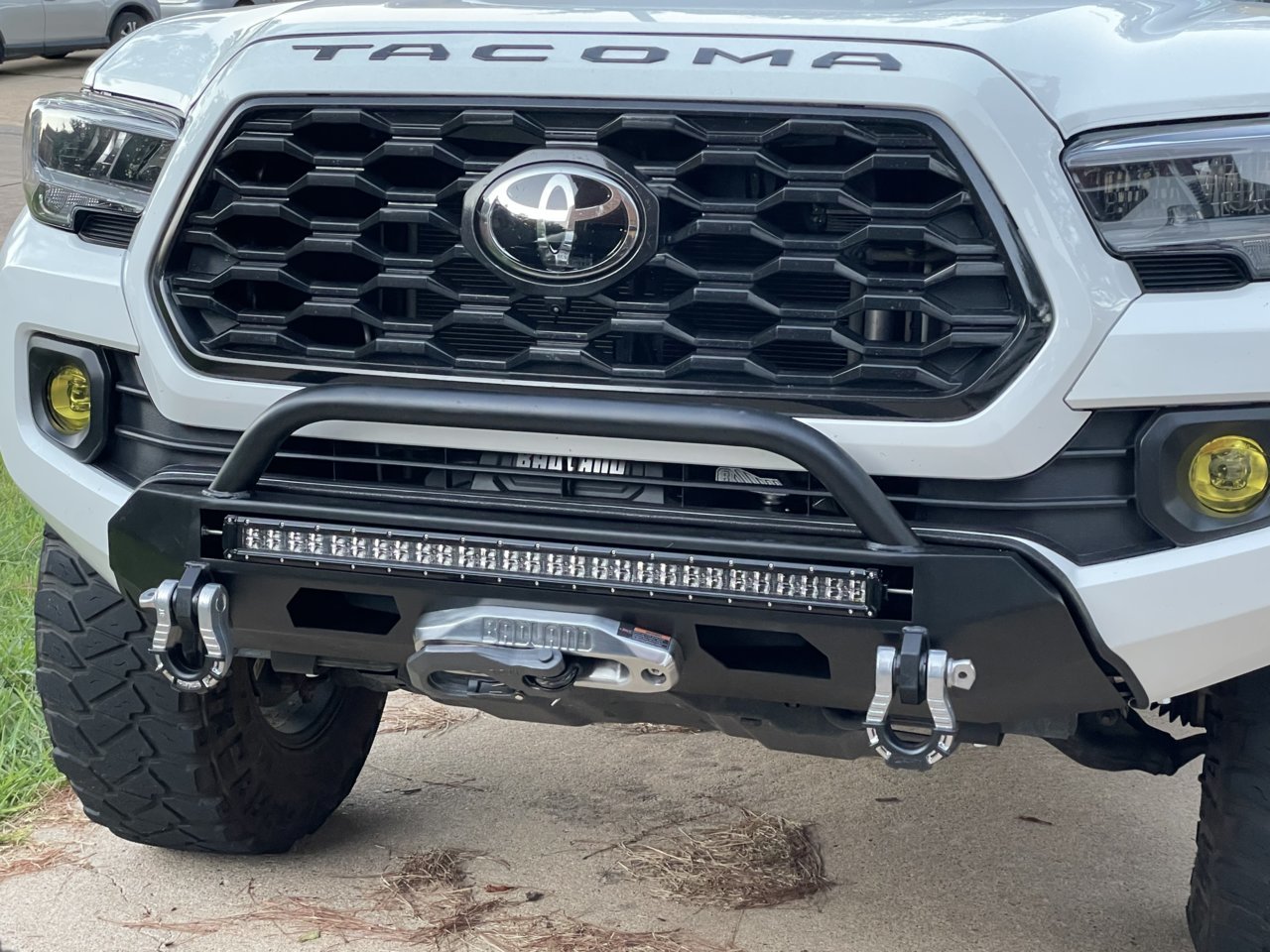

    Two questions for those who have already plowed the fields.

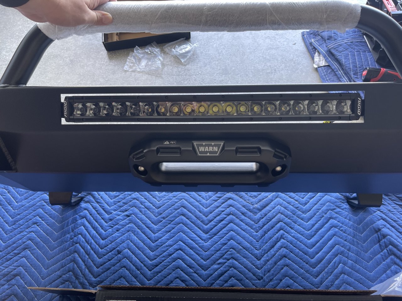

    1. Those using the HF Badlands APEX 12,000 winch @Boyettexan and @Keeperduck016 were you able to leave the top control box on the winch. If so what mods did you do to make work?
    2. Will I be able to install a 20” light bar after the winch is installed? Mine is installed :anonymous:and I’m waiting on the light bar. The cut out dimensions are 21” 13/16 long x 2”3/16 wide. Light dimensions are 22” L x 1.8” W.
