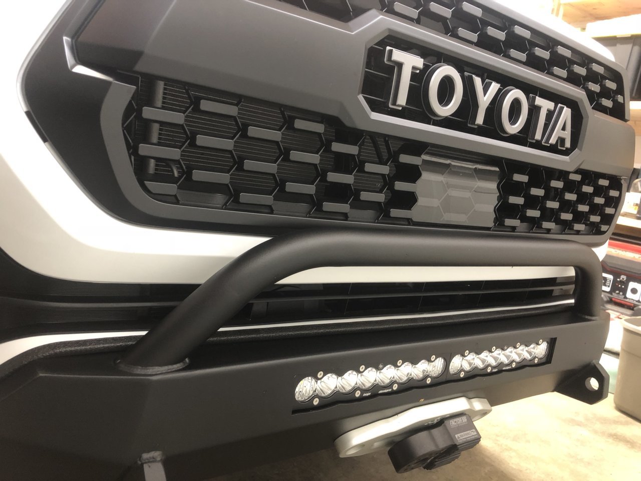

    Great write up! Just got done installing my SSO slimline! I purchased the Smittybilt X2O winch with synthetic rope. I really like the hook setup you have on your winch line and can’t find one for the life of me. If you don’t mind me asking where did you get it, or did it come with the winch?

    It's the Factor55 flatlink

    Thank you sir! I also have a pro grill with the TSS sensor, so far no interference

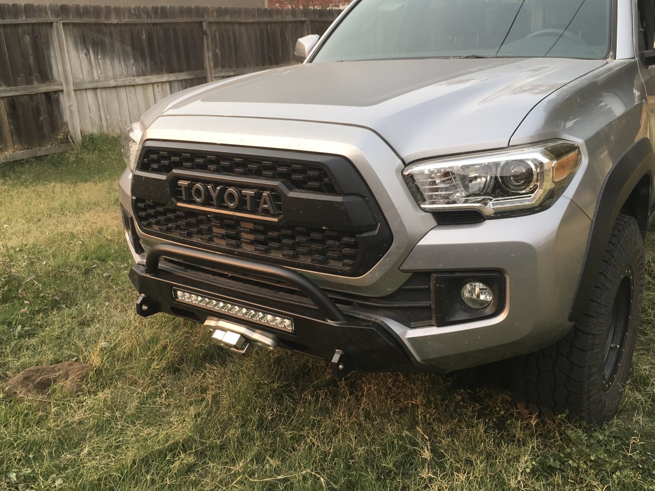

    Does anyone know if the sso slimline interferes with the radar and also would a behind the grill light install (caliraised led brackets) work with the setup?
  7. Oct 9, 2018 at 8:53 AM
    #47
    CaliRaisedLed
    CaliRaisedLed Well-Known Member Vendor
    Apr 23, 2015
    #153803
    8,288
    Jake
    Texas (DFW)
    LJArk94, dbonal and Rome604 like this.

    It doesn’t interfere with the radar sensor on mine

    Yes we know the bumper will not interfere with the caliraised bar in the lower position, just above the bumper not in the grill, but can you still get a winch in there with the light bar? It doesn’t look like it to me.

    SSO will do a light bar and winch.

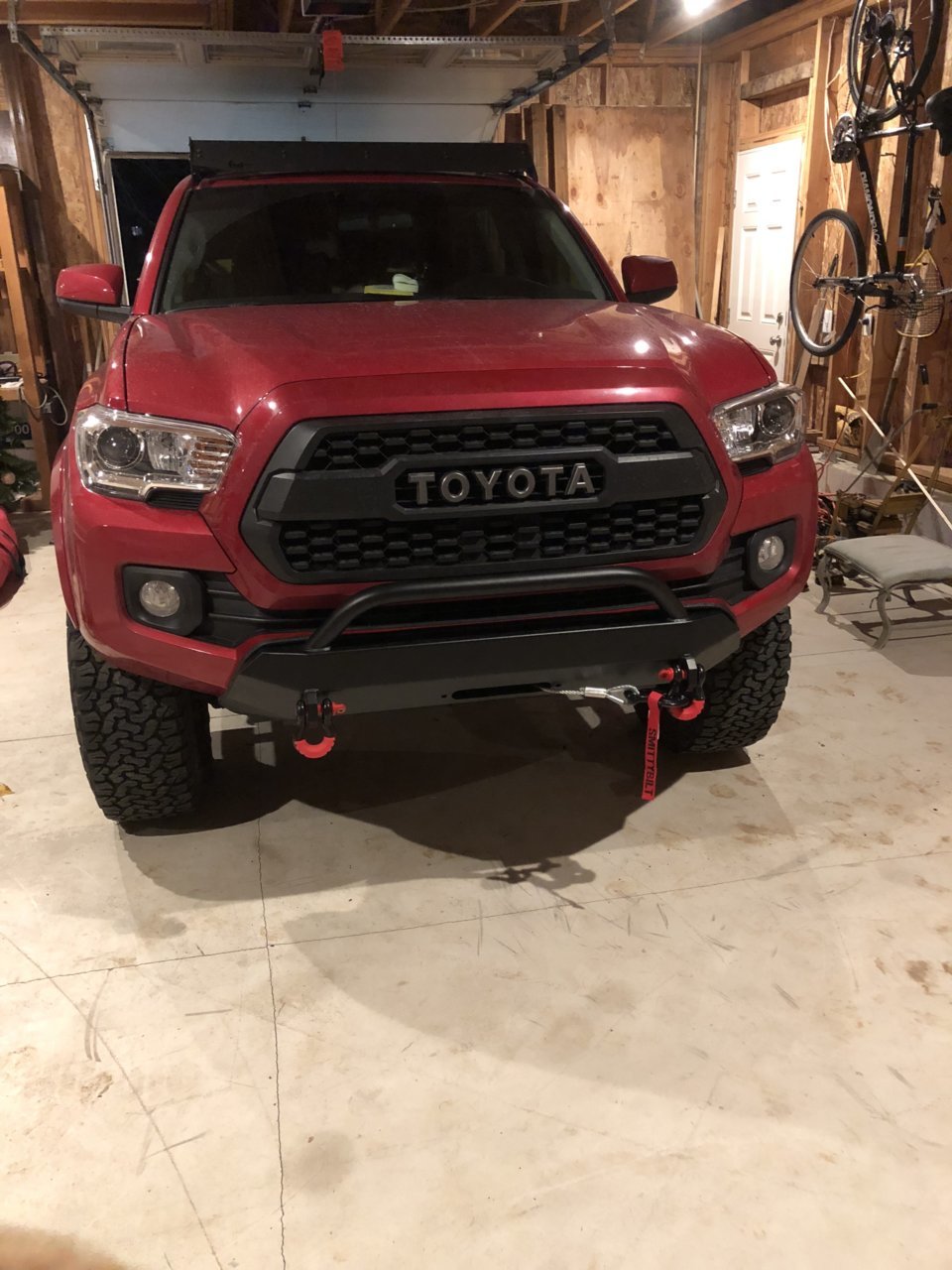

    I didn’t even look at the SSO instructions that I got with the bumper, literally followed this thread and it came out perfect.
    Thank you!
