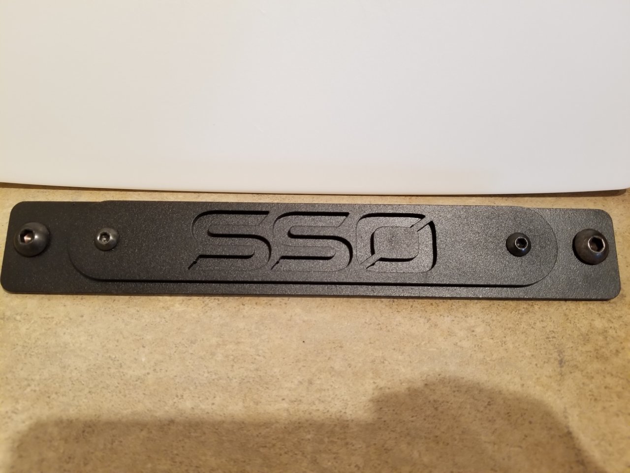

    Yes, you can select the option on their menu for a winch hole cover. I actually ordered the cover when I ordered my bumper, but ended up finding a good deal on a used winch, so I never installed the plate. Here's what it looks like. I ended up donating it to a fellow member.

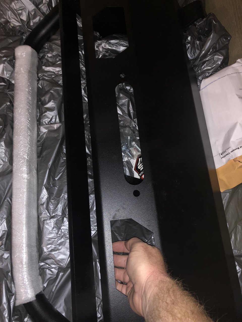

    What’s the difference between winch cut outs and accessing through engine bay? Do you want the winch access holes or whatever they are called? What do most get?

    I ordered with the access holes, didn’t want to have to lift the hood to access the winch controls. The access holes add two holes on either side of the hole for the winch line, that’s the only difference. 5064D6FD-01AC-4820-ABA1-D43635504E61.jpg
