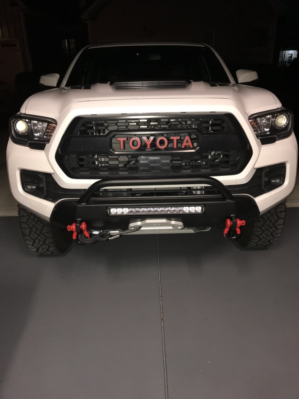

    Another successful install based on this thread. I wish I would have left just a little more on the lowest portion of both the right and left side but over all it looks good. Installing the side fender support brackets was a pain and is probably why they want you to take off the whole fender but I managed to get them installed. Still have to swap out the OEM hook just ran out of time. The only thing I have to do now is find a tall light bar switch as I only have a tall spot open.....

    Looks good.. What winch did you go with??

    Smittybilt X2O

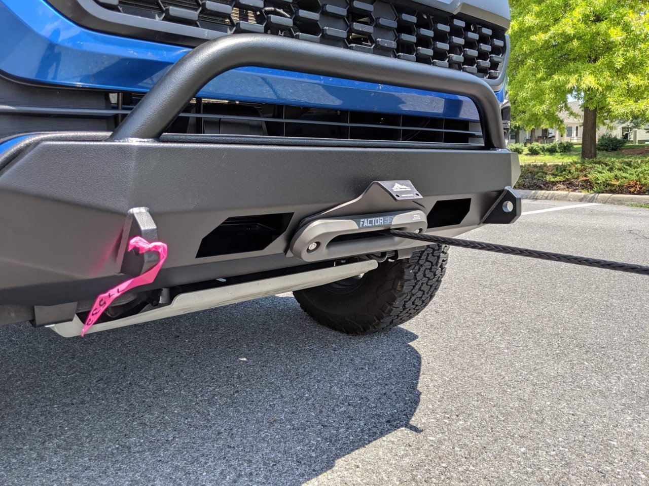

    Thanks @Hodakaguy for this thread, I followed his modified instructions and had a smooth and great looking install. Very happy with the results.
