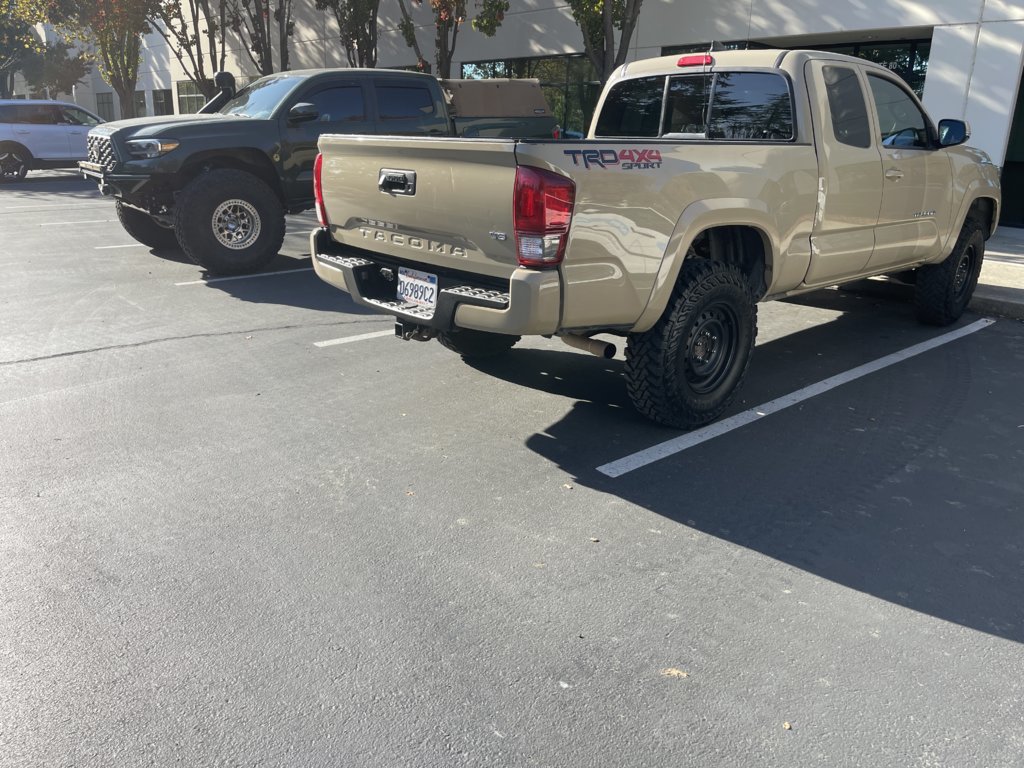

    [​IMG] Thinking about running these RC steel wheels on my 3rd gen. I remember seeing a thread about steel wheels and caliper clearance. Anyone have any experience/advice with this?

    Your pic is not showing up.

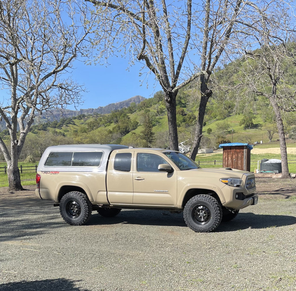

    I am currently changing to 17" steel from the FJ. 17x7.5 +19 offset and 5" backspace. No problem with the stock OR calipers. Original OR rims were 16x7 +25 offset and 5" backspace.
    Going to 17" because the tire selection is greater.

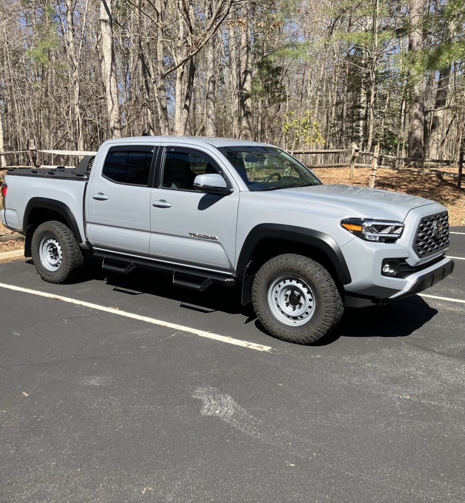

    I've got 16" Toyota OEM steel wheels, no issue with fit.

    These are OEM steelies that come as spares on ORs. Painted Cement to color match. No issues with brake calipers.

    I am running the 17x9 steel wheels. No issues.

    They fit no issues. Get acorn style lugs.
