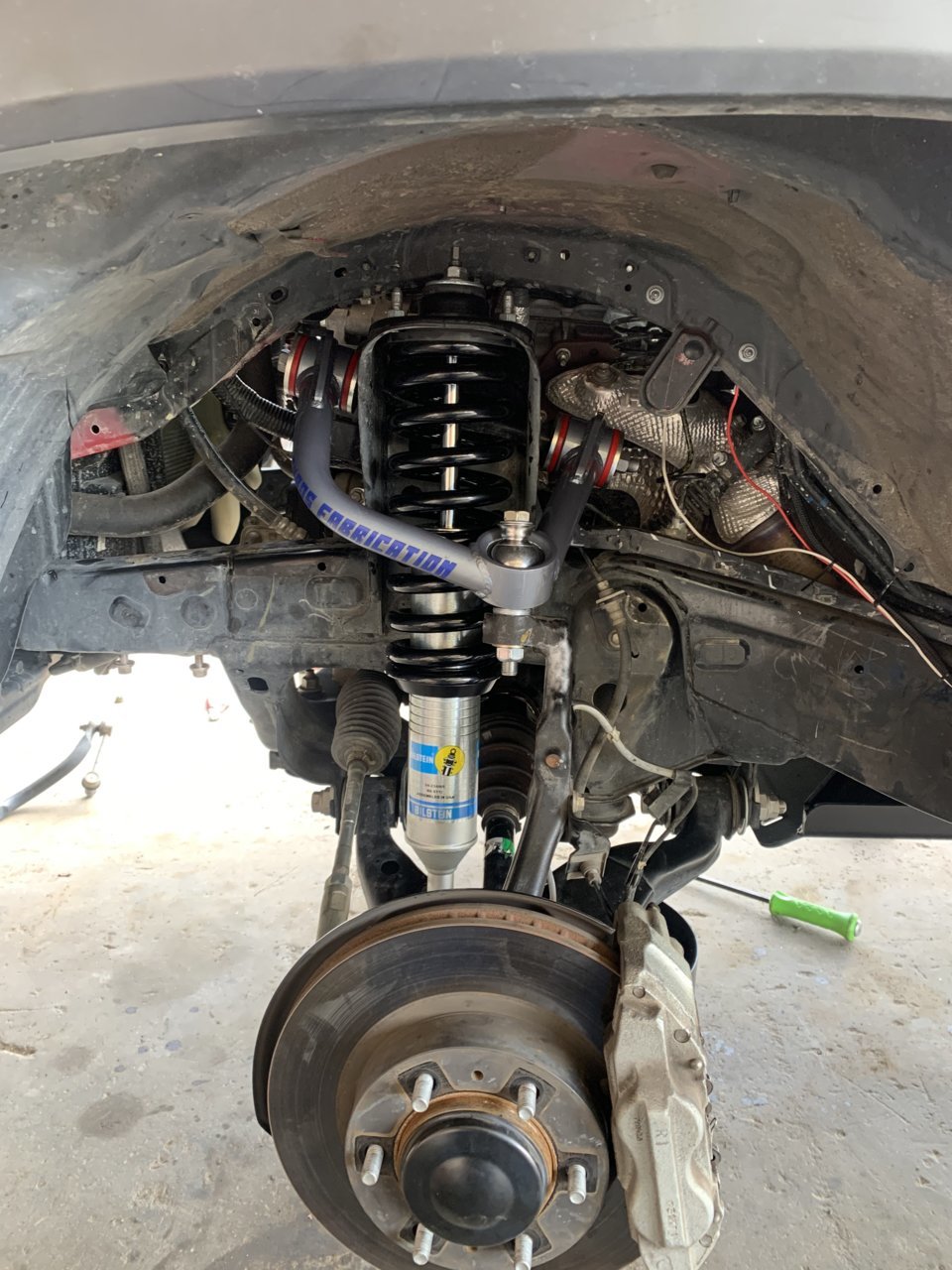

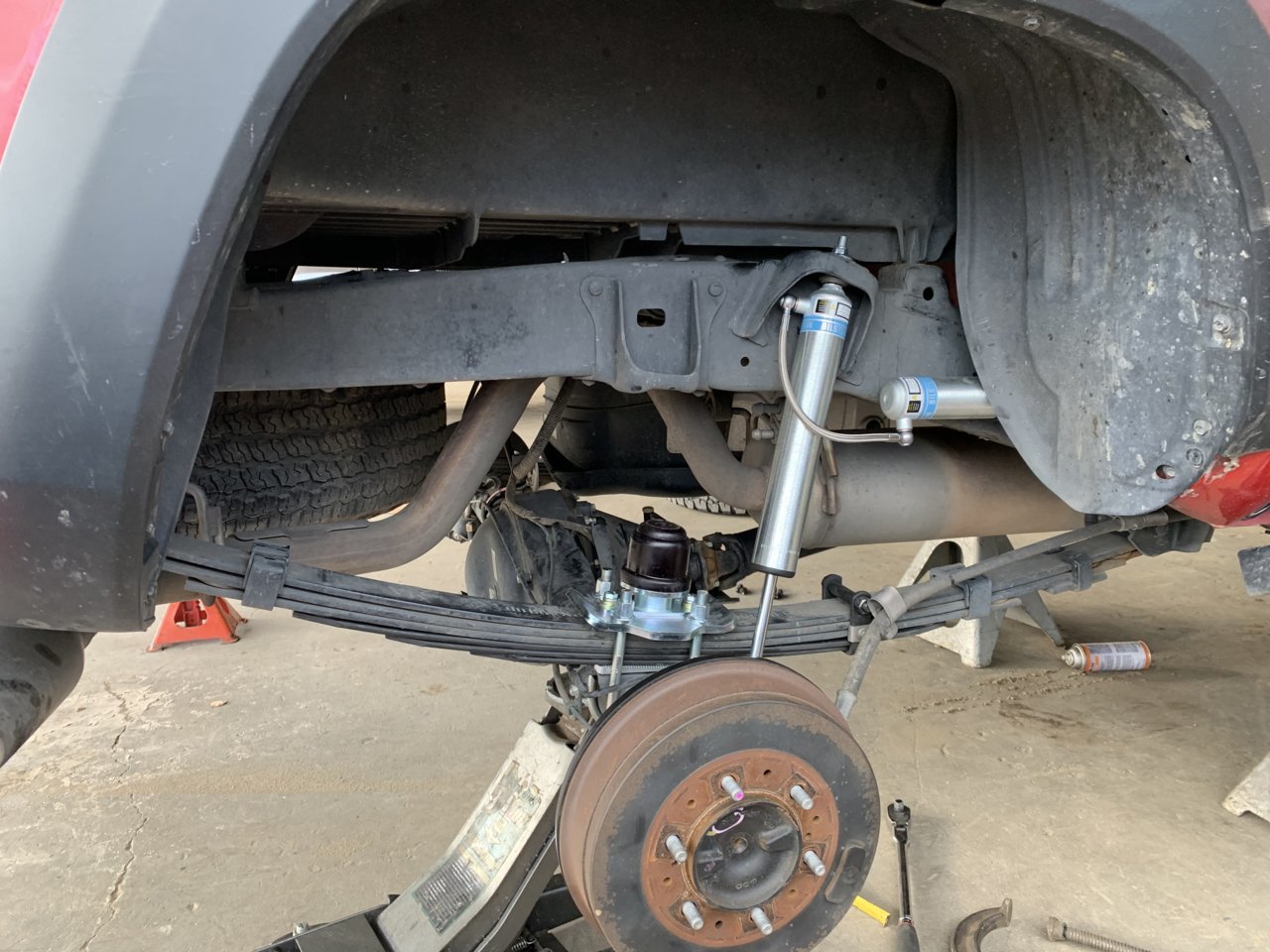

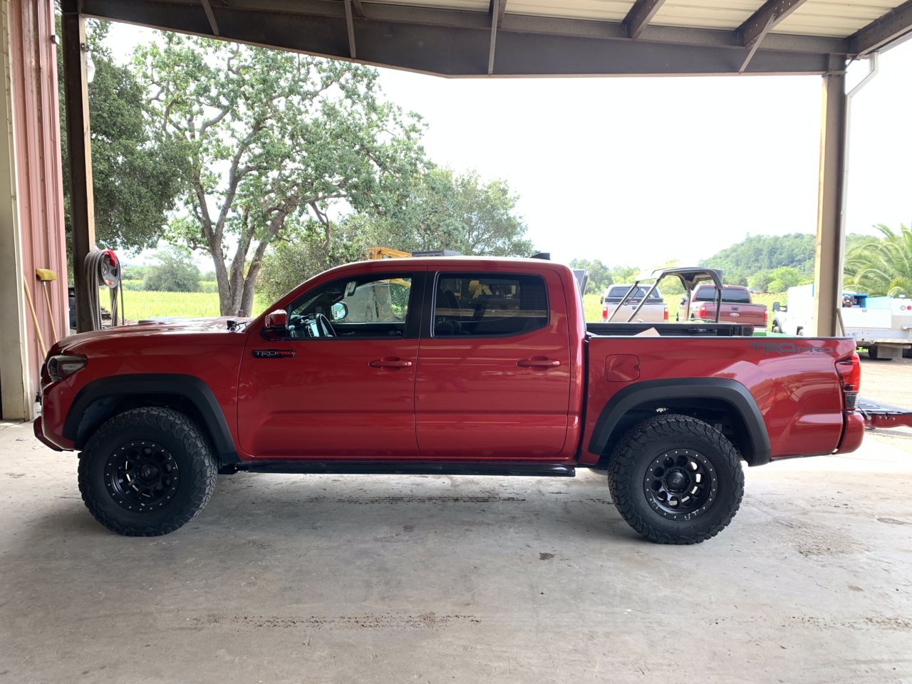

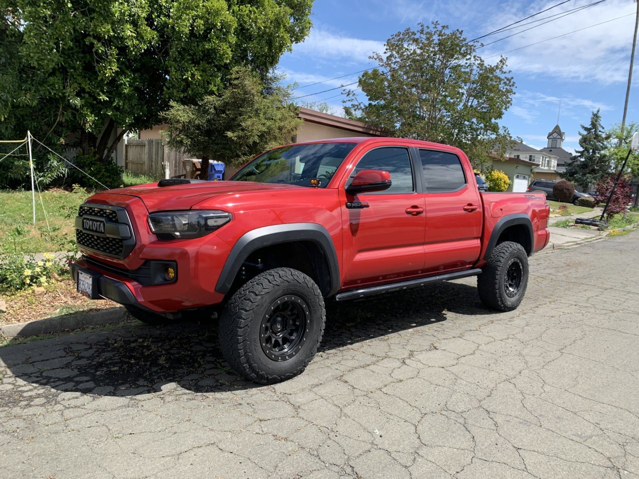

    I just installed Bilstein 6112/5160 combo and I’m super happy with it. On road driving and hitting bumps are a lot smoother. Not as expensive as Kings/fox and they preform well. It is also my DD.
    Heres the specs
    Front:
    Bilstien 6112
    5/6 setting
    Total chaos UCA
    Superbump bump stop
    ECGS bushing
    Sway bar removed
    Rear:
    Bilstein 5160
    U-bolt flip
    superbump
    OME cattier bearing drop
    3* axle shims
    Headstrong 3 AAL
    if you’re looking to save some money.
    UCA are recommended above 2” lift but some have gotten away with keeping the stock one.
    Superbump bump stop. You can keep the stock front and rear.
    ECGS bushing. Recommended but not needed. Some report vibration after they lift so I just replaced mine with I was there.
    3* axle shims and carrier bearing drop. Recommended but not needed. Again, people have reported vibration after lift.
    1F13564A-82E7-411B-8D9C-8DD8EBDAE28E.jpg D76DD6E2-B344-4F78-B245-D52721A09CE2.jpg 3E0B2D12-3B6F-4A9A-B98D-F0AEA2B2EFD8.jpg 443C31D0-2C57-4372-AEB4-52B43CC7789B.jpg 11A36F54-3598-4F31-8717-D7D0FD46BE9B.jpg
