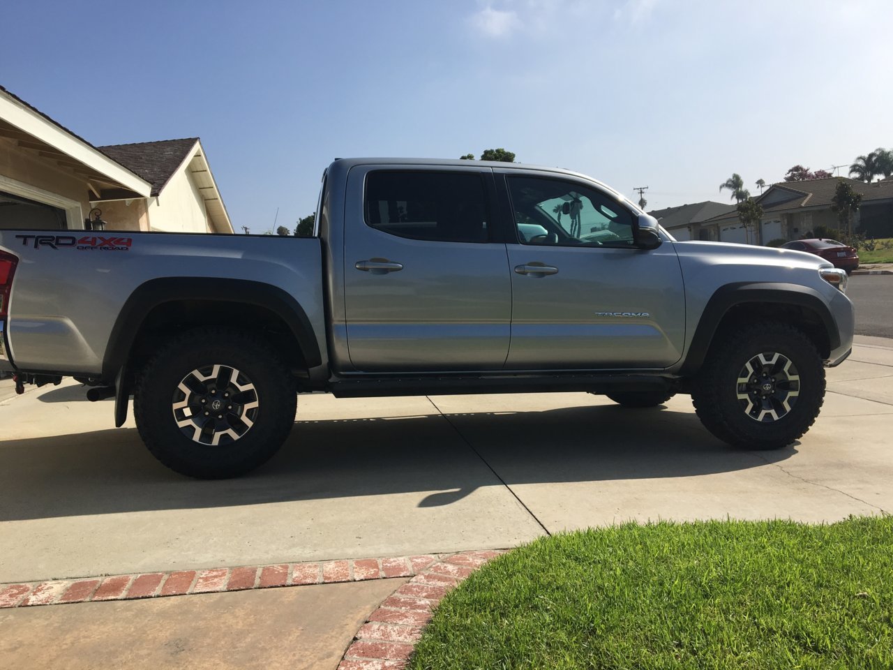

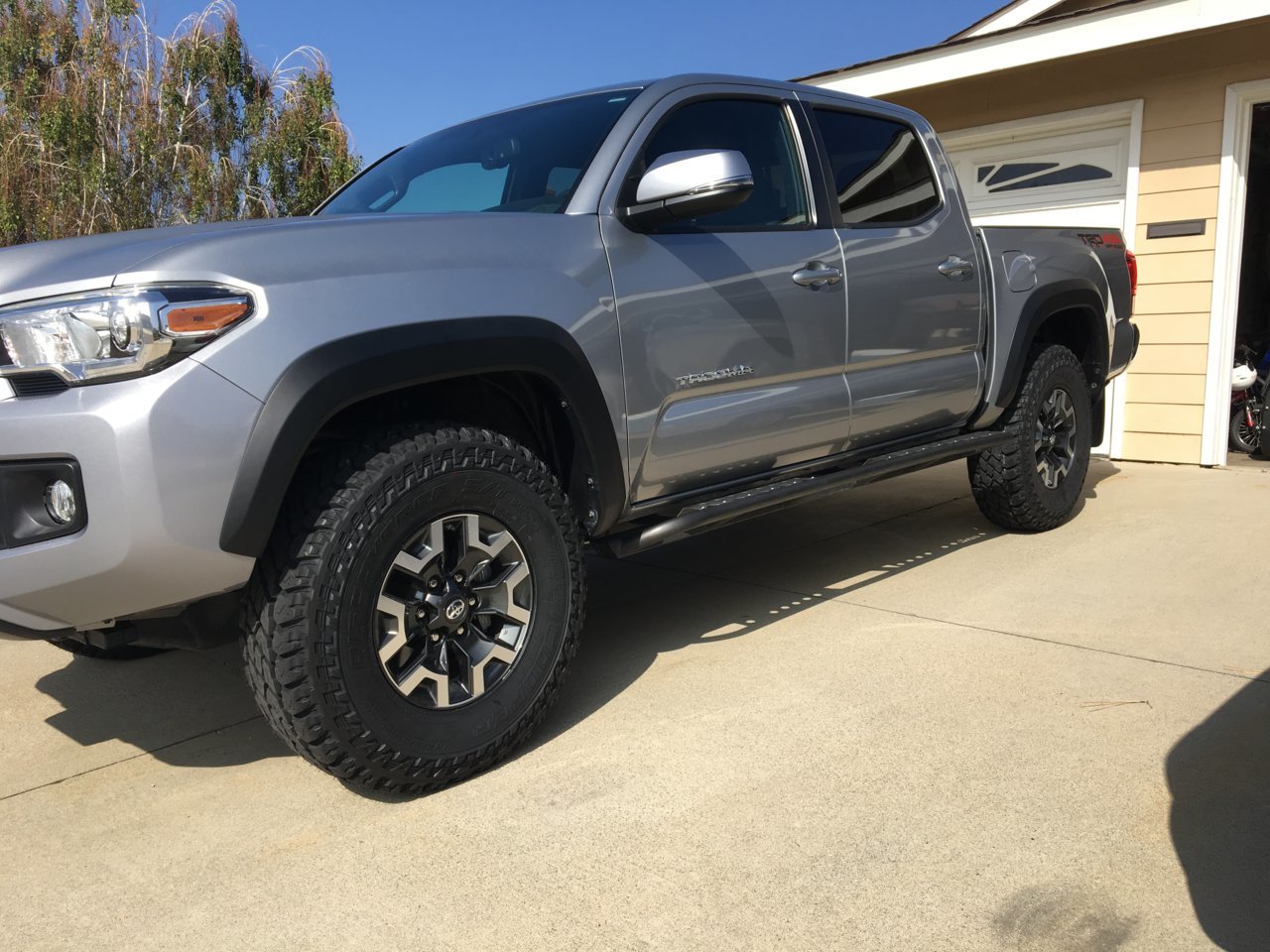

    Older thread I know, but if anyone is still wondering what the largest tire in terms of height that you can run on stock 3rd gen TRD pro or Off Road, that would be 255/85/16 they are 33s (32.9) as long as you have a 3rd Gen Tacoma AND are mounting to the stock 16 in wheel. These tires fit perfectly with the Offset of that wheel. Any wider tire, different wheel offset, or 1st or 2nd gen Tacoma, and you may start rubbing. A lot of people have reported the same and I for one can say from experience as of this week. Just installed some Cooper Discoverer ST Maxx 255/85/16s with no rubbing on full tuck... donuts for days.

  18. Sep 13, 2018 at 10:47 PM
    #18
    Hemlocktherm78
    Hemlocktherm78 Well-Known Member
    Jan 4, 2018
    #240267
    518
    front mud flaps had to come off?
  19. Sep 14, 2018 at 7:58 AM
    #19
    D-CM
    D-CM Well-Known Member
    May 14, 2018
    #253512
    59
    2017 Tacoma TRD OR DCSB
    Rock sliders
    Honestly, I’m not sure because I removed the front mud flaps when I put on my rock sliders. I’ll probably remove the rear ones at some point too for added clearance when off road. My opinion though is that you could probably leave the front mud flaps on and be okay since I believe the flaps extend down on the same contour as the fender and don’t extend inward toward the tire.
