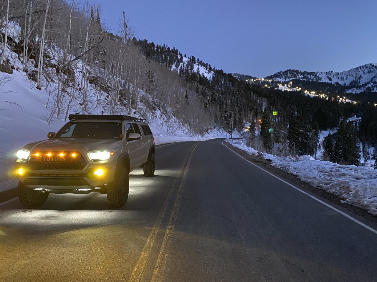

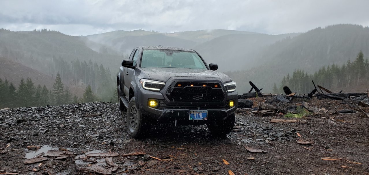

    I have DD SS3 Sport ambers and they're pretty dope.

    ss3 pro

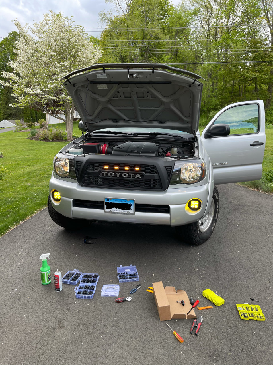

    06158FBB-24F8-41D2-961C-2A3D256E1D87.jpg SS3 fogs and new headlights installed today. Diode Dynamics FTW.
