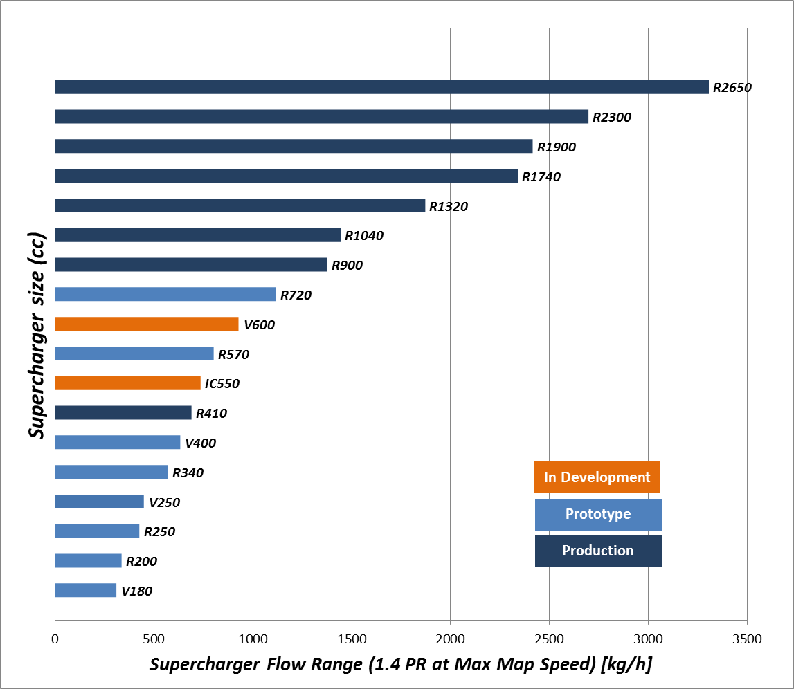

    This will be big, I have been waiting for a boosted option for this truck.
    This is a root type positive displacement supercharger so it basically build boost instantly and hold through the rev range.
    It also uses the new TVS rotors which are the most efficient supercharger and much better than the 2nd gen supercharger.
    If it is a 1900 that is really over kill, a 1900 can produce over 600HP.
    V6 usually get a 1320 capable of 350-450 RW HP.

    Magnuson booth shows expected power gains of 30%.
    Stock truck dynos around 240whp, that puts you roughly 310whp.
