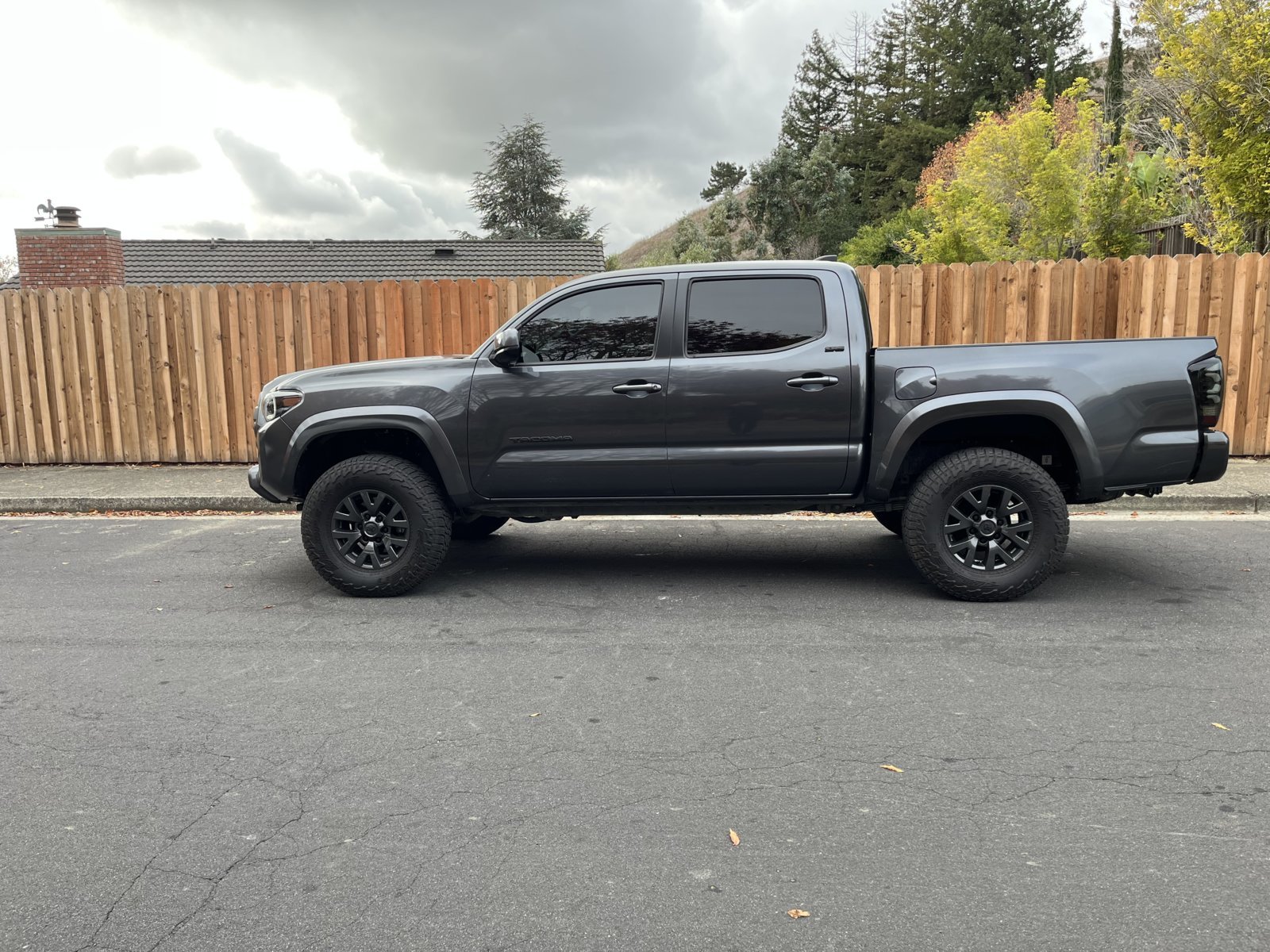

    Trail edition has a taller coil in the front, (1.1 in) and a small rear block in the back (1/2in)
    For your off-road you can do as simple as a half inch strut spacer in the front which will give 1 inch or lift and the half inch oem block in the back. This is my truck with that setup:IMG_1815.jpg 1/2 inch spacers aren’t going to change your ride or cause any major problems. But some refuse to put any type of spacers so in that case I’d just do billstein 5100s all around set to the third setting up front (1.1in) and the half inch rear block.
