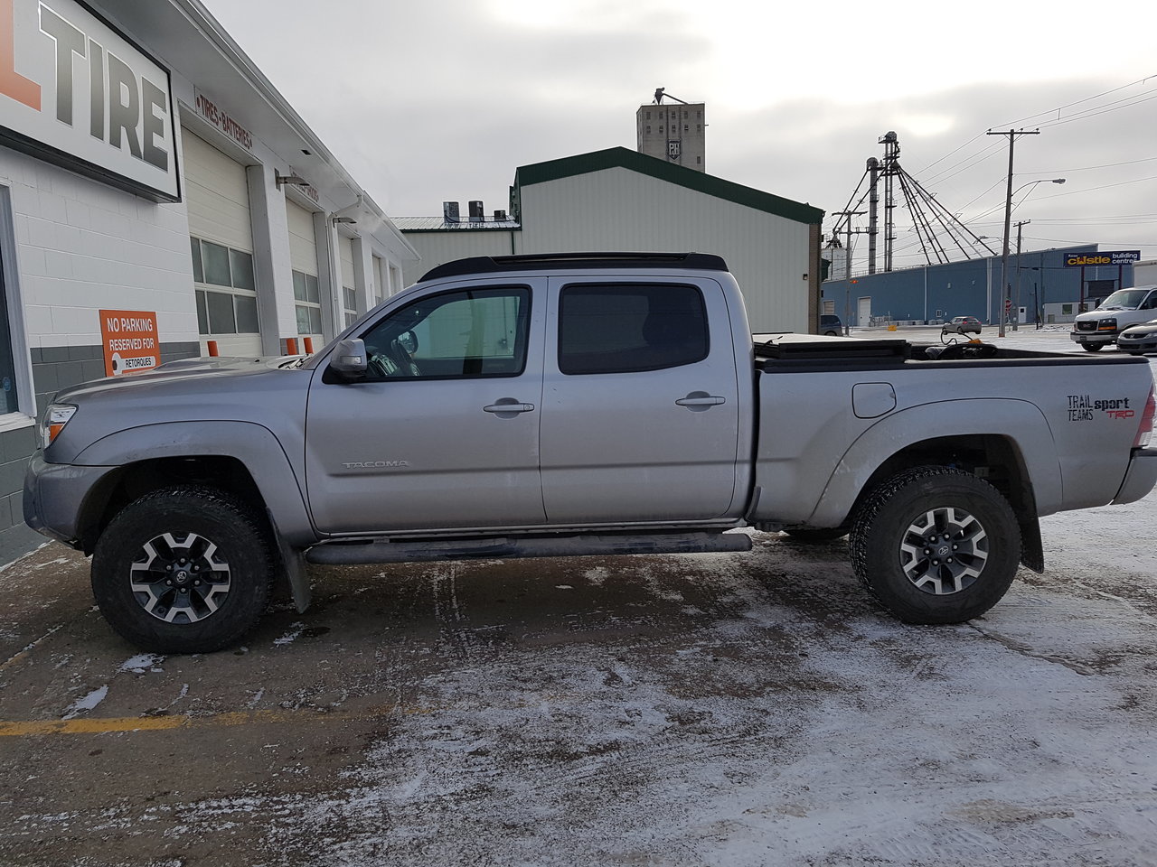

    Got the spacers and add a leaf from wheelers offroad . Worked like a charm. Add a leaf adds 1 1/2" onto existing leaf pack . Read up on them as not everyone agrees they are a good solution. I thought the ride was fine . My 2 cents
