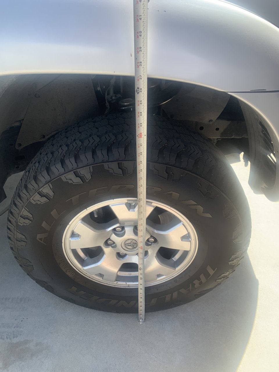

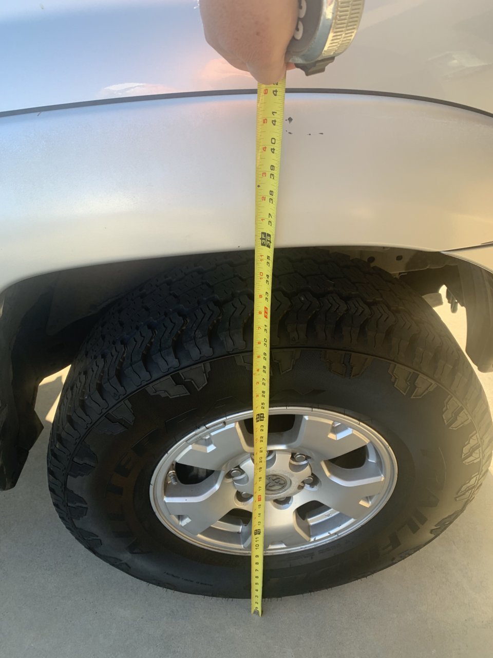

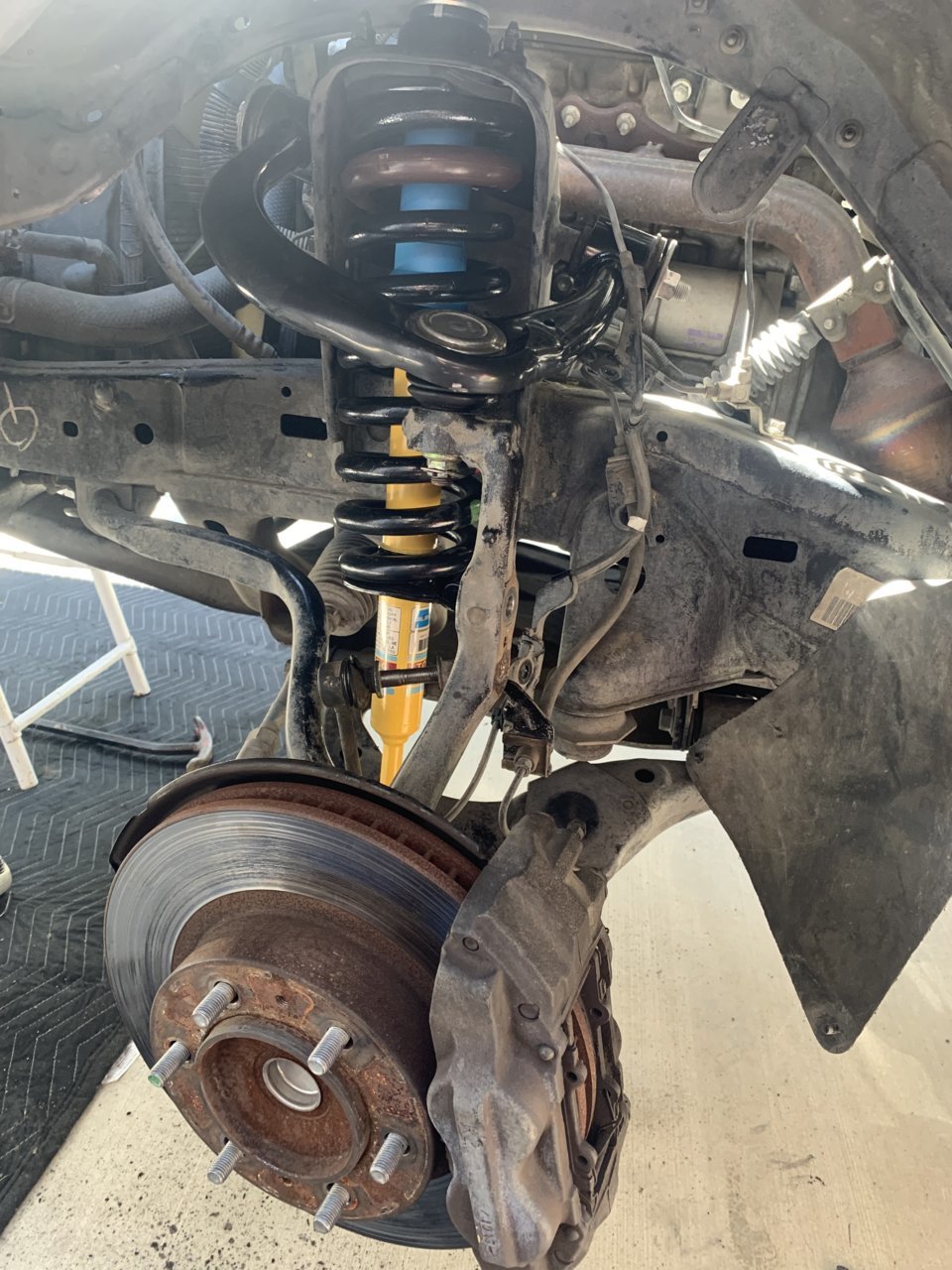

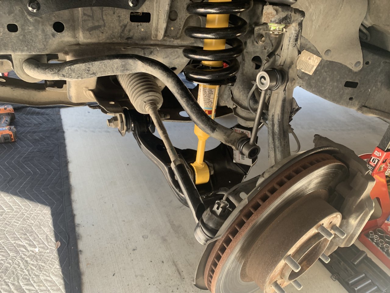

    just did this to my 06 PreRunner a couple of weeks ago. 3rd gen front shocks & springs, UCAs, and rear shocks. Got new LCAs from McGeorge Toyota and sway bar end links and tie rod ends from Autozone. Easy project overall. 7D50A734-6F8E-4E0D-BF78-49175C271D8C.jpg
    Passenger Front height with 16 year old stuff
    New stuff installed
