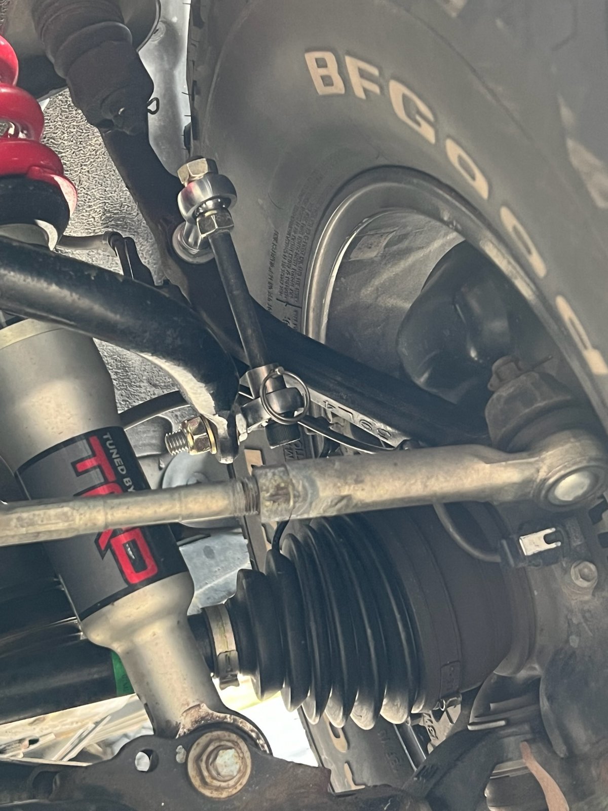

    I finally got mine installed. Did it while installing my Eibach TRD Pro Spring/Block kit. I'm hoping to actually use these unpinned a few times during the upcoming summer. They will most likely be pinned for the majority of the time as my 2017 Pro is my DD. I'll report back if I run into any issues. I will say that these links fit much better with sway bar drop (basically drops the sway bar and pushes it forward a bit). I think the vendor designed them to work with a re-positioned sway bar. The drop kits are cheap and super easy to install. Picture of drop and the links installed...
