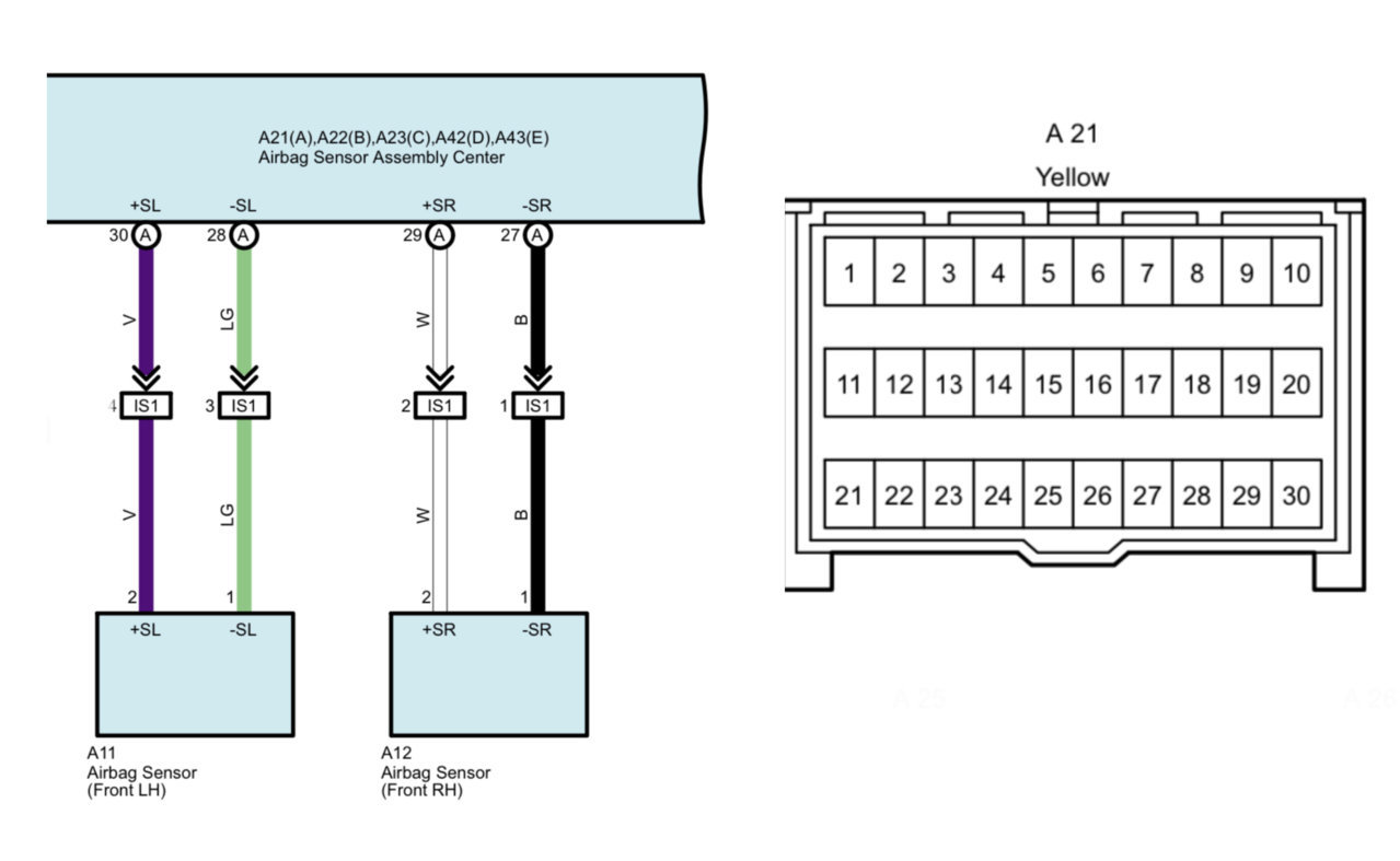

    Long story short I had a front end collision and both front impact sensors are not communicating with the airbag ECU. White wire from right side impact sensor and green wire from left have a short. Looking at the socket that plugs to the ECU I just don't know which ones are they since there are 3 identical blacks and 3 greens‍♂️‍♂️‍♂️
    Anyone know where I can get the workshop manual of a picture of the airbag wiring diagram?

    Best I can do is from a 2019.
    The colors seem to match according to your post above.
    The connector is labeled as if it were unplugged.
