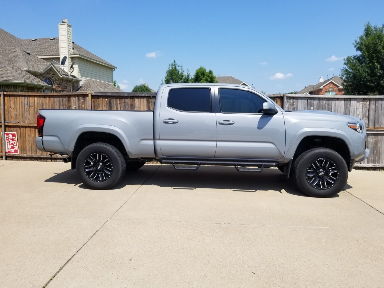

    I have an 2018 Tacoma DCLB - TRD sport. Because of the long bed configuration, the height didn't look right so I installed a Low Range Offroad lift kit, (3" front, 2" back). I also changed out the wheels/tires, (275/65/18).
    I really like how the truck looks with these changes but the ride is much stiffer for my taste. I am guessing because it is a TRD sport and the fact that I installed the block lift kit, (cheap way for a newbie).
    My questions for you experts is what is the best, reasonable way to make this truck more comfortable to drive. I forgot how a TRD Off-road rides but I drove an SR5 lately and I am ok with that level of comfort. Of course, more than that wouldn't hurt. I am comfortable with spending about $1k or more if needed.

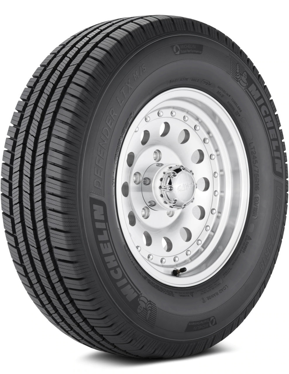

    I have no clue on how to check the rated version of the tire. I don't see SL nor E on the tire marking.
    This is what I have:
    MichelinDefender LTX M/S
    https://www.discounttire.com/buy-tires/michelin-defender-ltx-m-s

    If they are LT "E" rated than it will say LT right before the tire size on the tire.
