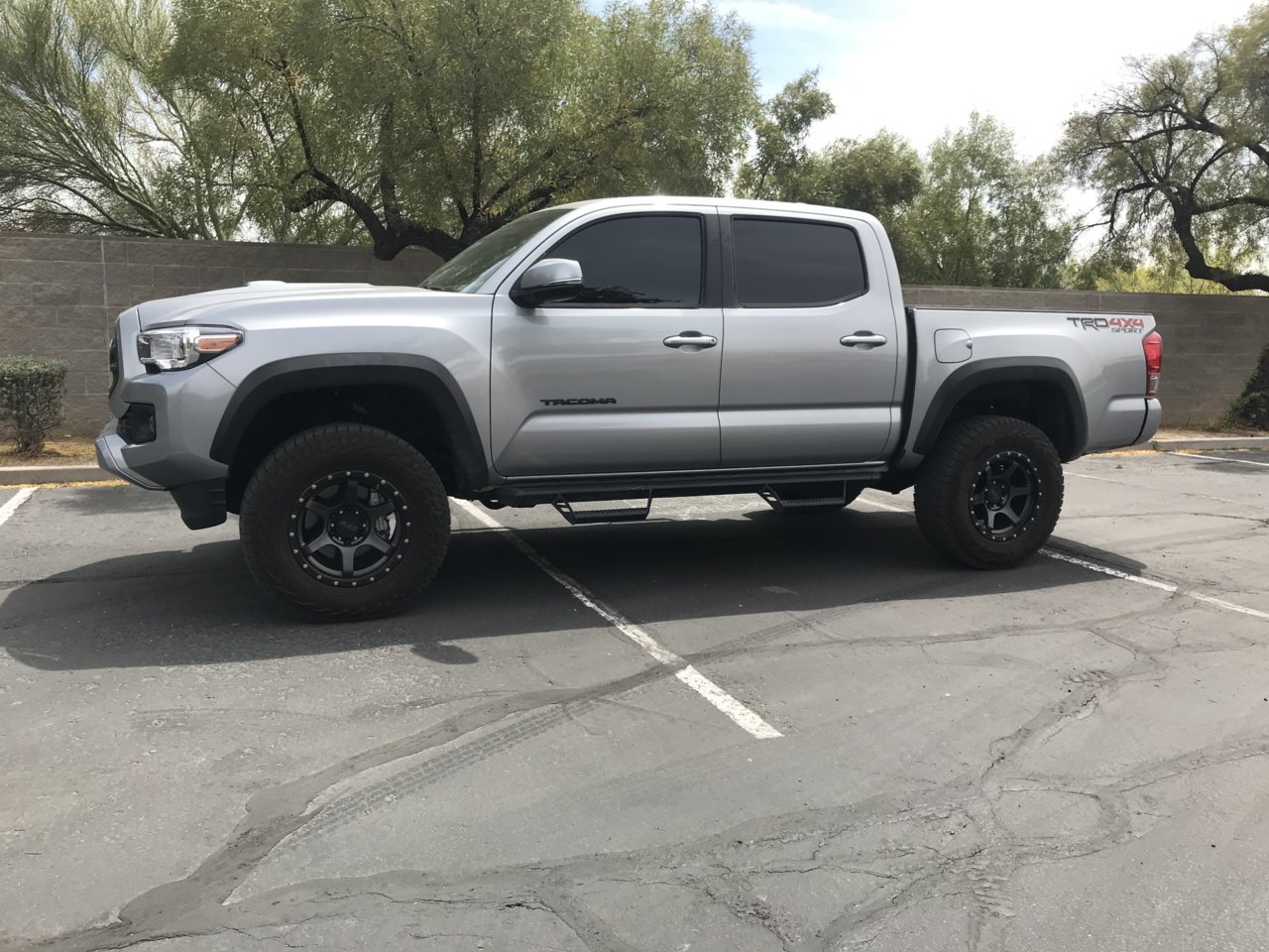

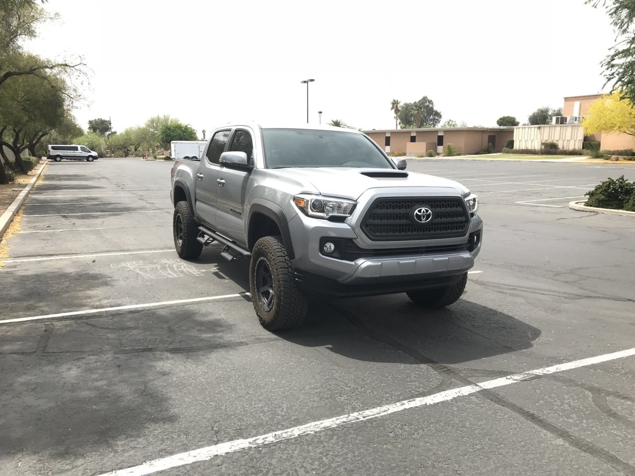

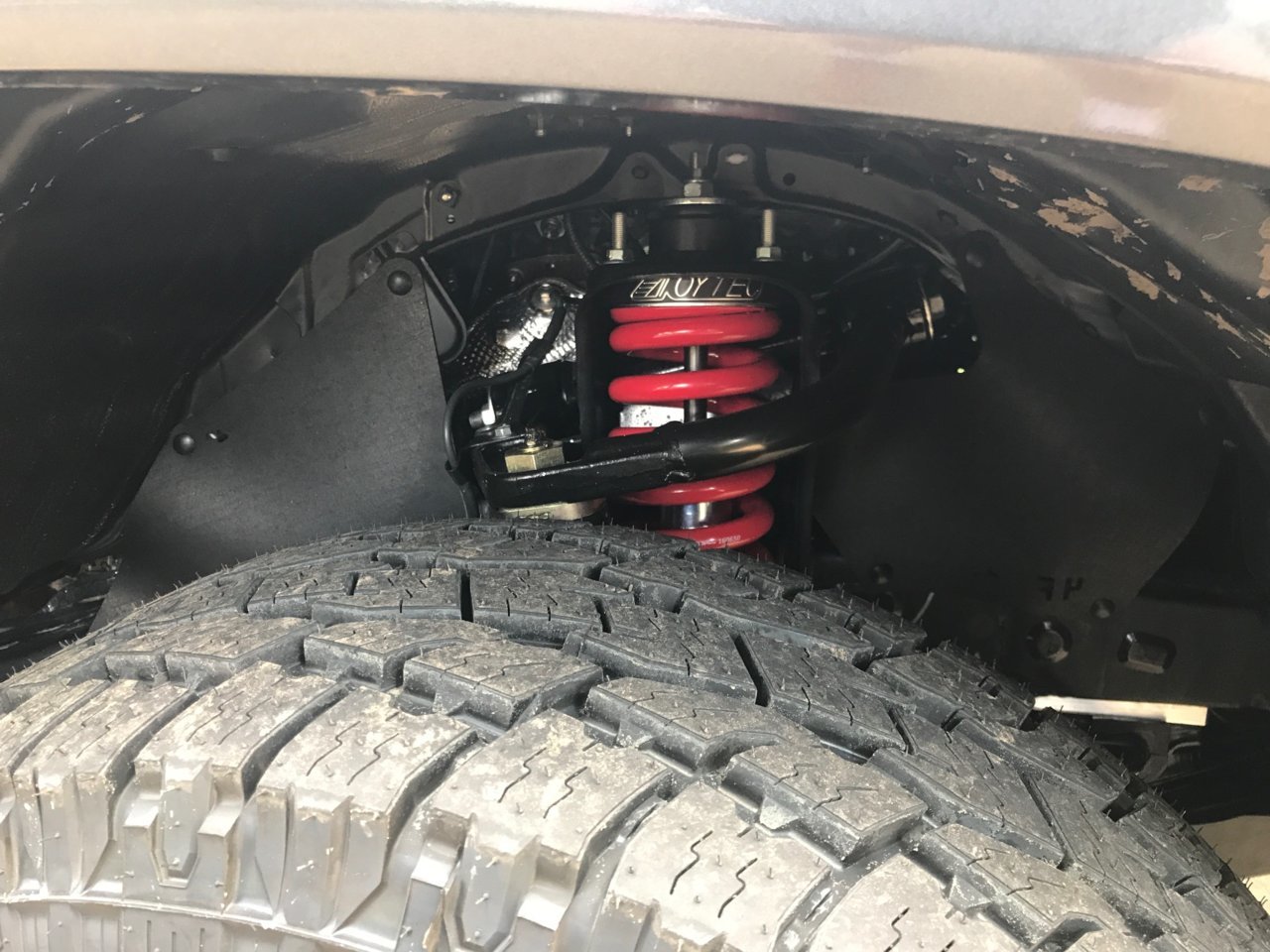

    1A4B3A58-D074-4DCF-B551-C4CFE36AB405.jpg 111E47CA-E1EA-4253-849E-C0764DF7E12C.jpg F0BB4ACB-1F46-4288-9DBE-9FF03DF055E3.jpg I went with the OME kit with 887s and a headstrong AAL in the rear. 2” and no issues. Did not do the needle bearing. I think it’s the perfect stance without having to go up to 33” tires, but you can still stuff them in there though if you want.

    Stock. No alignment issues; would have been iffy if I went up to 2.5”.
