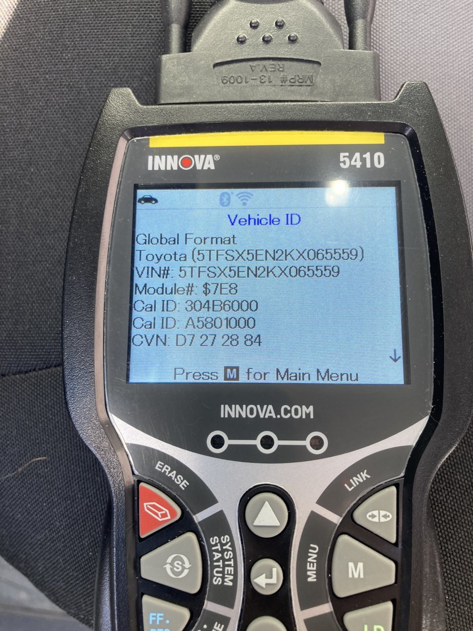

    I pulled this from mine, anything here of any value.

    Heck yeah!
    Thanks!
    ECU ID List so far:
    -- 2016 AT: 04A21 **
    -- 2017 AT: 04A22 **
    -- 20xx xx: 04A90 ** - supported but unknown
    -- 2019 AT: 04B60
    -- 20xx AT: 04B70 ** - supported but unknown
    ** Supported in vF.

    Which number is of value. Asking for a friend :anonymous:

    Hahaha! The upper number: 304B6000 shortened to 04B60. Typically, five characters are the shorthand for our ECU IDs, but some Toyotas use a couple more digits which can cramp my brain.
    For example, my ECU ID is 04B14 for a 2017 3.5l MT on the latest TSB. Unfortunately (or thankfully?), there has not been a powertrain TSB for the 3rd Gen 2.7l. I feel that there should be one to address the AT shifting, but I guess Toyota doesn't.

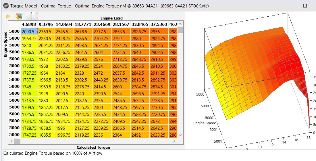

    Ha! I was showing that to my wife earlier. I told her that I found a glitch/mistake.
    We are also missing a torque map that we had in earlier versions of vftuner.

    @PapaRee I figure either he pasted the maps wrong, or the exhaust/intake labels are wrong (in which case its harmless, but I'm not touching it till I know which is correct)

    I also noticed that the one torque map in there has 5000 rpm all the way down the map for engine speed. ECU will get confused with so many different values for one rpm.

    Just heard back from Mat, he's fixing the 04A22 maps, both the 5000 y-axis tables on torque and the VVT maps. Turns out, it's the 04A22 maps that are incorrect (which is what I was comparing the new maps to) that were wrong. The 04A21, 04B70 and 04A90 maps are fine.

    While you have his ear, make sure he puts back the Optimal transmission torque demand map. That whole section is not there (since 1.5)

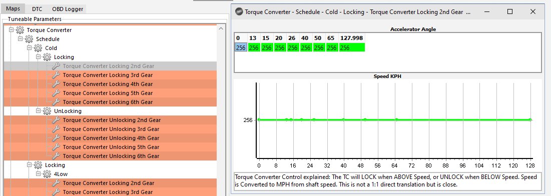

    You may not realize it, but with the stock tune, the throttle input and the actual throttle opening are not directly correlated. After around 30% throttle input, the actual throttle opening is kept between 90 and 100% open, and the variable that keeps the power output correlated to throttle position is the transmission gear ratio/torque converter status. Basically any time you're over 2000 rpm, the actual throttle opening is very nearly completely open. This is not the case with cruise control however. When cruise control is turned on, the transmission is more willing to downshift before reaching nearly 100% throttle position. It's strange that the transmission operates so differently when cruise is on vs off.
    I agree, I wish it was possible to lock the transmission in a given gear, and if it slows down, it just slows down. I also wish it was possible to lock the torque converter in 2nd and 3rd gear under load. My '20 2.7 has yet to lock the converter in 2nd, and it only locks the converter in 3rd when engine braking.

    Locking in 2nd can be done. As is, it is set to be Unlocked Stock:
