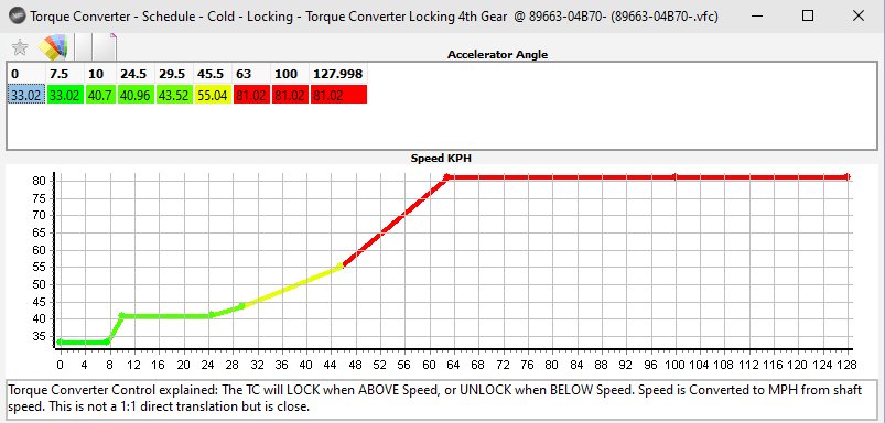

    Alright, what I gotta do to get it so that my '20 2.7 will lock the converter in 2nd and 3rd?

    The map for 3rd gear is the same.
    You'll need to experiment with those values. 256 is the max. Drop those down until the TC Locks at that throttle levels that you want. 0 would Lock at 0 torque and would likely be bad bananas, so don't go that low. Likely compare to the 4th gear map as a starting point.

    The y axis looks like speed, so what is the x axis exactly?

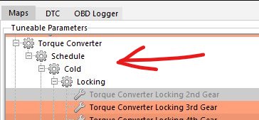

    How do I even access this to change it?

    Close. :D The X (horizontal) is speed in KPH. See the label at the top of the map.
    The Y is a torque scale that doesn't correlate to a physical number. Just a factor to work with. 256 is unlimited / max torque. 0 is no torque.
    So, if you bump the 256s down, it will allow locking at some point. As noted, the 4th gear map is a starting point if you don't want to blatantly guess.
    To get there, just open the Stock Tune in vF navigate to this part of the Map List and start checking things out:
    Note that you will want to back up files, not overwrite them, so that you can go back to a last known tune if things don't work out.

    I thought the 33 and 81 were suspicious because 33 is the lowest speed the torque converter locks in 4th, and 81 is the highest speed it locks in 4th (under a decent load, at least, I think it will lock as early as 24 or 25 MPH in 4th if there is a very small load), but those figures are in MPH, not KPH.
    If what you're saying is correct, the region above the line should be "lock" zone, and the region below the line should be the "unlock" zone?

    There could be a correlation there? I am no expert with the AT maps. Just drop some nuggets that I know.
    Correct. See the Notes at the bottom of the Map.

    Let's say I wanted the torque converter to be locked in 2nd gear starting at 30 kph, and unlocked before then. Could I set everything before 30 kph to 256 (which should prevent locking) and everything after 30 kph set to 0 (which should guarantee locking?)

    Sort of, but I'd use 30 or so instead of zero as the TC needs to Unlock to shift. I think it won't feel good if you use 0.
