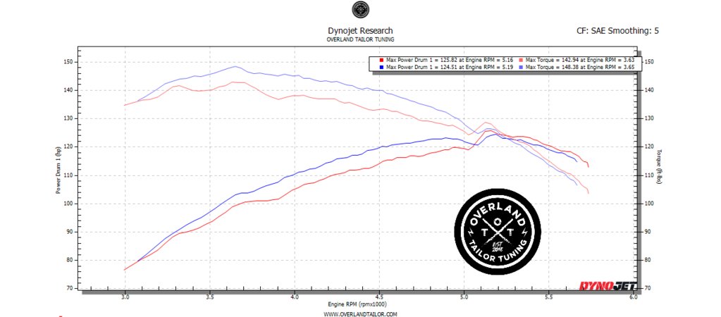

    Our focus was to extract what power was available from this engine when specifically used with 87 Octane fuel (Regular) while retaining the adaptive octane capabilities built into the OEM Toyota strategy. Allowing the owner to run the fuel they wish. Premium will allow the ECU to continue to advance ignition timing in specific areas to enhance economy and response and improve output slightly. We also specifically addressed the pedal/throttle mapping to allow for a more direct and engaging driving experience with multiple options available for both Normal and "ECT" modes, allowing you to tailor the characteristics of your vehicle to your needs/style. The tune also includes a TCU calibration, which remaps the shift schedules. In short, it's a full calibration that addresses many of the platform's shortfalls. It, however, will not turn your 2TR-FE 4cyl into something it's not, so realistic expectations should be maintained.
    Regarding what's possible with the 2TR-FE tuning vs the 2GR-FKS, the truth is the 3.5 has gotten more attention, as there are a "million" more of them. The 2.7L's are much less abundant, and the number of people seeking to improve them is even smaller, so naturally, the development is not the same. However, we've not given up on developing this platform, and we have a potential update coming that would further improve high load/WOT output. We need more time to find a test vehicle and return a truck to the dyno. On that note, here's what our calibration will do on 87 Octane over the factory calibration:

    I have tried about every tune out there and OTT is the way to go, again as JustDSM stated the 2tr has a ceiling. A tune can only do much, i wouldnt say i would feel any power increase from the tune just better driveability. The tune takes a slow, delayed pedal response, erratic shifting vehicle. To a slightly less slow, smooth, predictable, the way it should have been out of the box. Pedal response, transmission shifts and overall smoothness of the engine is what you notice. The added support to tweak the alternator an agm battery is a nice bonus. I always tell people if i was starting over and just purchased a 3rd gen does not matter what engine a tune would be the absolute first thing i did. Also we are hoping early next year VF releases the additional tools requested to squeeze a little more out of this engine. Justin and the team over at OTT are the only tuner out there that gives time and attention to this engine platform, give it a shot you wont be disappointed.
