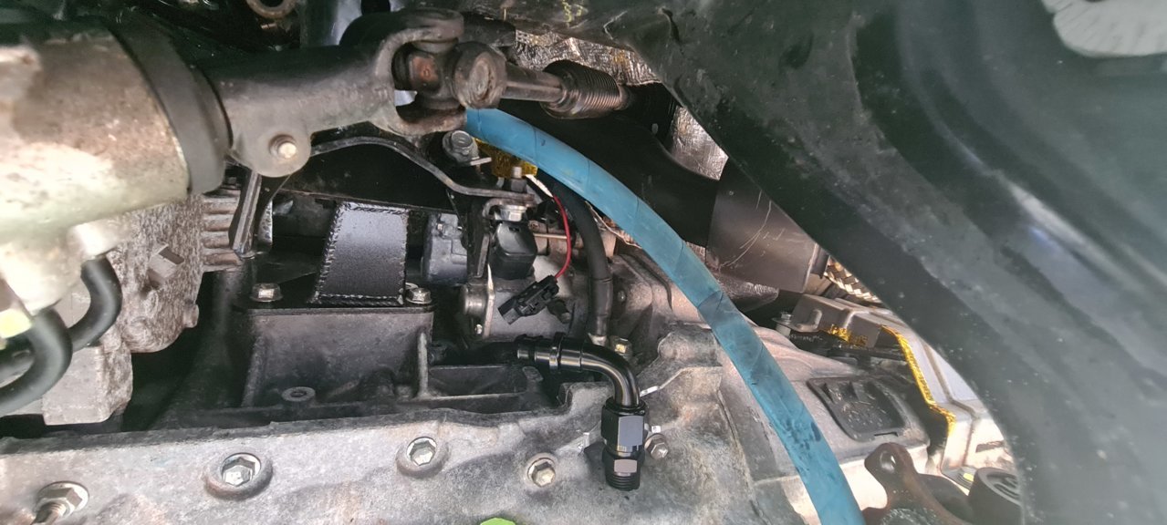

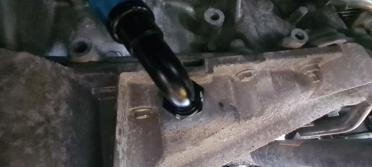

    Turbo Oil Drain Relocation
    Parts Needed:
    Small handheld drill (I used a Dewalt XR 20V and it BARELY fit, so the shorter the drill the better)
    23/32 Drill Bit
    1/2 NPT Tap
    2x: 1/2 NPT - 10AN Adapter (or equivalent)
    2x: 10AN 90 degree hose ends (I recommend Push Lock style if using the blue textile hose)
    2x: 1/8 NPT - 4AN Turbo feed adapter
    Thread Sealant
    Toyota FIPG sealant.
    Brake Cleaner (A few cans of this are recommended - It will be used to flush metal shavings so high pressure is best)
    Clean 5w30 Oil and Filter
    New 75w85 GL-5 Gear Oil (only if 4WD)
    The provided oil pan has 2 ports to allow oil from the Turbo oil drains to return to the pan. The problem with this setup is that the ports sit well below the top of the oil level, which means that 8-10 inches of your drain (or more) are ALWAYS filled with oil. This means that your lines will back up with oil until it starts to push out of the turbo's seals and gets burnt off in the exhaust. The way this has been handled is to restrict the oil to the turbos.
    These Garrett turbos have Journal Bearings, which means restricting oil to them actually prevents the bearings from functioning correctly, since they rely on oil volume to create a fluid barrier between metal surfaces. Now you could argue that even restricted, they get enough oil, and honestly, maybe that is a good enough answer for you, but quite frankly it's not a good situation to put your turbos in and could seriously reduce the life of your turbo. Not only that, but even restricted, I could still smell oil burning.
    First off let's talk terminology. The 2GR-FKS is a modular engine that ingeniously allows an easy adaptation between different platforms via modular casings. This truck has 2 oil pans. In fact, let's just stop calling them pans, because they really aren't. There is an "Upper Sump" and a "Lower Sump" which could also be called an access cover.
    The oil level, when the engine is not running, sits almost at the top of the upper sump. This picture shows the Lower Sump removed and is looking up into the upper sump. You can see the upper dot on the dip stick which sits just inside the Upper Sump.
    Here is an external demonstration of the difference. The upper line is about where the oil level sits with the engine off, the lower line is where the current drain ports are (obviously).
    Now let's be clear, this is a DAUNTING task. You will be drilling into your engine. Screw this up and you have to pull your engine out and replace the Upper Sump. I don't believe there is clearance to remove it in the truck. Additionally because you are drilling it while it's on the engine, you are introducing non-ferrous metal shavings into your engine. This is a pain to get out and you MUST be very very thorough getting them all out. I spent more time trying to get all the shavings then I did anything else.
    Alright, to start, if you are 2WD, lucky you, 80% of the work is already done. If you are 4WD, sorry, but that front differential carrier has to come out. So start there. I'm not going to go in detail, but here is what you need to do:
    • Remove Front Wheels and Skid Plate (if equipped)
    • Drain Front Differential Carrier
    • Remove Front Axles LINK (Check out some youtube videos. You don't need to do half of what the manual says, just start at #5. Hardest part is getting past the C-Clip in the differential. Heavy hammer, solid hit. If you need to hit it more than once, you aren't hitting it hard enough.)
    • Mark the Front Driveshaft where it bolts to the front differential. The mark is an alignment mark so should be on the driveshaft flange and the differential flange.
    • Unbolt the Front Driveshaft from the front differential only LINK (hint, this is a 9/16 bolt, not metric. Thank you Spicer.... Toyota was nice enough to engineer a hole into the lower frame that you can stick a wrench through to put on the backside of the bolts. Just pull the driveshaft rearwards and slide it over to rest on the frame.upload_2022-8-22_15-54-57.jpg
    • Disconnect the breather hoses from the Front Diff
    • Disconnect the wire harnesses from the diff controller and sensor. Remove the harnesses from the brackets as well so they don't get caught when removing the diff.
    • Remove the Front Diff Carrier by removing the two front bolts and the rear allen nut. LINK (It's heavy and doesn't drop straight down. Lift to get the bolt out of the hole, rotate and turn while maneuvering it out. I recommend a 2 person lift.)
    • Move the diff well away from your workspace and put lint free rags into the axle holes just to be safe so no aluminum shavings get inside.
    Once the front diff is removed you should be here (2WD should already be here as well).
    • Drain your oil. This part is important. Drain it into a CLEAN pan. You want to save it for later. You are going to use this for something important.
    • Remove your lower sump. This is actually difficult if you already have the CNC lower sump installed. Find a spot with a lot of flange (I chose the driver side since there is hammer space) and very very carefully get a thin screwdriver between the pan and the engine. Be very careful not to damage the engine side. You will deform the metal, so just keep it minimal and to the outside of the flange. Once you get just the tip inside (quiet....) it should be easy to pop the seal.
    • You do not need to reuse this sump. If you haven't installed it yet, then you can opt to reuse your factory lower sump. It's easier. If you choose to reuse the CNC sump though since it does offer an extra quart of oil, be prepared to block the drain ports. If you already put 10AN bungs on it, just get 10AN caps like I did. Otherwise, you can tap the inside and put in some large NPT Allen Plugs. Choose your own adventure here. Just don't forget to block them. DON'T use rubber caps with clamps...they will rot and leave you without oil when you need it the most....
    • If your drains are the older metal style, I recommend you just trash them and switch out to actual drain hoses. The blue textile Push Lok hose that comes with the newer kits is GREAT hose. Mine was touching my catalytic converter and never melted or was damaged in any way.upload_2022-8-22_16-9-49.jpg

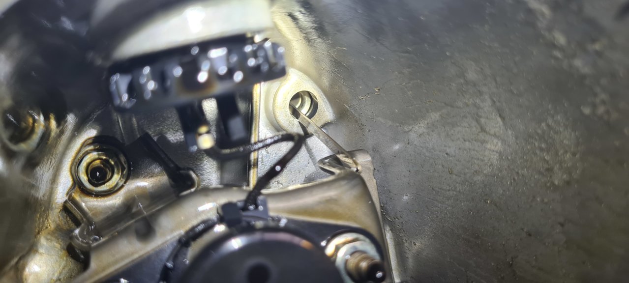

    • Locating the drains is a bit tricky, and you're going to have to gauge this yourself. There is PLENTY of room on the passenger side, but the driver side is tight. There is enough clearance though.

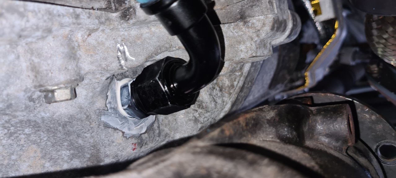

    Driver Side Hole: I highly recommend you do what I did and get a soft metal dremel bit (or equivalent) and grind away the aluminum ribbing above where this port goes. It'll allow you to mount the drain higher for additional clearance. The below picture shows only one rib cut. I came back later and cut both ribs up even higher to allow clearance for the actual hose end.
    Now I recommend you try to mimic this hole as much as possible. There is a rib literally at the bottom edge of my hole on the inside that you'll have to drill away a little bit if you go ANY lower. See below.

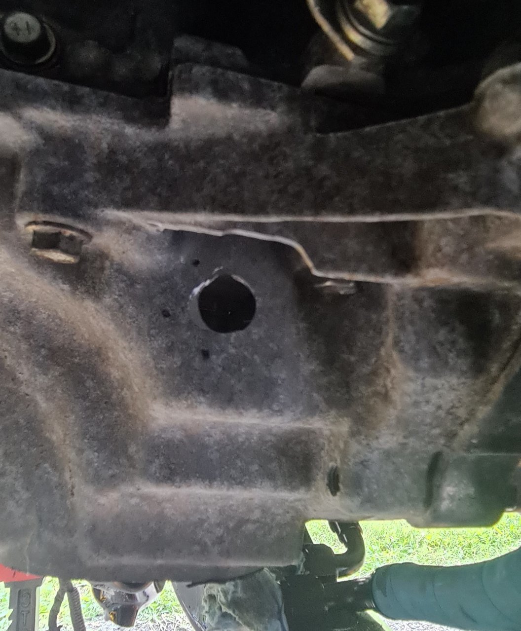

    Take the adapter and your hose end and put them up against your proposed hole to check upper clearance. Remember, measure 50 times and cut once. If all else fails though, you can go lower with your adapter, but remember, higher is better to keep it above your oil fill line. Below you can see the additional clearancing on those two ribs.

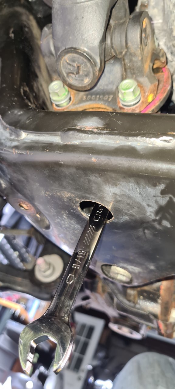

    For reference, here is how much clearance my fitting has with my front differential. It wasn't 100% tight, so maybe about 1/8"-1/4" less than you see, but still plenty. You could go almost to the bottom of that flat without impact.
    Tap this hole with the 1/2 NPT tap. DO NOT bottom out the tap or your fitting will bottom out before it seats properly. The Upper Sump is not perfectly vertical either. So when you are tapping try to keep the tap level or slightly angled upwards so your drain doesn't have to fight even a slight upwards bend to get into the pan. This will reduce the amount of threads your fitting will be able to use, so definitely don't tap to deep. Aim to get your fitting about 3/4 in when seated.
    Do not install anything at this point. Test fit things all you want, but do not install. Move on to the Passenger side.

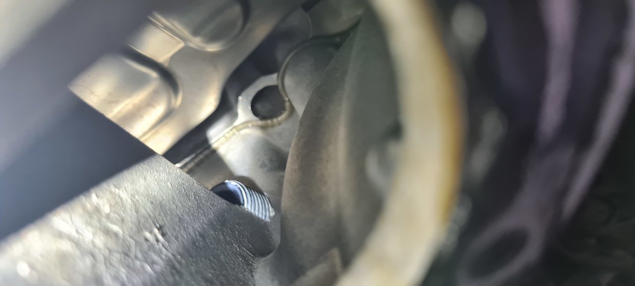

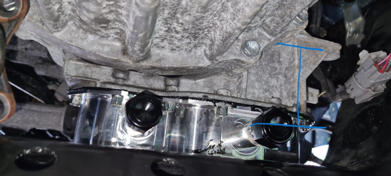

    Ok, I failed to get a picture of the Passenger hole, but here is where your fitting will get drilled. No clearance issues here, so just try to get it about here as high as your fitting will allow it. Again mock the adapter and hose end to ensure it has clearance all around. There is NOTHING on the other side, so there is no risk of damaging anything. The windage tray sits at the bottom of the block flange, so just keep your drill level and you'll be fine.
    This flat is located just beside the curvature on the sump. It's pretty easy to spot.
    Drill it out, tap it like you did the driver side. Don't install anything.

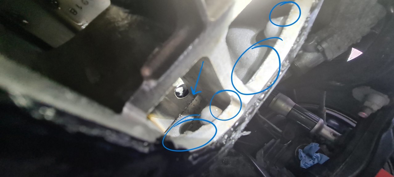

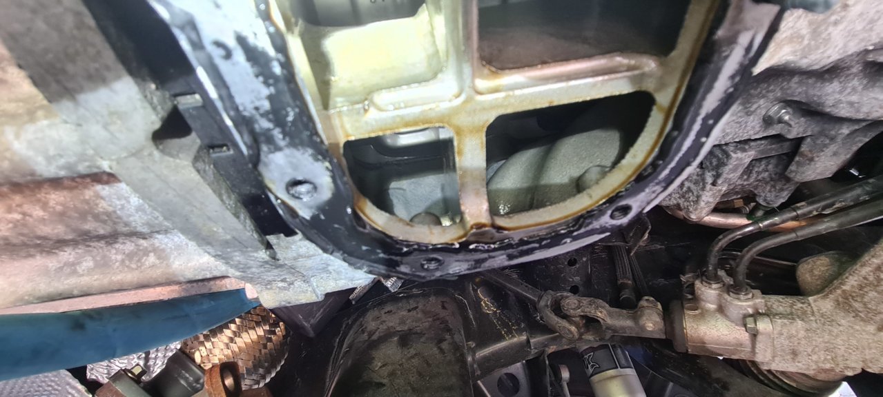

    Now the fun part. No matter what you did, you will have shavings all in your pan now. This part sucks. Spend A LOT of time on this. You'll think you are good, then you'll find more. Get your brake cleaner cans, a drain pan, and some eye pro. Spray every which angle/direction you can to try and force the shavings down and out the lower sump hole.
    The passenger side has a big flat spot under it that likes to catch all the shavings. This one is a pain. If you have small hands or a tool with a rag, you can try and scoop some of them out. Rely on your brake cleaner though to try and get it all. The driver side is easier, but has a bunch of ridges for them to get caught in. The metal shavings will get up near the flange so make sure to spray up into that spot. I sprayed in both holes as well in a 360 manner to try and get anything loose out.
    Here are the ridges that they like to get caught on. I used a shop towel and a pencil to wipe some of the upper flats to the right of this picture. If you can get your tiny hands in there, then great. Make sure to swipe these ridges with your finger though and get all the caught shavings out. Liberally spray everything until no matter how hard you try you can't find a single shaving.
    Now in reality, any shavings will get trapped by the pickup screen and if not, by the oil filter. A couple tiny ones may not be a big deal, but a bunch are going to ruin your engine. Don't risk it. Be thorough.

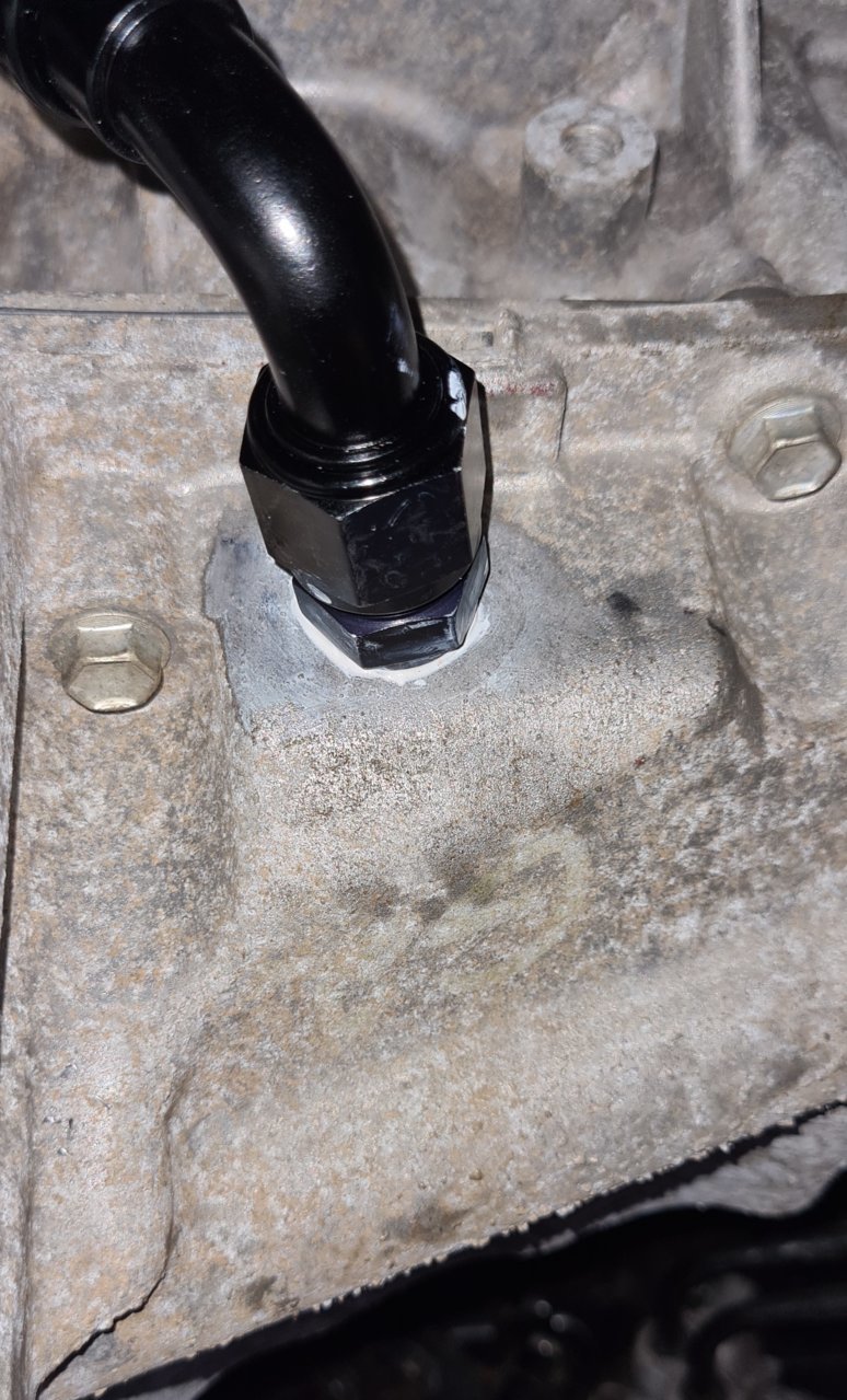

    Once you are happy with all that, go ahead and coat your fittings with thread sealant and install them until they are relatively snug. They are NPT fittings, so don't try and torque them or you'll crack your casing.

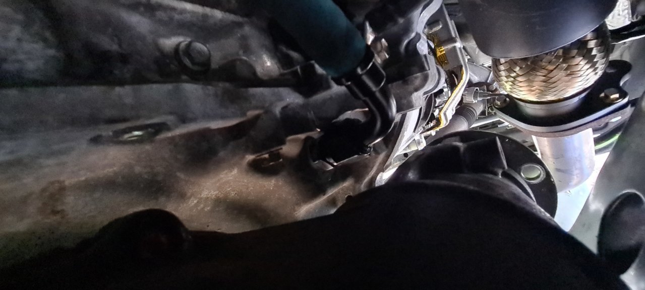

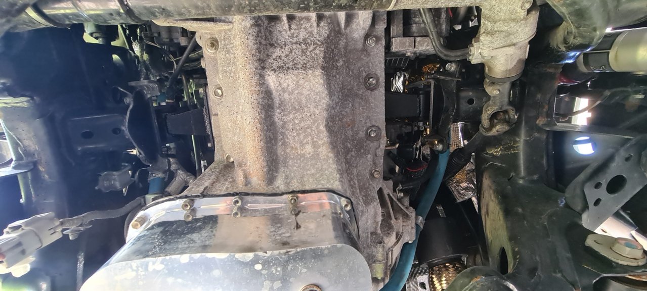

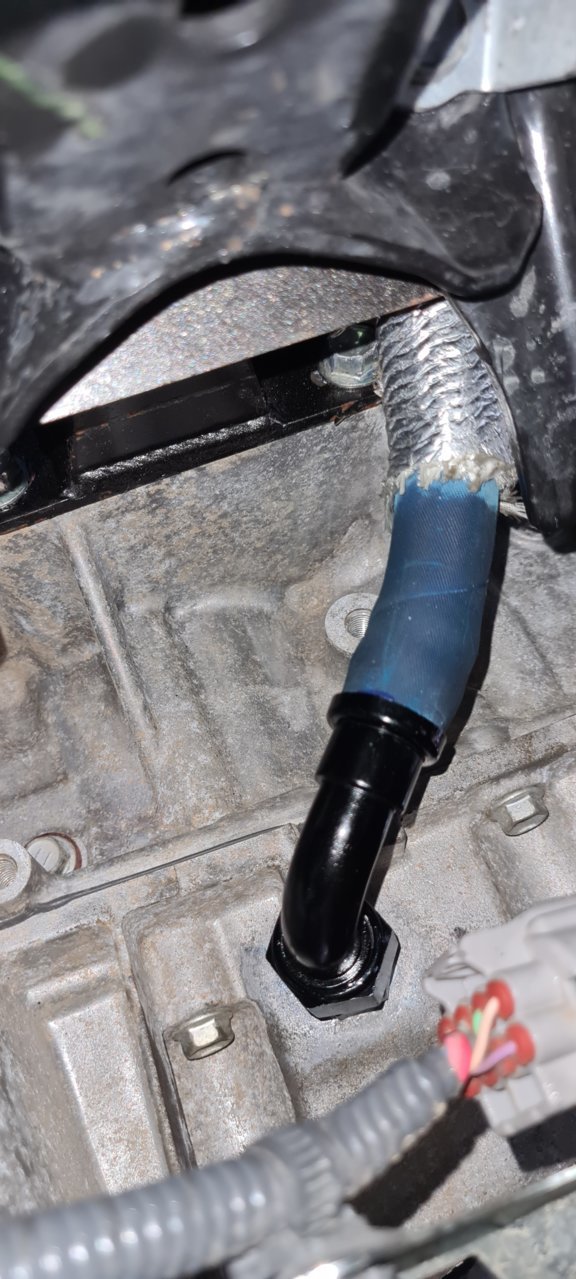

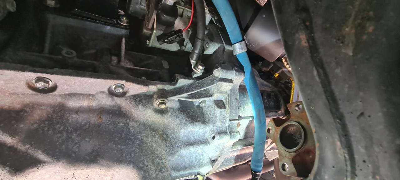

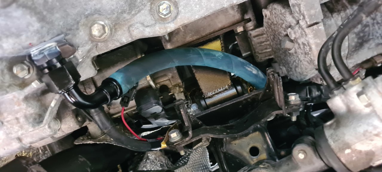

    Reroute your drains so they are in front of your motor mounts. This will give them a near vertical orientation to remove any possibility of oil getting caught up on bends. Install your hose ends and use them to mark your new hose length. Cut and install the hose to the hose ends. For Push Lok, do not use oil or heat. This compromises the hoses seal. Just spit on it. (that's what like 3 inuendos now?) Seriously lube it up with lots of spit and just get all your strength mustered and shove it in. Seriously it's tough but it's not impossible. If you already have the textile hoses, you can do all of this without ever having to remove the actual lines from the turbos.
    Your passenger side will be oriented slightly forward as shown here:
    Your Driver side should be relatively vertical with maybe a slight forward tilt. This is for clearance with the differential.
    Best part, your drains are now nowhere near your cats or your front driveshaft. Huzzah!
    Now take your sealed lower sump (CNC or factory) and put it on with a couple of bolts. Tight but not torqued.
    Remember all that oil you saved earlier? Pour it in the truck. All of it. Drain the oil again and drop the lower sump. You'll see some of the metal shavings you missed.
    Clean up everything and reinstall the lower sump using the Toyota FIPG sealant. Torque your lower sump on and the drain plug of course.
    Give that FIPG and the thread sealant a good day to cure properly. Fill the engine up with oil and a new filter. Reinstall your front differential carrier and everything else in reverse order. Good luck, that part is fun. Remember, 2 person lift.
    Once it's all buttoned up you have one last step. DON'T FORGET THIS.
    REMOVE THE OIL RESTRICTORS. You'll need to reinstall some new 1/8 NPT to 4AN adapters on the turbos for the oil feed. Make sure they are not restricted. This was the whole point.
    Now enjoy not burning oil.

    Stock.
    Btw, it's very possible to remove the lower oil pan without touching the front diff at all. I had to replace my oil pan, and I have 4wd. I had enough room to do everything I needed without touching the diff. I didn't have to mess with the upper pan, but I think its possible to at least take it loose and drop it some without touching the diff. I also took the time to install a fumoto drain valve in the new oil pan before I put the pan on the truck. It's been about a year with no problems so far.
