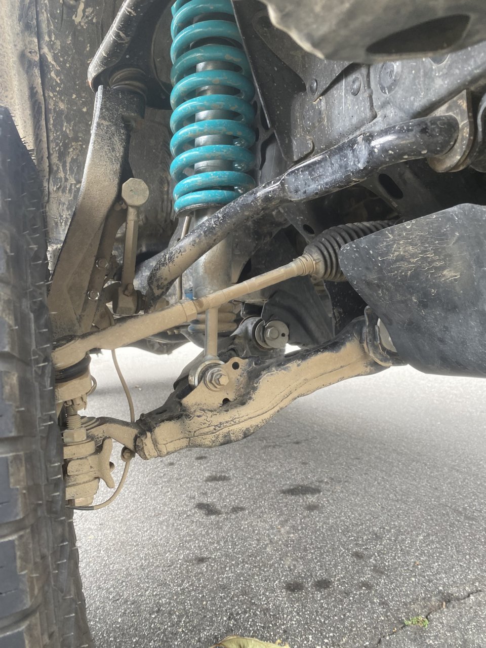

    I’d start by listing exactly what parts you bought and installed, you’ll probably get more help this way.
    4” is A LOT on independent suspension with drive axles.

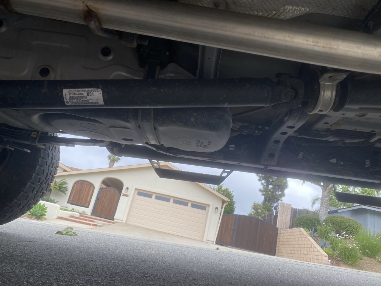

    IMG_2478.jpg IMG_2476.jpg I have 4 inche max trac spindles and 5100s with dobinsons on the front and old man dakars in the back with fox shocks giving me 2 inches.

    Oh it’s a 2WD. No diff to drop sir
    If you’ve got no vibrations, I would leave the driveshaft alone.

    I can feel slight rumble when I stop and go on a hill.

    Are you higher in the front? I think 4/3 is needed for a level look.

    Lowering your rear driveshaft center bearing and/or adding pinion angle shims should help a lot with the vibration. You probably won't be able to 100% eliminate it, but with some trial & error, you should be able to get it to where it's almost unnoticeable (and of no threat to your transmission).
