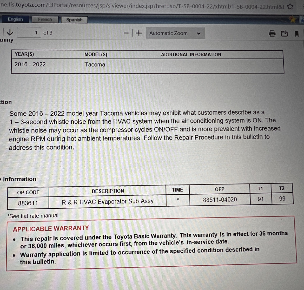

    FYI, Toyota finally admitted to the issue and a fix is available :woot:

    This is huge! Did you get it fixed? Also did they have to remove the dashboard to have it done?

    You are welcome!
    Haven’t gotten it done yet. It’s a full dash out fix though…not quick or easy.

    Do you have the instructions for the tsb?

    You need the new part from Toyota, then it’s just ripping the dash away to get to the hvac and swap it.

    Yeah, is anyone actually doing this? I get it a lot in my '21 2.7 but looking at the amount of teardown required, like removing the dashboard and crash bar, I am a little leery.

    *PDF attached as well*
    Intermittent Whistle Noise Through Vents With Air Conditioning ON
    Some 2016 – 2022 model year Tacoma vehicles may exhibit what customers describe as a 1 – 3-second whistle noise from the HVAC system when the air conditioning system is ON. The whistle noise may occur as the compressor cycles ON/OFF and is more prevalent with increased engine RPM during hot ambient temperatures. Follow the Repair Procedure in this bulletin to address this condition.
