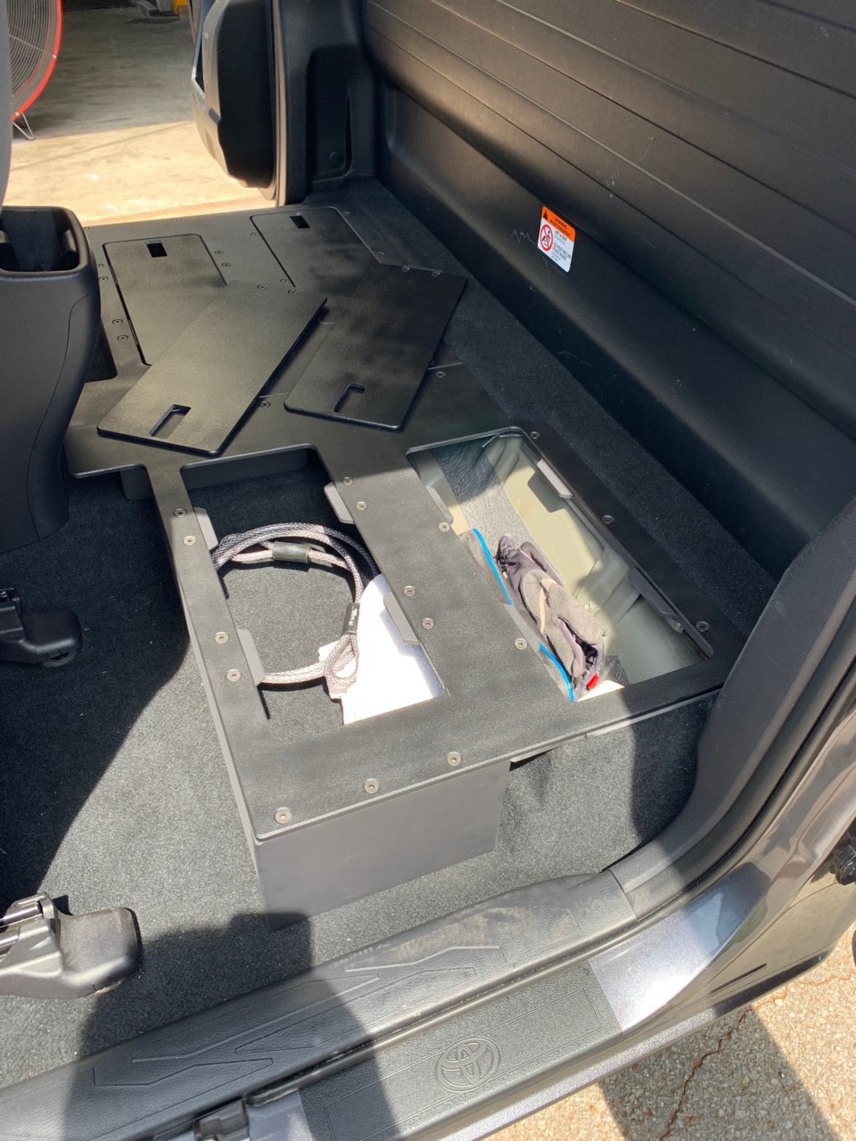

    I have a 2017 Tacoma SR Access Cab with the "Utility Package" so it came with no seats in the back of the cab. I found the factory plastic storage cubbies to be pretty useful but I was always annoyed that the already small space behind the front seats was on two different planes or levels.
    To fix that problem I designed this access cab platform that utilizes the factory storage bin and adds two more bins in front of that. Most importantly to me, it gives me a flat platform in the back of the cab so now boxes, luggage, coolers, etc. don't tip forward. I designed it to follow the lines along the back of the cab to make it look like it was intended to be in there from the factory.
    My family owns and operates a small CNC machining and fabrication company so I have been modifying my vehicles since I could drive! My first truck, a 1988 Toyota Pickup, had a custom front bumper and a flatbed that we designed and fabricated in house! Same goes for this platform for my 2017 Tacoma! Designed by me, all parts cut on our waterjet, bent on our brake and then coated, which I will cover more below.

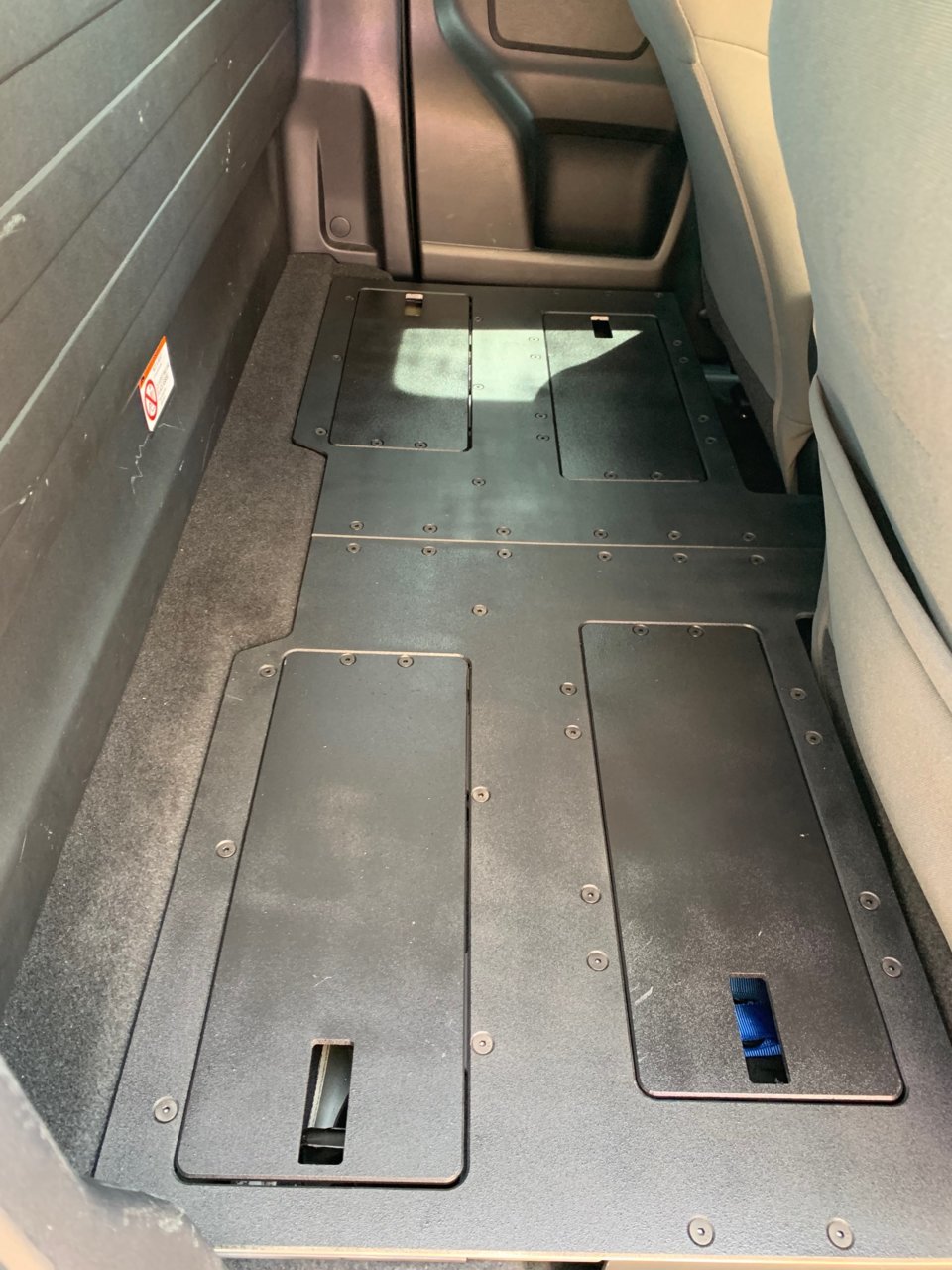

    The whole system is built out of aluminum (1/4" top/lids and 1/8" sides) and uses flat head fasteners so there is no snagging when sliding something across the top. The top of the platform and the lids are coated with truck bed liner to add a little texture/grip.

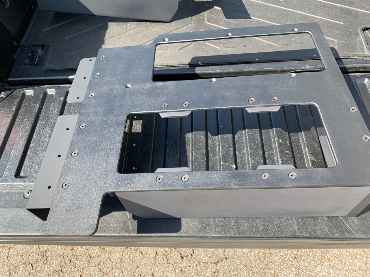

    This photo was from mocking up all the components right after they came off the waterjet and sheet metal brake

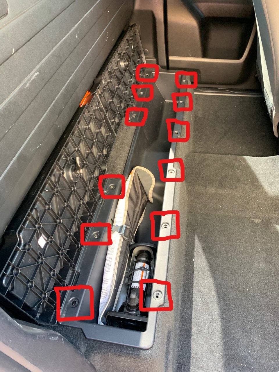

    As far as the install goes, its super straight forward (at least I think so :D). The rear plastic organizer is held in by 6 plastic clips, highlighted in red on the picture below.

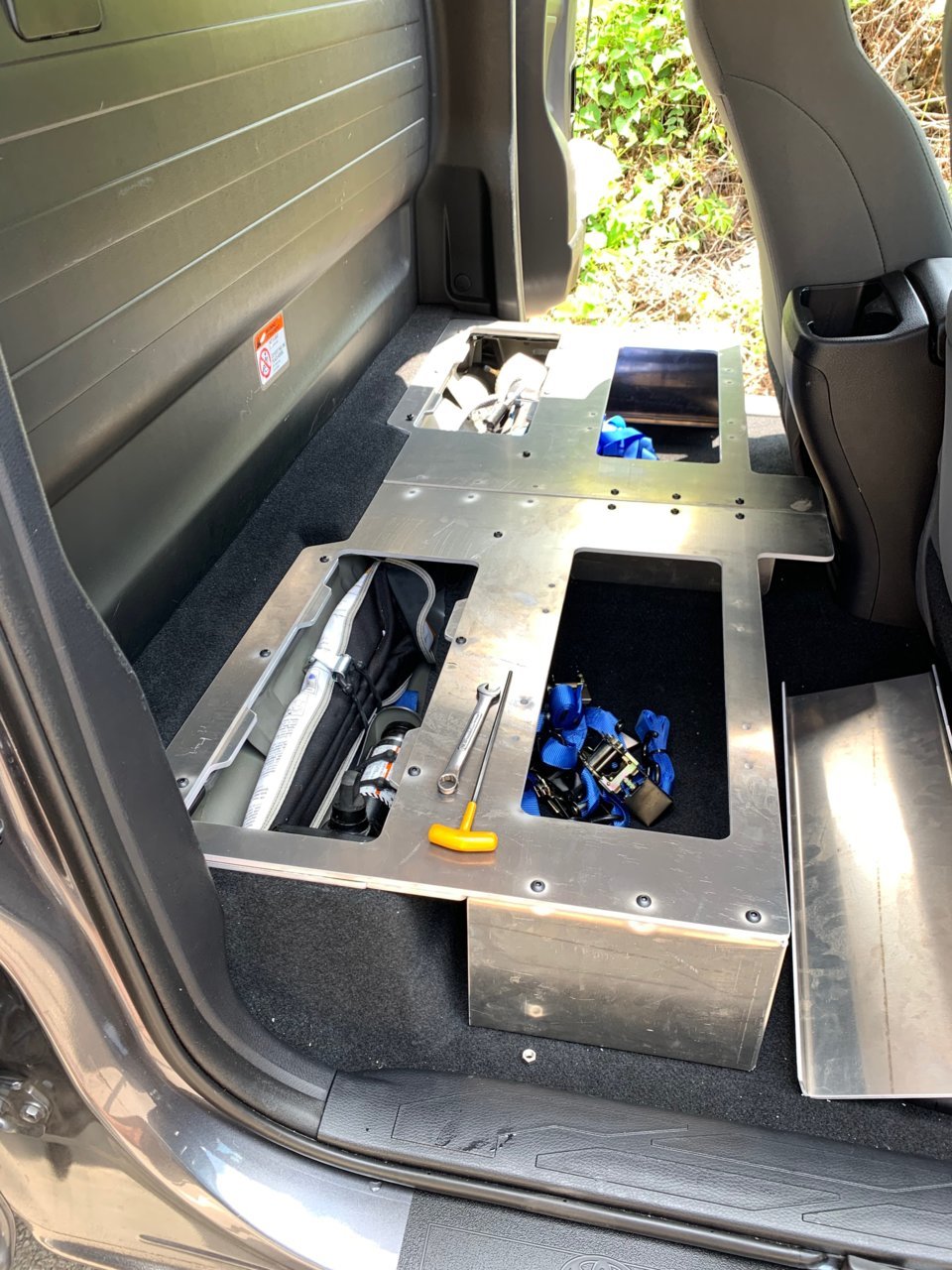

    Once the stock plastic organizer is out the fun can begin! I pre-assembled both halves of my aluminum platform outside of the truck for easy access to fasteners BUT we later found out you can fully assembly the platform outside the truck and it will still fit into place.

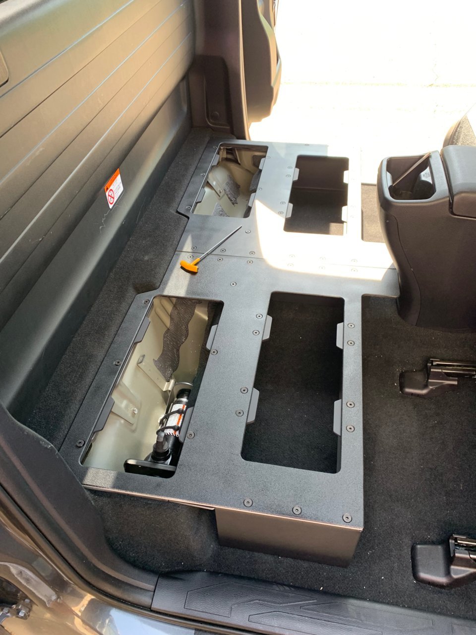

    On the drivers side I installed the center braces.

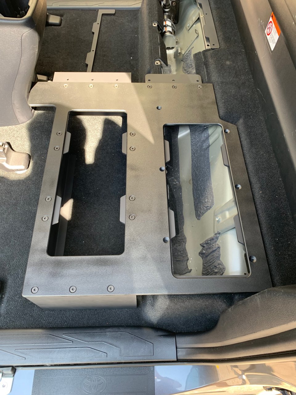

    With drivers side assembled and the center braces tightened down I put the platform into place in the cab. NOTE: There are two 1/4" thick aluminum pieces that go under the main platform. The large "L" shaped piece goes to the rear of the cab, aligning the holes with those that are in the chassis (where the plastic clips were taken out of) and the tang of the "L" facing the front of the cab. The other aluminum piece lines up with the front 3 holes of the sheet metal organizer (where the other plastic clips were taken out of).
    From here I put the passenger side in, with the 1/8" aluminum side and front panels already in place. Just like the drivers side there are two 1/4" thick aluminum pieces that line up with the holes where the stock tray was held in by plastic clips.
    On each side of the truck, on the rear rail, the 2 inner most holes that are used for mounting are a little too shallow to get a wrench or socket on a nut. Instead, an aluminum bar with threaded holes was used and this bar slides under the sheet metal rail.
    Pretty much from here drop in some flat head fasteners to the remaining holes, tighten down and its good to go!

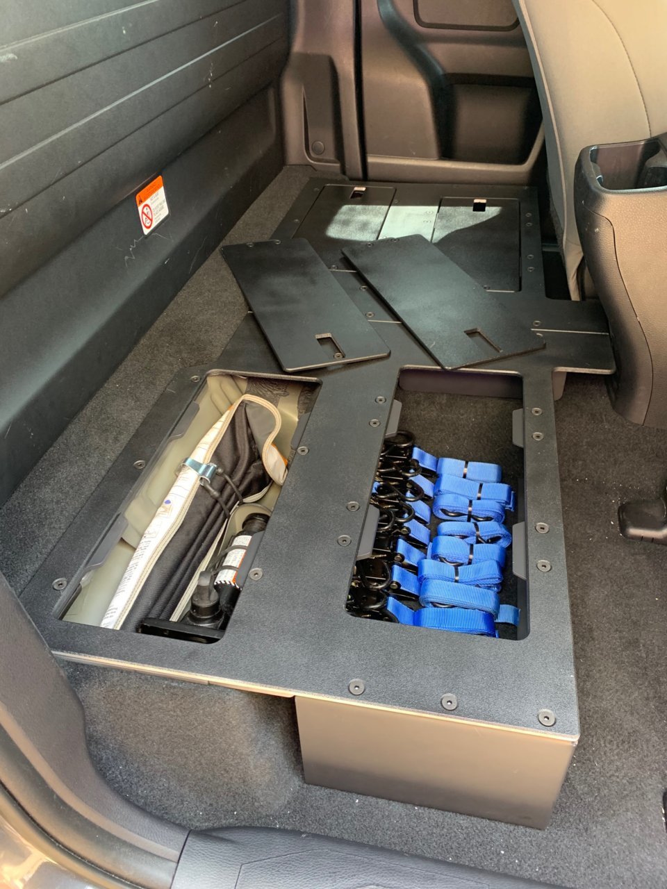

    Unfortunately my latches haven't arrived yet, but I will update when they get here! They will be flush mounted and locking. This will give me 4 locking bins in the back of my truck. With the front two bins having front and side panels it is pretty secure.

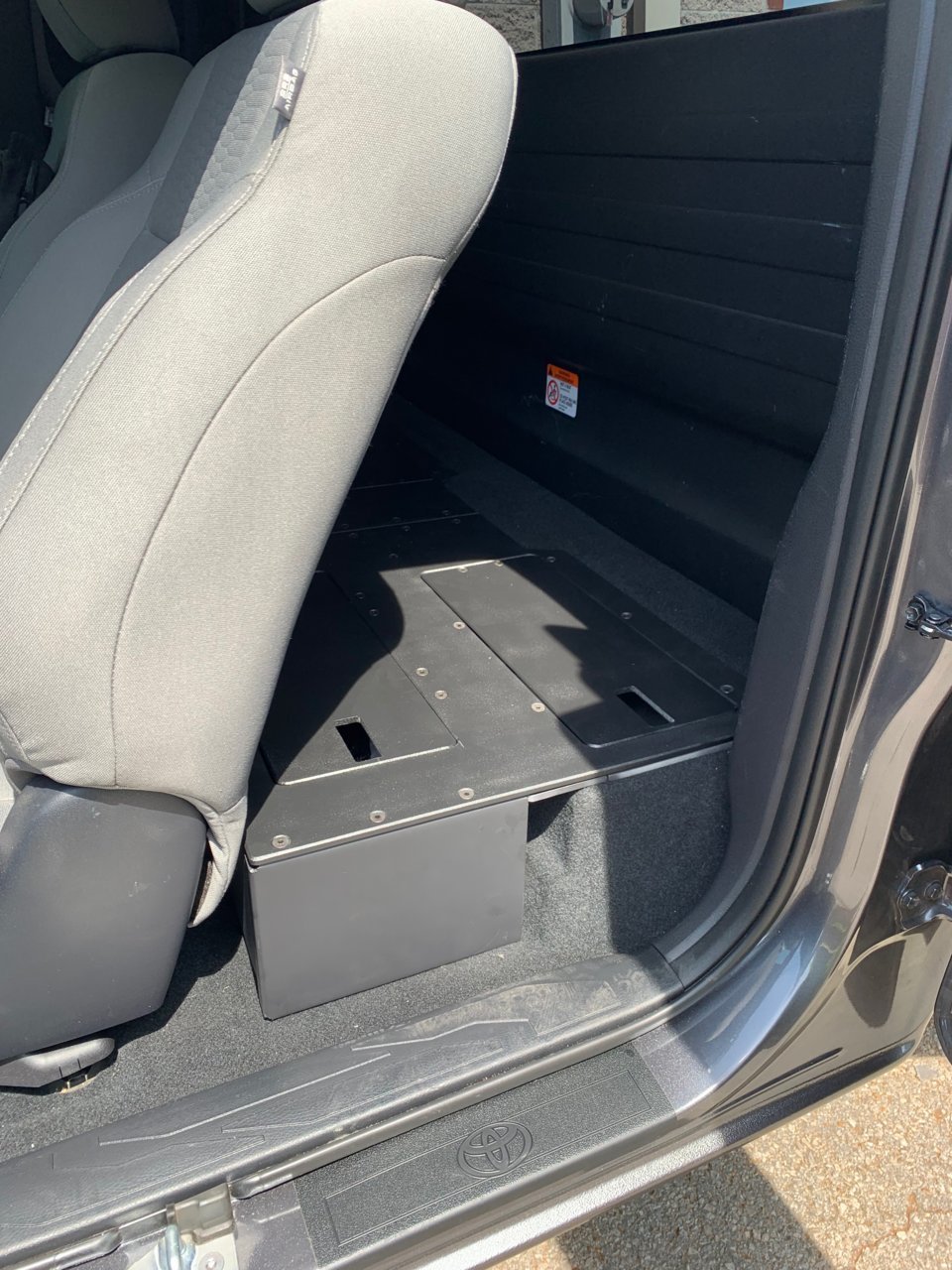

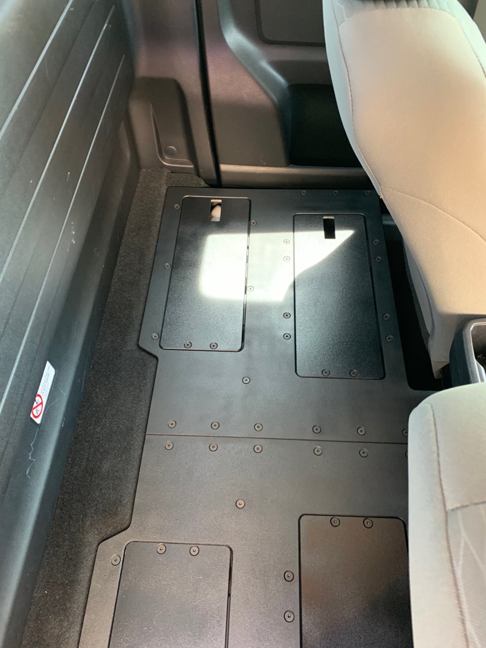

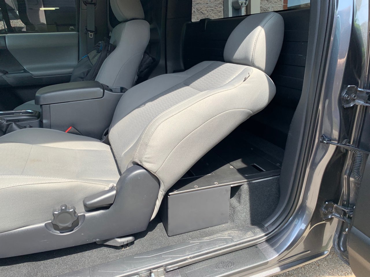

    Both seats can be extended all the way to the back of the seat rails, and seat backs reclined until they touch the rear wall of the cab.
