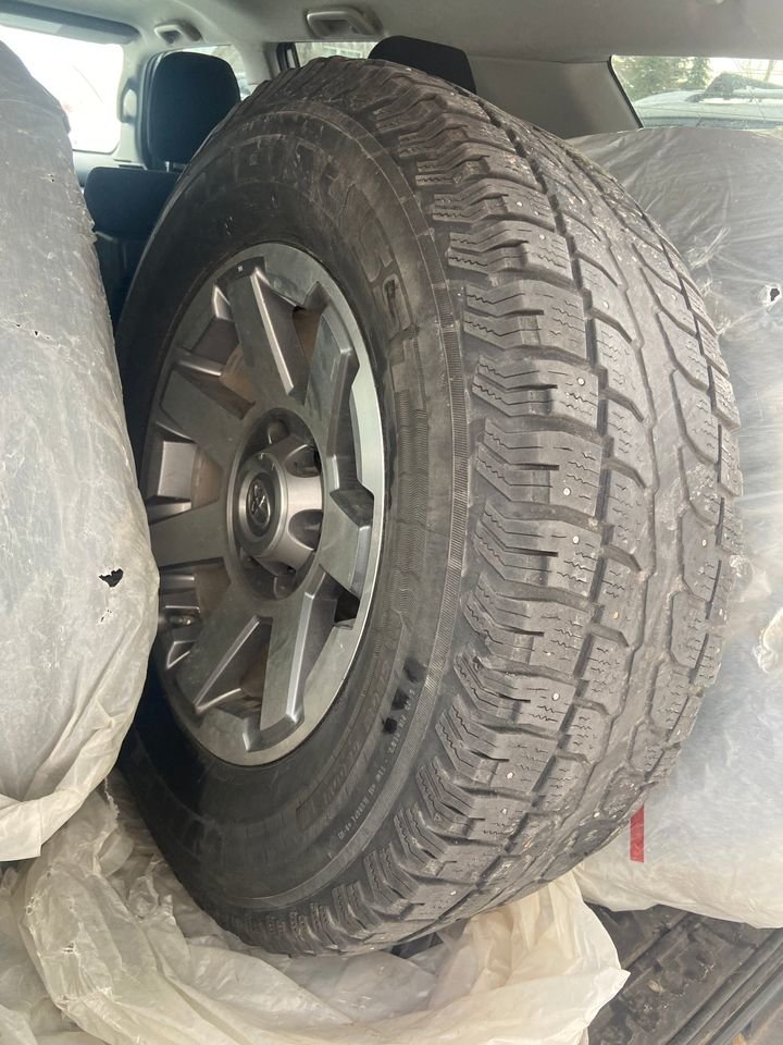

    Looking to buy snow tires - everywhere is sold out.
    I saw some 2016 4runner wheels with ok snow tires on them and was wondering if anyone has had issues installing 4runner wheels on their tacoma. I currently have steel wheels so I need to get new lugs but the new wheels come with pressure sensors. I'd just be running these in the winter.
    Pic of wheels below.

    I believe the 4R wheels will bolt right on with the proper lug nuts, look sharp too.
    Looks like the tire in the picture has been run overinflated, the center of the tread appears about gone. I would buy the wheels but not consider the tires to have much value.
    Run snows on your steelies and put the nice 4R wheels on for the summer with some white letter tires.
