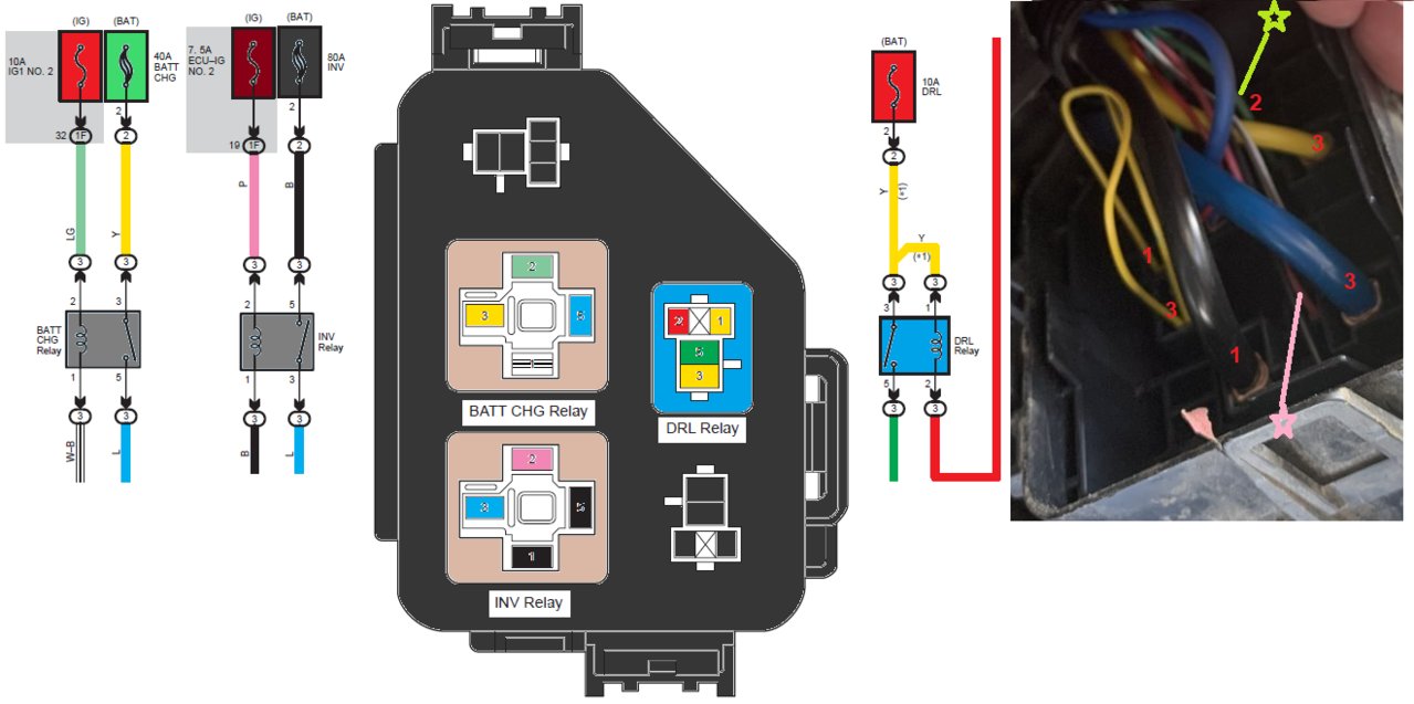

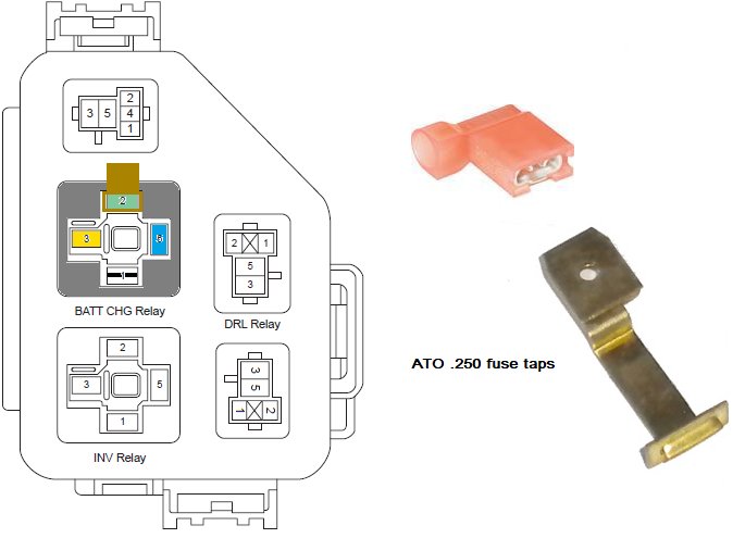

    The small relay box next to the main one has 2 IGN (Towing battery Charger / Inverter relay) source that could be tapped and hidden.

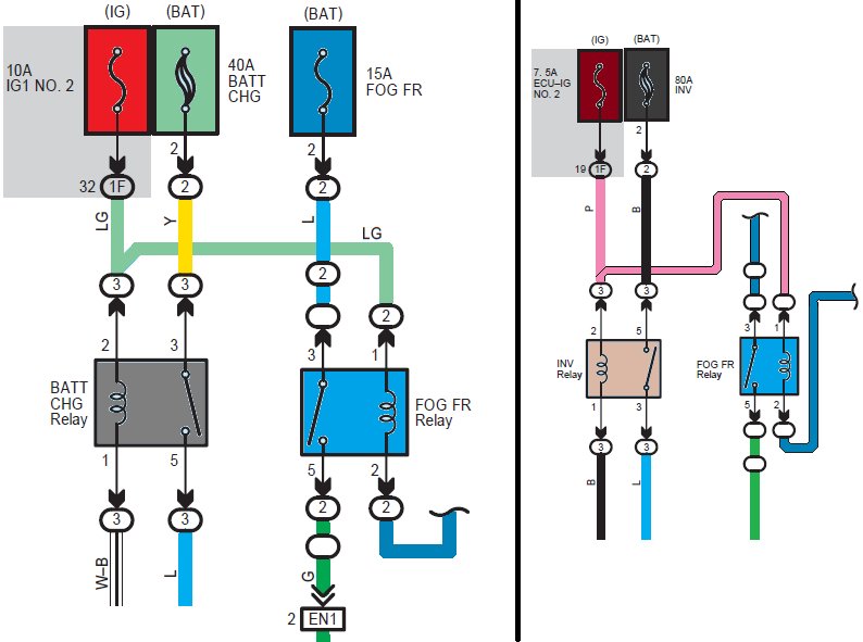

    I'm hoping someone can help me understand LED DRL function. I have '20 TRD Off Road with premium TRD package. Truck has halogen lights with LED DRL. The DRL appear to always be on, unless stalk is turned to DRL Off. In JBL radio Menu, Vehicle Customization, Lighting; there is an option to have DRL on or off. This seems to have no effect on the DRL's in my quick test. What am I missing about that setting? Owners Manual doesn't mention LED DRL.
    With the ultimate goal of Anytime Fogs and what I see from wiring diagrams posted on this thread:
    1. Does DRL also use ECM for ground?
    2. I'm also guessing this is through the Tail circuit ground?
    3. Would tying Fog relay ground to DRL relay ground esentially give you anytime fogs as long as headlights are on/auto and the truck is on?

    1. Yes
    2. No
    3. No
