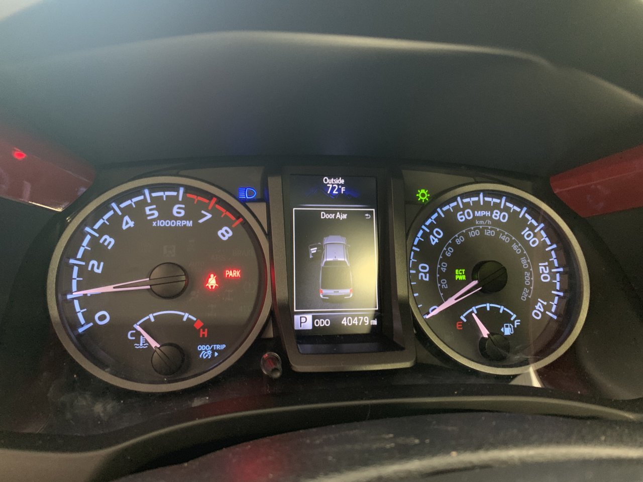

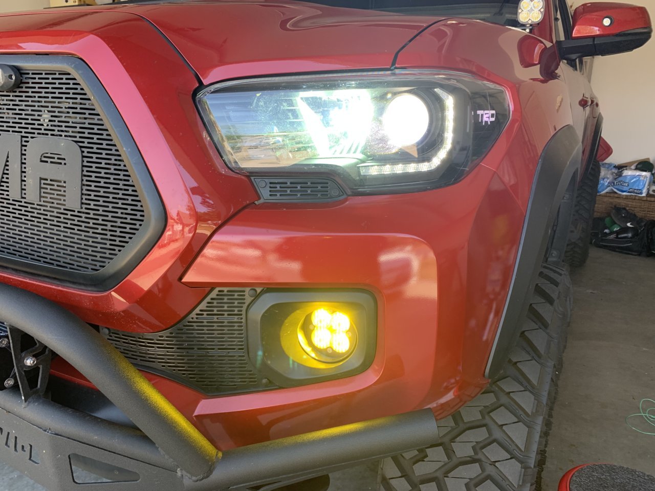

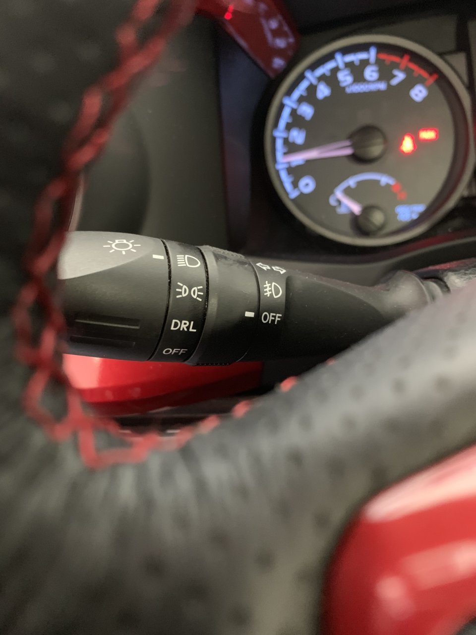

    I have a plug-n-play harness that allows me to operate my lights as normal and then when I switch to my high beams it also turns on my fog lights whether my fog lights are on or not. It also shows me that my fog lights are on as well so the indicator light is on with the high beams indicator light on the dash. I originally purchased the kit that @Victory used because I was going to do the same thing until I found this PNP Harness. The only thing it doesn’t allow me to do is turn the fog lights on with my lights off. Therefore, I am going to work on combining this PNP Harness and that one part of this mod and then I will be putting it all together and have it as one of my options if anyone is interested.

    Does your fog light indicator on your dash turn on when you hit the high beam switch and your high beams and fogs turn on?

    There is no easy way to get the fog indicator on the dash to function with high beams on unfortunately. It’s all communication bus stuff. If I were doing the modification, I would probably just use the factory switch to trigger the factory relay and skip the transistor and resistor. You won’t have the indicator on the dash at all but at least it’s consistent, haha.
    Only issue is that it is independent of the auto system, and so it would be possible to leave the fogs on when the truck is off. If you wanted to avoid that you can change the trigger wire on the fog relay to an ignition power source instead.
