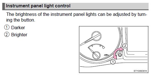

    Something else I noticed at the dealer the other day. I haven't bought the truck yet, so haven't had much chance to figure things out. But when you put the headlights on, it makes the instrument panel lights dim halfway. I want it to keep the same brightness as with out the headlights on. I know you can turn it up while the headlights are on, but it still doesn't seem to let you make it as bright as when the headlights are off. Any way to correct this?
    I believe other Toyotas have a similar thing where the instrument lights get dim when you put the headlights on and I hate that.

    Have you tried to turn up the brightness?

    Of course. But when the headlights were on, the max brightness was dimmer than the max brightness when they're off.

    Yes. Because the headlights being on is a signal to the dash lights that they should dim. The reasoning is that if the headlights are on, the outside conditions must be dark--dimming the dash lights is meant to reduce blinding the driver.
    But then we've also seen people driving in pitch-black conditions, and no lights whatsoever.

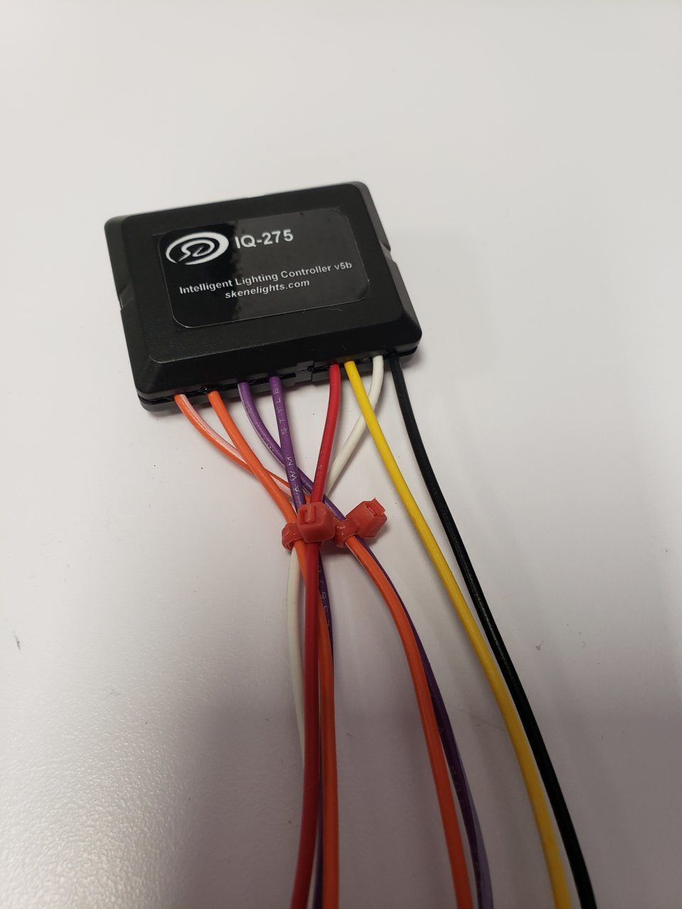

    So I was thinking of how I could use a switch for this application and came up with the idea of using an OEM style fog light button. Still the fogs will turn on with the normal switch on the steering column but connected to the yellow wire will be the OEM style switch like everyone uses for light bars ect. It will illuminate just like a regular switch but when you push it in "on" will be bright and out "off" will be dim setting. I wont have the middle setting but at leaste i can dim them on public roads... :D

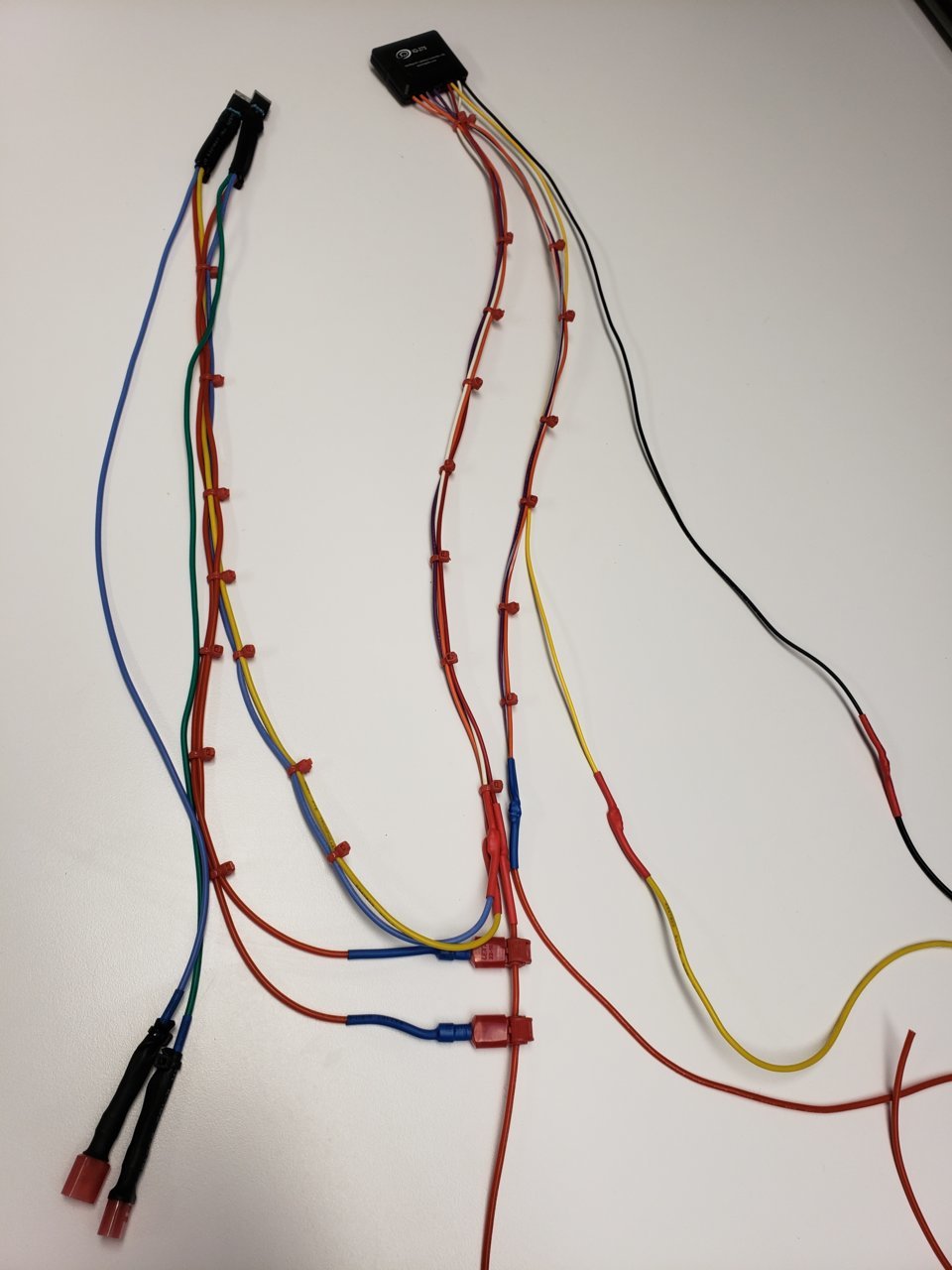

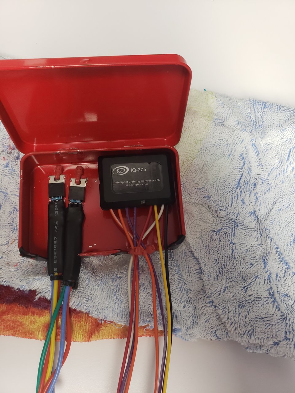

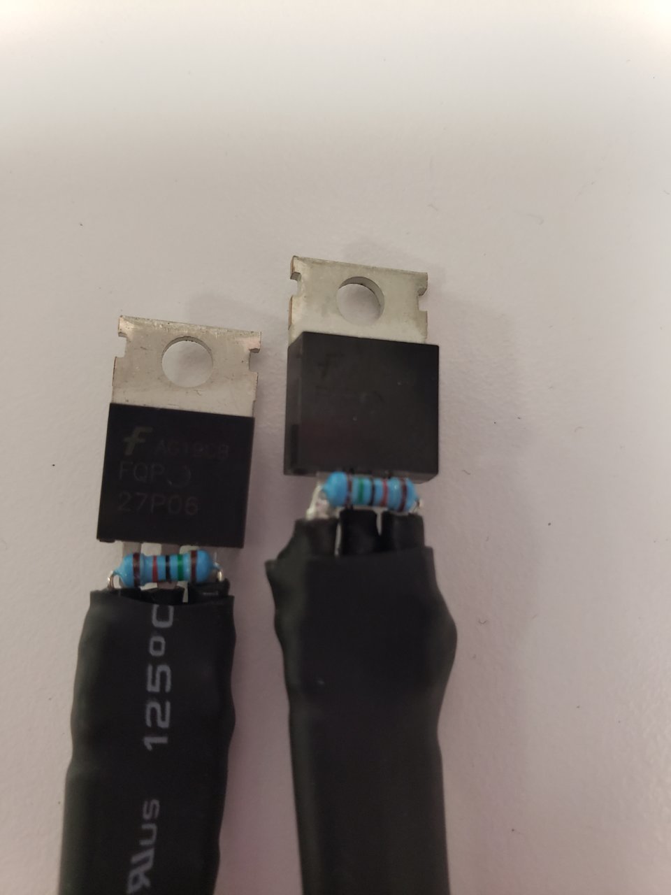

    So I started this today thanks to you @cdubray and @Reegsy for the pictures and the information. I have the wiring chip ready and waiting for the new fogs to come on Friday from @CaliRaisedLed and I am super excited to wire them up and the bumper light bar and ditch lights. Here is what I have done so far. I even made a little box for the IQ-275 and MOSFET chips.
    20200202_235843.jpg 20200202_235848.jpg 20200202_235858.jpg 20200203_020359.jpg

    Yeah I looked into that one and decided to go the route that I went for two reasons.
    The first reason is it's not illegal in Colorado to drive around with your fogs on.
    The second reason is I spent a lot of time on backroads for work sometimes on the night shift and its dark as F**K at night. This Chip gives me the ability to change how bright the fogs are and you can program the high medium and low setting to your liking of brightness. So for me when I am offroad I will have the high set to 100% brightness and when I get to public roads then I can switch it to a low setting and not blind any oncoming drivers. This chip gives me the added ability to still have them on when my high beams are on for added offroad visibility.
