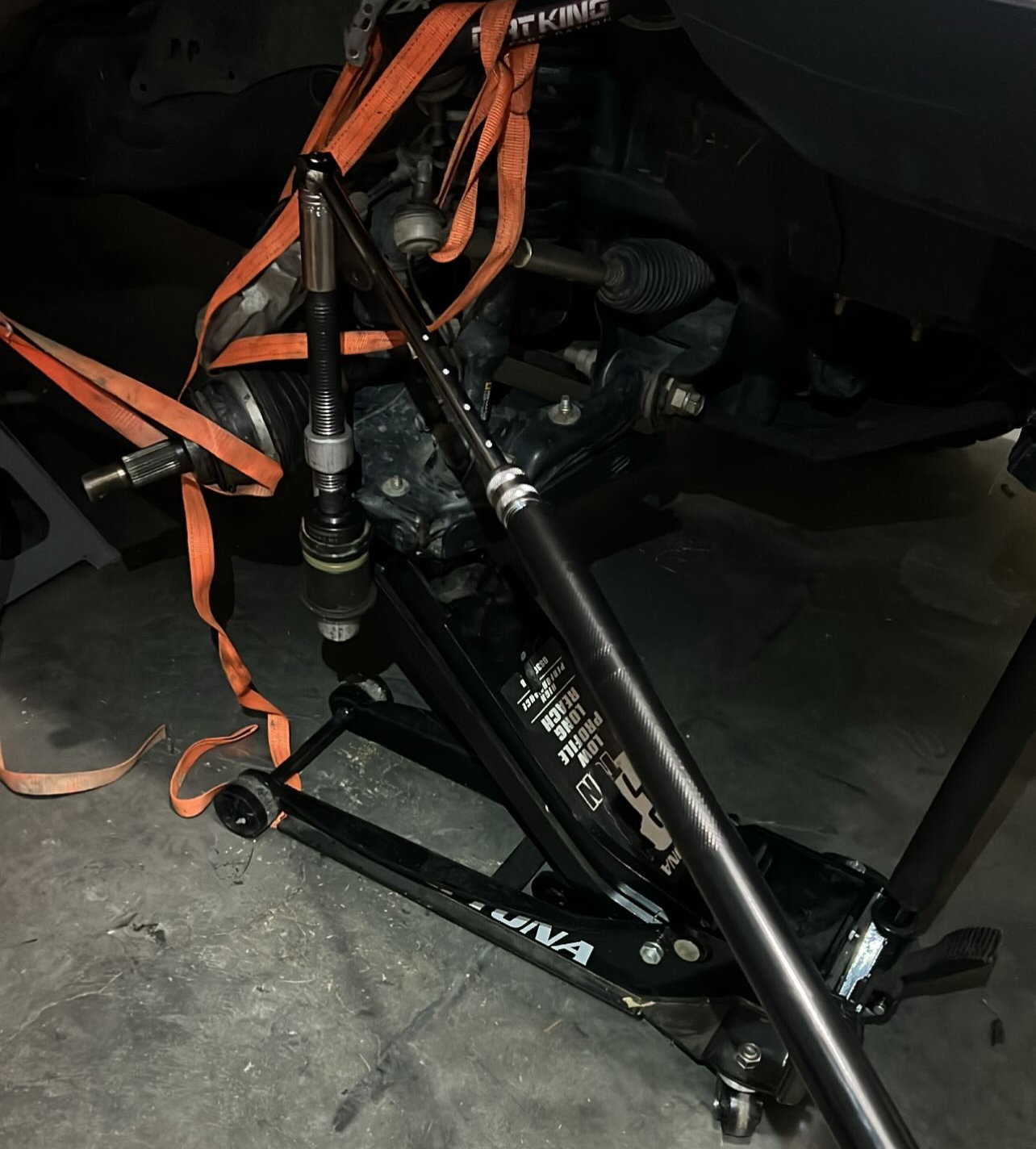

    18 Tacoma TRD off road OME BP51 front Fox 2.0 Resi rear OME Dakar Meduim Yoko G006 325/75r16 Black Rhino stadium wheels Cali raised ditch light brackets Baja Designs S1 pods Baja Designs Squadron SAE fogs Prinsu Cab rack TRD Pro grille AVS rain guards Backwoods adventure mods hi-lite bumper BL Apex 12k winch Dobinsons 4x4 snorkel Sy-clone prefilter ARB rear diff breather relocation RRW rock sliders RCI full skids At the helm bed stiffeners lil b LCA skids Warfab Phantom rear bumper Warfab tie rod sleeves C4 fender liners Dirt king UCA Duro bump stops
    I did it with a breaker bar and the rental kit from Advanced auto parts.
    No press and no heat. It was a giant pain in the ass. Don’t mind the ratchet strap I used to get everything out of the way :rofl:
