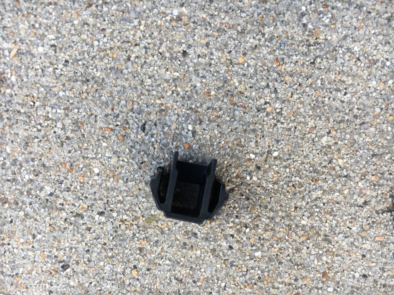

    I pulled really hard on the step portion of the bumper during my install, heard a pop sound, and discovered this on the ground. :confused:

    If you use a plastic bicycle tire lever you lift the edge up enough to put the shell on. I did it this way and it worked great. Hope this helps someone else.

    I did something similar, slid it on from the side and used a plastic pry tool to raise up the lip of the step to slide the tabs and cover edge under.

    That’s what happened to mine, broke one of those clips. I ended up using my interior plastic tools to just pry the lip of the other side and was able to get the cover on.

    I released those clips from underneath and pushed up to safely release them.
