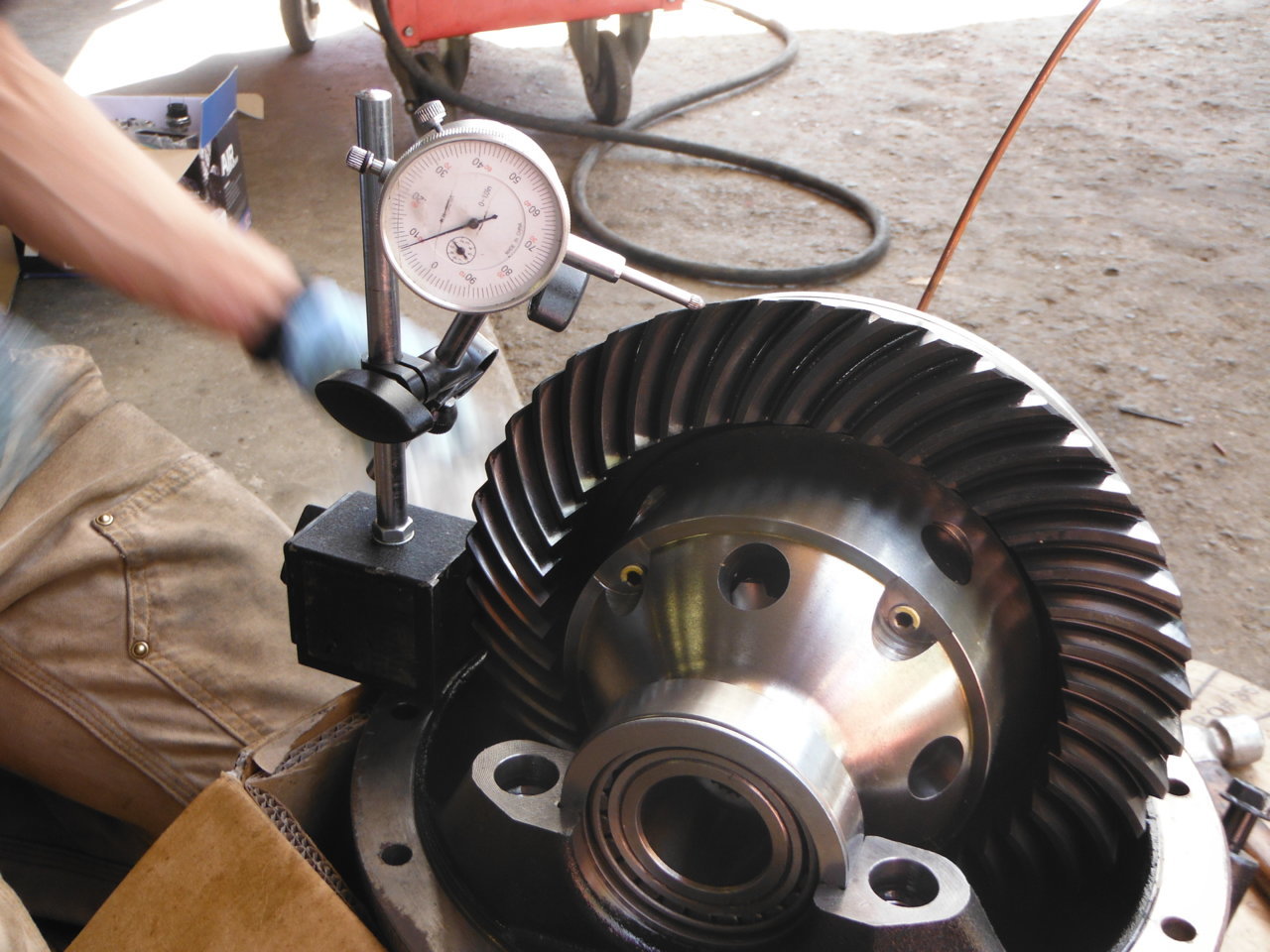

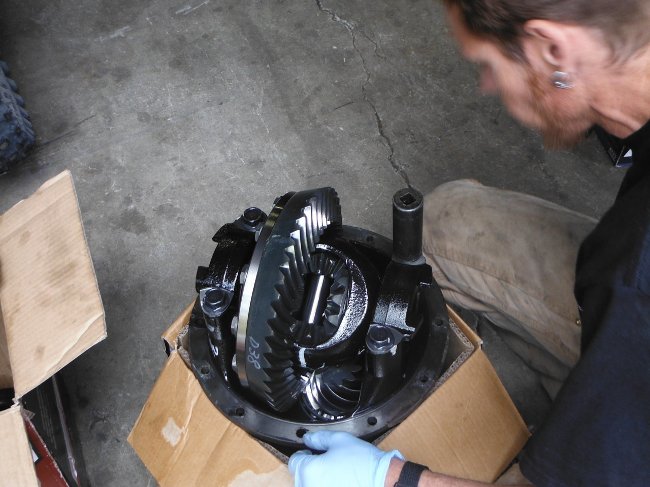

    You may not know about them, but there are significant differences between the Toyota and ARB differential cases (4 pinion VS 2 pinion among others):
    https://www.youtube.com/watch?v=dyzyAVPTM8c
    https://www.youtube.com/watch?v=E7VCCe9ZNYY

    It’s one of those things where saying something has 4 pinions, rather than 2 sounds stronger, but who knows if it is. Maybe 2 is stronger? I don’t know.
    My comment is mainly to illustrate the Toyota E-locker is robust and proven. Considering the number of them put in trucks every year, if they were a weak component we’d hear a lot more about it, and the ARB is far from troublefree with fellas having issues with that little pipe braking inside, frozen or leaking air lines, compressor trouble etc. It takes some doing to have a robust Air Locker system, though for sure it’s a possibility.
    Maybe it’s “6 of one / half a dozen of the other”.
