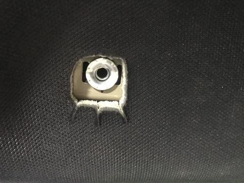

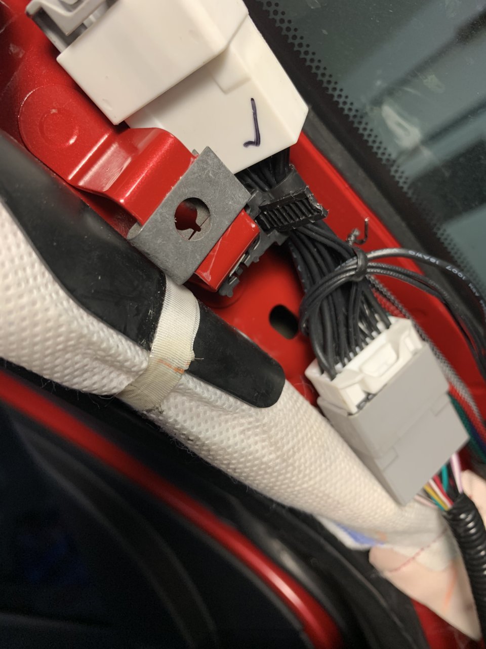

    Yes I saw that, but that doesn't really look like a permanent solution. Last thing you need is for that steel click on nut to be shaving away the pillar metal every time you grab your handle to support yourself in and out.

    Always a potential. I was more leaning to the Rivnut option that was also mentioned.
    ETA: Or, "super torque" the clip nut to insure it won't pivot, lol.

    Why do you think this will happen? The clip nut shouldn't rotate on the A-pillar flange once the bolt is tightened.

    I have used this type of clip nut a lot, they are very good for steady applications. I don't believe this is going to work for the grab handle as you are going to constantly be pulling on it daily, this clip nut is not designed for that purpose, otherwise Toyota would have included/manufacturer this type of clips on both driver/passenger pillars. This clip will be subjectable to open up with the constant pulling on the handle etc.

    I’m obviously not an engineer but when you tighten the bolt with these clip nuts as it turns the clip nut will rest against the edge of the bracket which I’d think keep any pivoting from happening. I guess you could even dab some blue thread locker to prevent any chance of loosening. I’d think if there were any chance of pulling out it would be the bracket bending. I guess I look at these clip nuts similar or not much different than using a nut/bolt (which I’d rather not use). I don’t think I’d like to use a riv nut either because of the potential for improper install or pullout or spin (there are certain riv nuts that would help those situations though) and it’s not like the bracket can just be replaced (I’m assuming) if something went wrong on install or failure down the road. These clip nuts on the other hand can easily be replace if it was needed. It’s not like we can get a nut welded to the bracket either… I’m just not sure of any other solution that would be dummy proof and easily replaceable

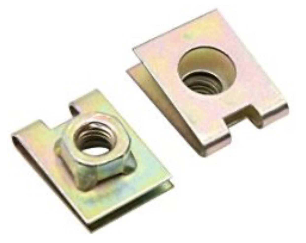

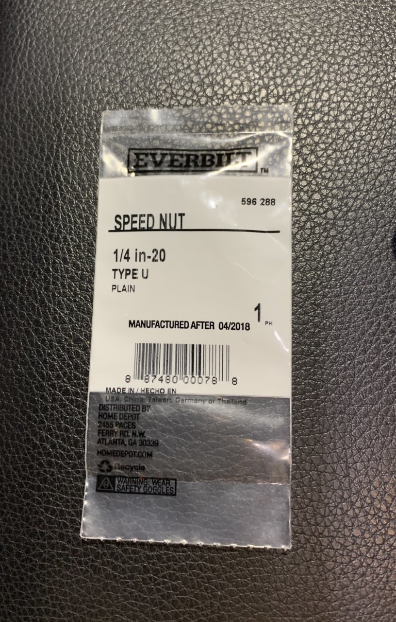

    Have to use the clip nut with actual threads on the backside. Not a Tinnerman nut.

    Like the one posted below for products discussed
