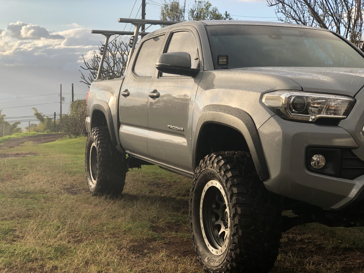

    2O+lgzgZS+CcGOr3GI7XVw.jpg borrowing only of my friends wheels to test the clearance on my 3'' front lift and 2'' rear and the 33x12.50 on some SCS 17x8.5 wheel and it has a pretty good amount of bumper and fender rub in the front but nothing in the rear even at full flex. but nothing an angle grinder can't fix!

    That's a good looking setup. I'd give him back the wheels, then replicate it.

    Thats my plan, just seeing how they fit!

    Looks good. What lift?

    What rack you running in the back? Truck looks shmean :thumbsup:

    Looks good, but goddam, unless you mount flairs you are going to need a putty knife to remove all the mud and dirt from the side of your truck if you actually take those mud tires offroad.

    thanks, I'm running Bilstein 5100s up front at about 3" and 2" blocks in the rear with Bilstein 5160s

    Thanks, Im just running a simple TracRack for now until I order up some CBI racks to go with a roof top tent

    I can say the easiest way we fit 34s is the 2" lift paired with a 1" body lift. Then the CMC and a little front bumper trimming. No rub at full tuck front or back!

    That wheel I believe is a -10 offset. Do you think you would rub the UCA if your wheel was an 18x9 0 offset running 33x12.50R18?

    I'm going with the same exact setup! Currently waiting on my Ray 10s and BFG KO2s to arrive.
    How much cutting did you have to do to fit the 33x12.50s? a cab mount chop + plastic trimming?
