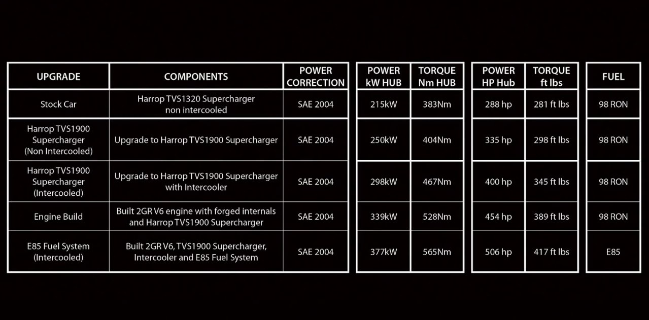

    Interesting video regarding comparing the Harrop TVS 1900 supercharger with various setups in the Lotus 2GR 3.5 L V6:
    https://www.youtube.com/watch?v=fsN56AD1rBs
    Looks like the TVS 1900 is not like your grandpa's old roots style SC and intercooling is the key factor to making good boost with these blowers. Will be interesting to see dyno #'s comparing Harrop to Magnuson
