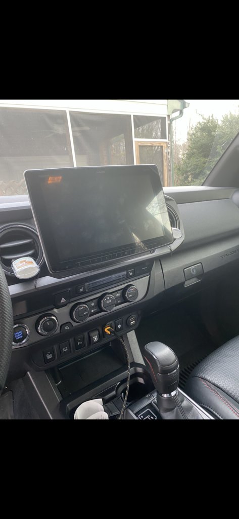

    I did the Alpine Halo 11 in my 19 TRD Pro not long after buying it due to the obvious lack of CarPlay. It was a little obnoxious but all in all I loved it, decided to do the CarPlay link wired for signal stability. It was fun every once in a while to cruise through and look at the onboard engine diagnostics. Only thing that I thought was kinda cheap was it didn’t utilize the factory mic. They had to put one up near the visor and it was just annoying to look at.
