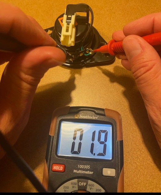

    2017_TACOMA_LIMITED
    2017_TACOMA_LIMITED Well-Known Member
    Sep 14, 2018
    #266228
    129
    2019 Pro/2017 Limited/2014 Limited
    The JBL speakers are 2 ohm as Destin said. I measured their resistance to confirm a few years ago when I pulled them out.
    4sorta2[QUOTED] likes this.
