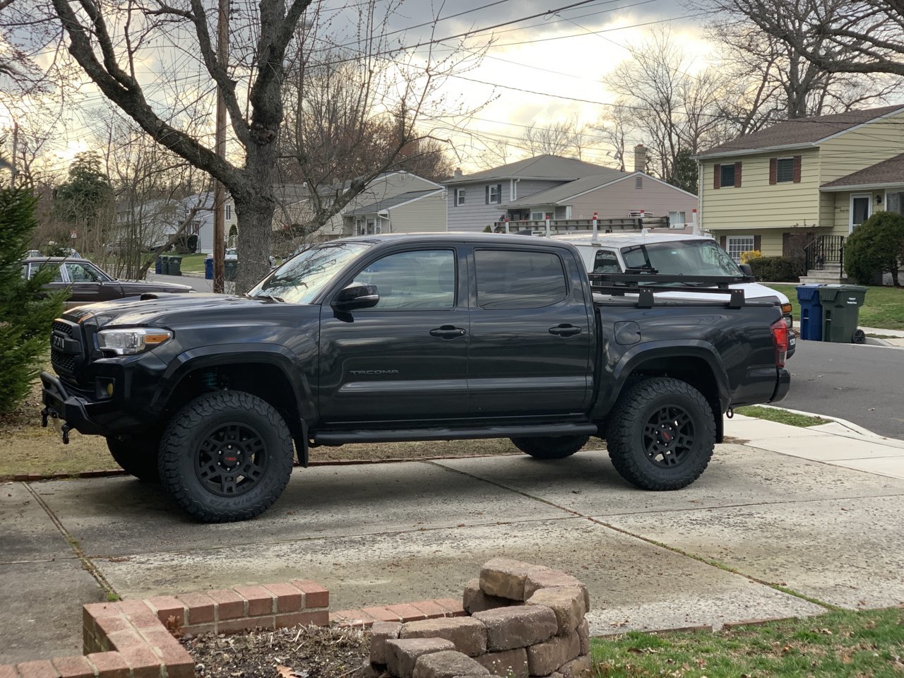

    3in lift, 5100s front and rear, OME 887 springs 2in aal, 285 75 16 Duratracs, mb 352 black wheels, white sport grill, derp'd lower valance, derp'd front toyota emblem white, tinted windows, tinted tail lights, trd shorty antenna, trd hitch cover, trd valve stem caps, trd neoprene covers, trd all weather floor mats, kenwood double din, stampede window visors, flyzeye interior leds, anytime fog light mod, flashlight mod, kool vue intake, LED dome light, Lund bug shield, TRD shift knob,front mud flaps removed, Debadged, truxedo roll up bed cover, led fog light bulbs, led parking light bulbs, led dtrls bulbs, led headlight bulbs, led back up light bulbs, led license plate bulbs, tinted license plate covers, 18" magnaflow muffler, 32in ebay, light bar, coverking neoprene resr seat cover, oem trd skid plate, trd decal on center caps, oem trd exhaust tip, blacked out pinch welds, color matched mirror covers.
    OME lift 285 75 16 and 0 offset..is what I’d do on your truck.
    here’s a truck I just built for a friend. He went with a spacer lift 2.5” up front 1” rear tho for now. 285-70-17s and 0 offset raceline wheels

    Didn’t used OME kit on it it’s just a spacer lift 2.5/1 but if it was me I’d go OME for the money it’s great
