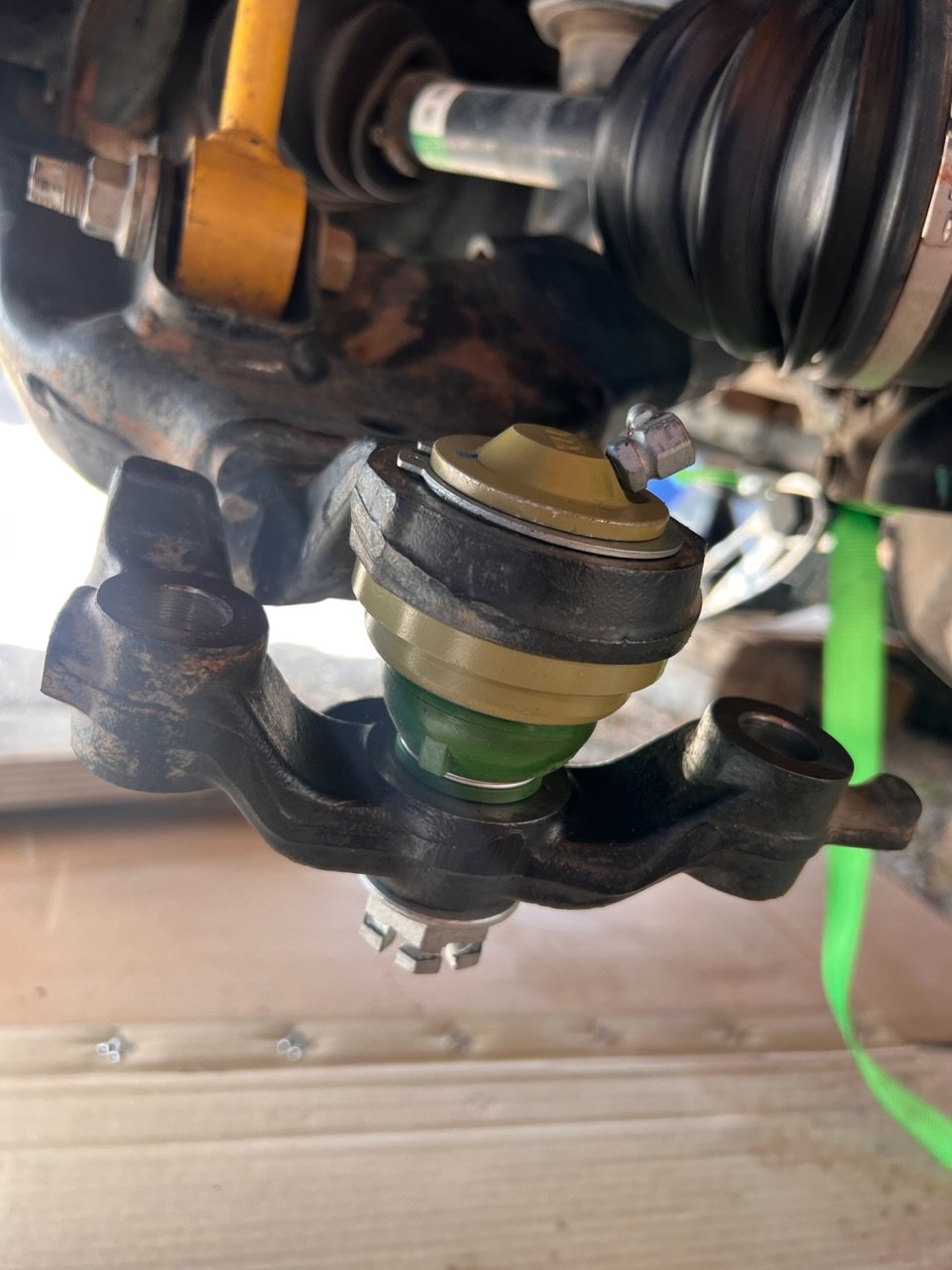

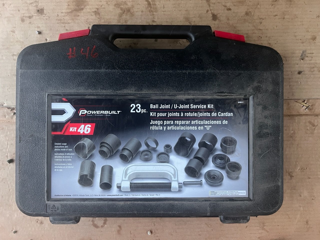

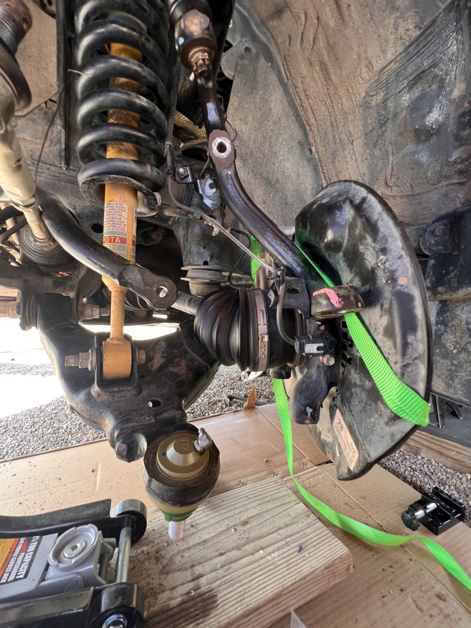

    2019 Tacoma off road at 92K. I managed to change out the lower one with this ball joint press kit from Advanced Auto Parts (non of the kits from O’Reilly, NAPA or Autozone had the right cups). I’m no mechanic. The most extensive thing I’ve ever done is change my spark plugs. Pressing it out was a pain. My impact gave up a couple times. The joint started coming out uneven and started biding. I encouraged it with a hammer, beating on the top high side and tapping around the knuckle until it straightened. Once I got it back on track the press and impact eventually got it out. Getting it in was fairly simple. My only regret is not getting the non-serviceable joint. Hopefully greasing these wont become a pain. Also, I probably could have lined up the grease fitting in a more appropriate spot.
