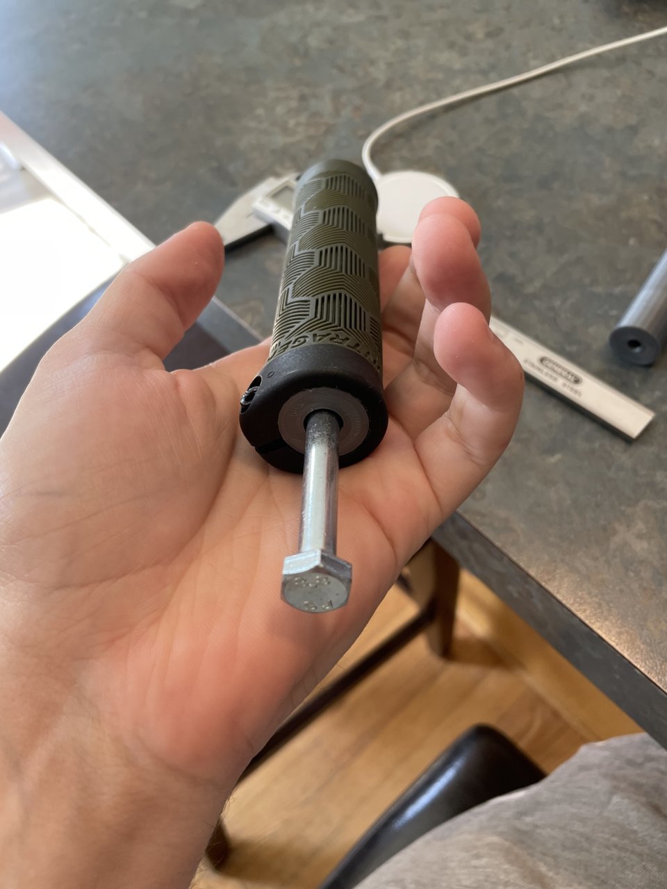

    I have seen the GoGettaGrip shift knob but I didn't like how much the thing costs and it doesn't even let you use your own grip. I designed and 3D printed my own shift knob adapter that just screws onto the shifter post and allows you to put any mountain bike grip (22mm bar size is standard) on it. If anyone is interested in the files, I can post them for yall to use. For tacomas the only thing you have to get is a shifter boot trim cover which are on Amazon and etsy (link below). You can hold the boot up by placing a zip tie on the shifter bar under the boot.
    *Bolt to show how shift bar threads into the adapter.
    *Bike grip clamps down on the adapter just like it would on your bike.

    I am working on one for the manual transmission. I just finished one for 4Runners with automatic transmissions. The treading is a different size for manuals but I should be able to do it. When i figure it out I will reply again to let you know where its posted.

    I used ABS plastic to print them and I slightly undersized the threads so they are a little tight. So far they seem very solid. Also since they are ABS they should have no problem standing up to the heat of the inside of a car in the summer.
