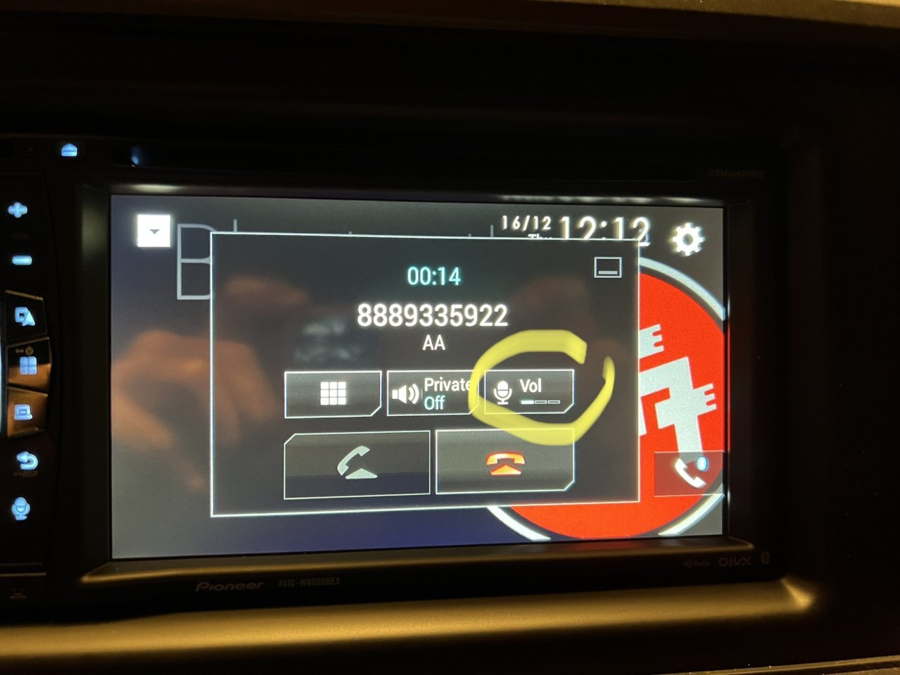

    I might have found a remedy in Bluetooth settings. (I’ve only tried this with iPhone 13 PRO and Puoneer AVIC NEX head unit).
    First, don’t connect to CarPlay, so turn of your iPhones wifi if you have wireless CarPlay. So it won’t connect automatically.
    Second, make a call.
    While on a Bluetooth call, a mic VOL icon should appear in you head units screen.
    That mic vol icon is for the other lines/persons volume output/sensitivity. This icon settings will not appear if your connected thru CarPlay.
    Then, Turn it to the lowest setting. (Head units may vary) mine has three levels. And the lowest one produced the cleanest transmission (According to the other line). Hope this helps anyone.
    Update:
    It seems that this only worked for me on Bluetooth calls. I tried calling via CarPlay and the problem persisted.
    WickedAx[OP] likes this.
